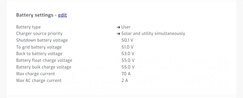

Hi Jaxone, depends on a lot of variables and maybe we don't have all the information on your problem. There is a reason the inverter won't go back to SBU mode. One such reason is because it depends on the back to battery discharge setting on the menu of the inverter. If the battery voltage is not above this threshold, the SBU mode will not activate. After the X amount of time, compare the battery voltage to the setting and you might find this to be an issue.
Posted
The batteries are 100% charged and Solar Assist is seeing them as fully charged also.
If I manually switch to SBU it will switch without a problem.
