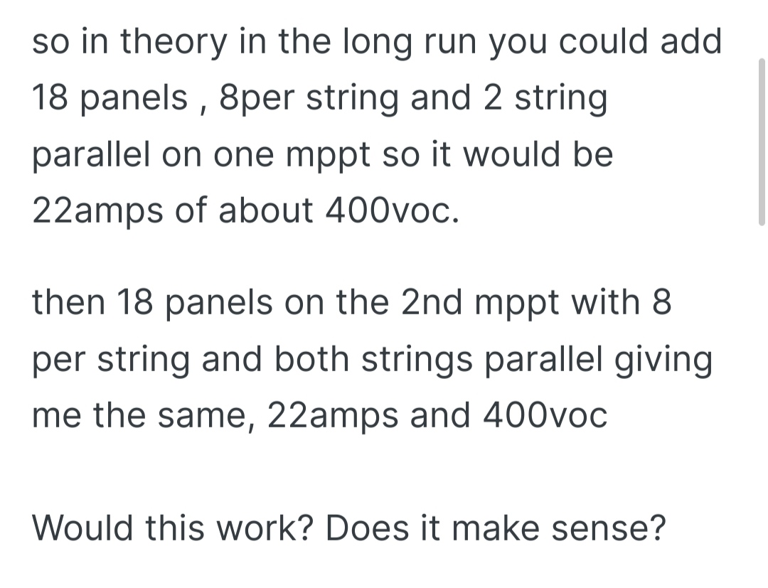

20 minutes ago, Derek Ramos said:
so in theory in the long run you could add 18 panels , 8per string and 2 string parallel on one mppt so it would be 22amps of about 400voc.
then 18 panels on the 2nd mppt with 8 per string and both strings parallel giving me the same, 22amps and 400voc
is the idea to have 2 and 2 spare panels? one spare panel per string? 🙂

The idea is to have 36 panels (not now but maybe future)
mppt1- 2 strings of 8 panels each connected in parallel. (16 total panels) a little over 400v and 22amps
mppt2- 2 strings of 8 panels each connected in parallel. ( 16 total panels) a little over 400v and 22amps.
for now I just want to get 16 panels, 8 panels in series on one string on one mppt and the same for the 2nd mppt.
the question I’m asking is that in future could 36 panels work the way I’ve said above and would it be beneficial to get 470watt panels instead of 545watt for future expansion.
