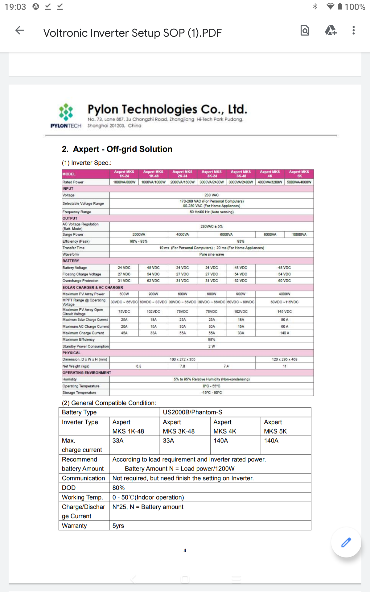

Have this same Axpert inverter connected with 3 Pylontech U3000 batteries. The Pylontech/Voltronic SOP gives Al the settings to connect. I have registered for the 10 year guarantee with photos and it was accepted.
