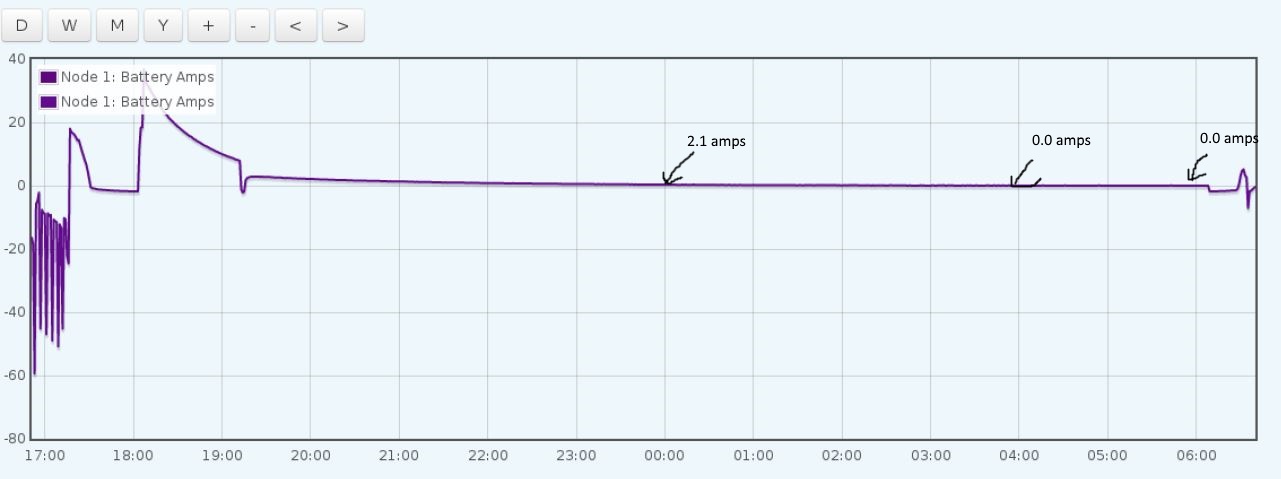

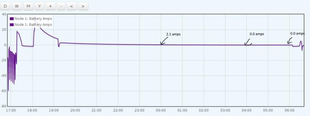

7 minutes ago, Don said:
Victron assumes I sit with batteries that will require at least 2.5 amps when fully charged.
I've never really thought of this. Lithium batteries also charge right down to almost zero (very little current) and I know the BMV is used with the lower-end 12.8V batteries (not the higher end 24V ones that use the Lynx BMS). It would be odd to think they don't work as intended. Oh well... I generally prefer it if it gets there without syncing.
I would prefer it if the BMV had settings for it it to go all the way to 100%, without taking a 4% leap in the process. Unfortunately the settings does not allow that.
22 minutes ago, Don said:
Well Victron got it wrong, my batteries can go down to 0 amps
@Don just out of pure curiosity when you say your batts goes to 0 amps. Does this mean that your batts can not accept any more amps when charged or the bmv showing 0 amp , other words no amps going in or out of the batts?
Yeah that's a little strange to me too. A lead acid will always accept some charge (even if milliamps) if you take it up to float voltage. Float-voltage is a "gassing" voltage, tiny bits of electrolyte is converted to hydrogen (and turned back into water in most sealed bats)... that is to say almost the entire float process after 100% SoC is simply wasted energy... but it is there.
Lithium is different, those really do go down to almost zero.
The charging amps go down to 0 amps. If you put one more amp into them, they would puke I think.:)
LOL all that acid ,, eish.

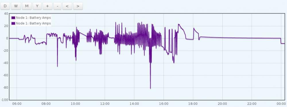

Looking at your graph do you charge the batts with the grid as well? I notice that the batts drop form almost 40a to 2a between 18hoo and 19hoo . Then there is no negative amps. So I can only assume that your batts is in flout all the time?
This is a normal day for my batteries. They start working hard from about 8h30. My lowest SOC is just before the sun sets. I don't get to fully charge them with solar power, they work to hard. Their resting time is when the sun sets. I basically only charge them on grid. Then they cruise along from 23h00 or 24h00  until the next day, then I hammer them again.
Here is another example. My batteries goes above 100 amps at least twice a day. Depending what I am busy doing, for the last week I have been welding and spraying with a large compressor, the inverters would go to grid 2-3 times a day because of excessive amps drawn from my batteries or excessive load when the compressor stars up. They charge for 5 hours, then they are ready for action again. At 21h00, my batteries are sitting below 1.0 amps
My batteries were lying in a box for a year before I started using them. When I started logging my Charge efficiency in December 2016, they were siting at 90.5%. My batteries are improving daily, currently my charge efficiency is around about 91.4% and my Battery Midpoint = 0.01%.
