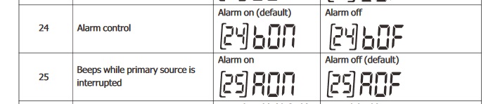

Here's a picture of my display. Not too much to see here I guess? In the manual it shows there should be a speaker icon on the display if alarms are muted, but I don't see it. In the manual I can find two settings related to alarm and I set them both to off. No other information in the manual about how to mute these alarms.
I think the alarms are given when perhaps there's no power generated by the panels or when power is being generated again. This based on the fact that beeps always seem to happen around sunup / sundown, but they do happen during the day as well. Since our house was constructed without these panels / inverter in mind unfortunately the inverter is places in a spot where the beeps are a real annoyance.

The speaker icon could be in the display but not used. Yes 24 and 25 should switch the beeps off if working correctly. You might have a notify beep when the PV kicks in and out.
The beep could also be as above if you have your earlier setting to use solar 1st. Then it will alert when PV does not provide power at sunset and informing it's back on in the morning.
Do you use the inverter to keep power on at all times or only during interruptions?

It sounds like the setting is not being saved when you are turning off the alarm because the icon is not showing up on screen, just be sure to press enter after changing the value and then wait a bit for the system to return to the main screen for it to be saved. Then go back to setting 24 & 25 and check if they are indeed changed and saved.
