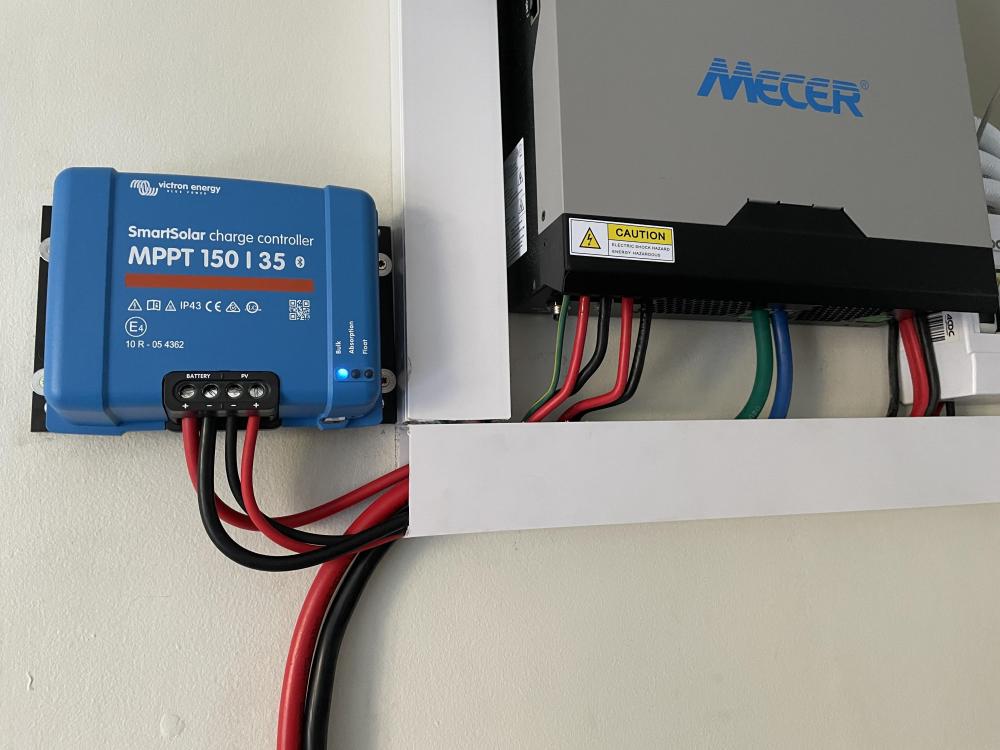

I have a Axpert inverter of which I do not use the internal MPPT?
I have installed a Victron SmartSolar MPPT 150/85-Tr VE.Can Solar Charge Controller which I can only see via the bluetooth app.

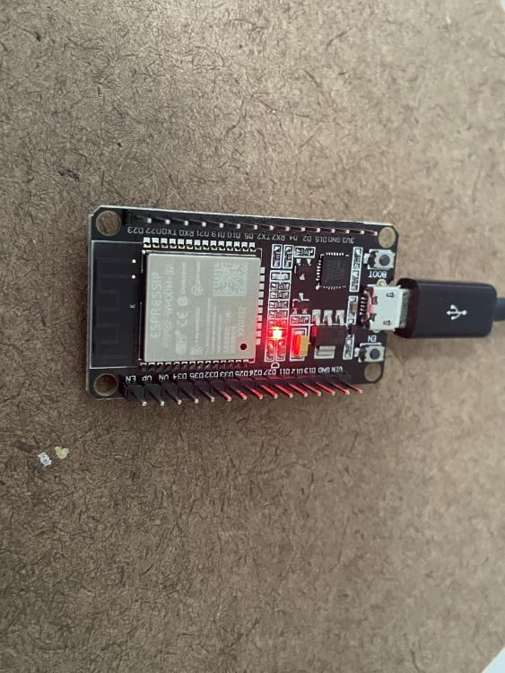

[20:20:50][D][sensor:092]: 'Current': Sending state -0.65300 A with 3 decimals of accuracy
[20:20:50][D][sensor:092]: 'Consumed Ah': Sending state -58.50000 Ah with 1 decimals of accuracy
[20:20:50][D][sensor:092]: 'State of charge': Sending state 71.80000 % with 1 decimals of accuracy
[20:21:57][D][sensor:092]: 'Battery Voltage': Sending state 26.26000 V with 2 decimals of accuracy
[20:21:57][D][sensor:094]: 'Yield Today': Sending state 3.19000 kWh with 2 decimals of accuracy
[20:21:57][D][sensor:094]: 'PV Power': Sending state 0.00000 W with 0 decimals of accuracy

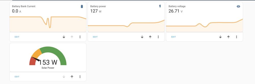

Weirdly, I can push to Solar Assistant's MQTT broker. But Solar Assistant is not proving a way to "fetch" the data and use it. However I can fetch it with Home Assistant from Solar Assistant.
Odd, they must just enable the topics sub, then this can actually work.
Victron MPPT and Shunt -> Bluetooth -> ESP32 -> MQTT -> Solar Assistant -> MQTT -> Home Assistant.
This means the data is available for fetching via Solar Assistant if their devs enable it.
