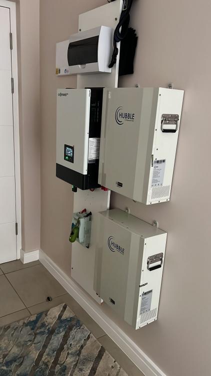

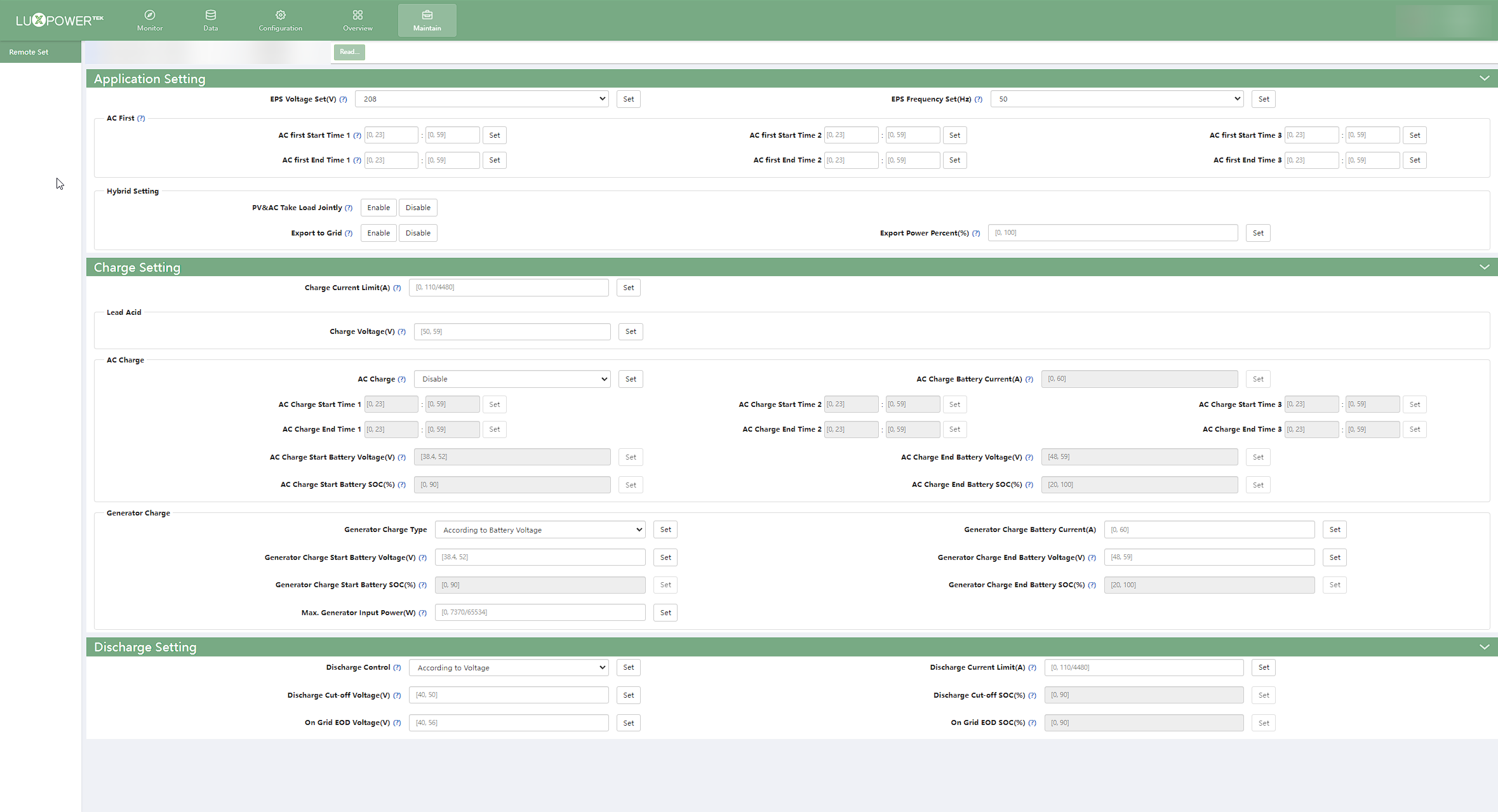

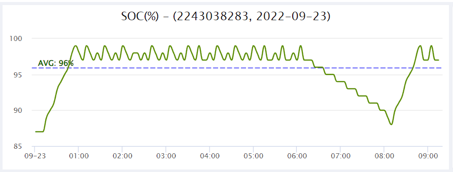

September 23, 20223 yr Hello, So I recently got a setup consisting of the LuxPower SNA5000 and two additional Hubble AM2 batteries. The installer was really great and they modified my existing Gel Battery and Apert Inverter to this new setup (see image). I just needed some help with this setup and I had a few questions for those with similar setups please. I see on my LuxPower our Lithium setup is limited to 100ah, shouldnt this be 200ah with these two batteries? So I was just basically going over all the settings and making sure things are fine after spending some time reading this forum here. Second to that, I cannot get/find what I need to do to get the LuxPower to feed from Grid, Charge the batteries and basically wait for load shedding to kick in. Whats currently happening now is the Lux is charging the batteries to 99%, Grid feed is turning off and then again charging the batteries and in that repeat cycle? Is this correct? Some guidance and help would really be great! Thank you!

December 29, 20223 yr On 2022/09/24 at 2:47 AM, Soprono said: Okey found the silly setting I missed We have also a Luxpower SNA 5000 and one Hubble AM2 battery. Can someone post a screenshot of the best settings via the web? Our inverter restarts after a certain time during loadshedding when TV is on since the last few days. The initial setup was working for the first 3 months.
