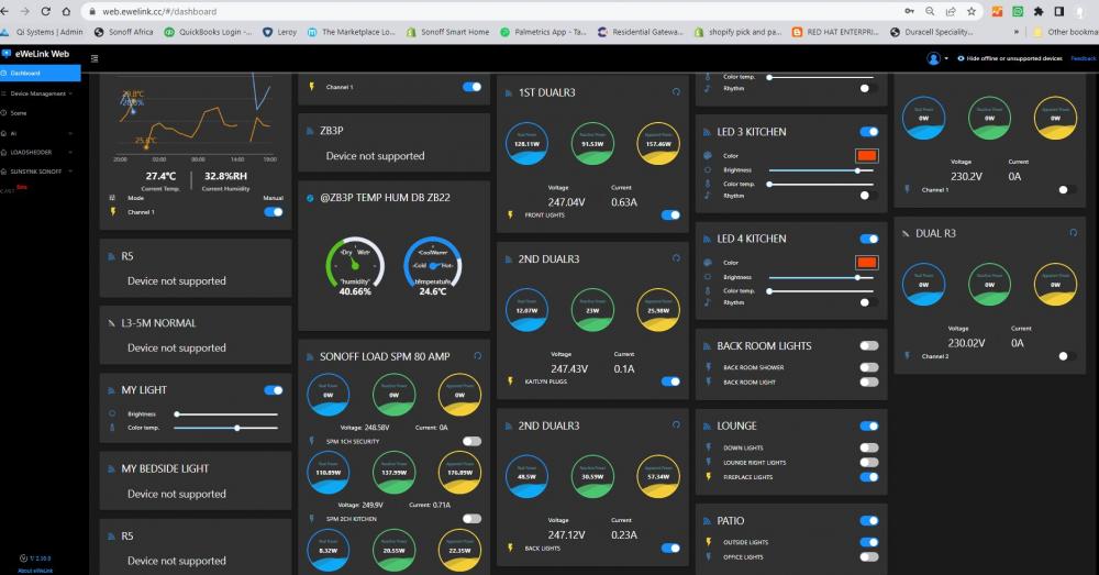

Sonoff's first move in that direction is the Smart Stackable Power Meter "SPM". I have attached a link to their site below. The biggest challenge is that the eWelink platform does not offer that amount of user administration and permissions level’s yet. The 4 relay module assuming one per unit closed off in its own DB would be close, i.e 1st channel lights and critical loads like internet. 2nd channel Kitchen plugs i.e. coffee machine, microwave kettle. 3rd channel washing machine, tumbled dryers, irons. 4th channel geyser or none critical loads. They can be split in any preferences that suit the lifestyle. You could also add to that by subdividing below the SPM into individual circuits on sonoff dual R3 or POW units. That would give more control.
In saying all that would I feel comfortable with the solution or recommend it at this scale and manage it from ewelink not yet. It's close and it will get there. Home Assistant also ewelink VIP web interface is defiantly making go head way.
The ewelink cast is defiantly getting very close, where you can create individual dash boards per unit and pin protect them then just change the pin and lock the dash board.

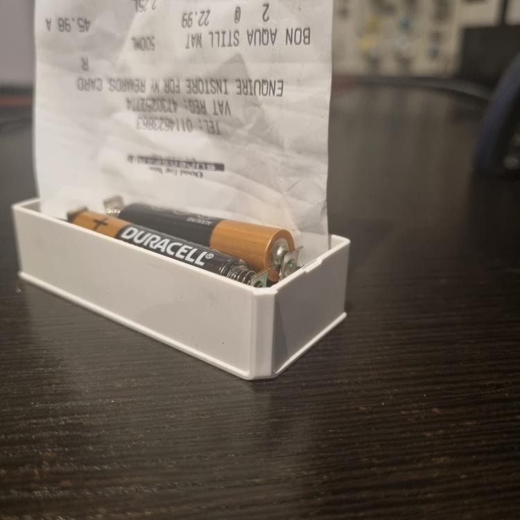

Have been using the DW2 wifi ones and you are correct - a few weeks and time to pop in a new battery. They are all close to an AP so range-anxiety is not an issue.
There is also a trick to putting the batteries in and it should not have to be this way and we have reported it to the manufactures a few time and still are.
There are 2 versions of the DW2-Wifi and one was with a MN27 and the other is with 2xAAA in both cases the edges of the battery holder are not been bevelled enough and is quiet sharp and that sometimes depending on the battery manufacture cuts through the battery coating enough to short it. I defiantly recommend the Duracell batteries and when inserting the battery you can use recipe any from your wallet, insert small piece between edge and battery only on the side and then push in the second battery. Again it should not have to be this way.
