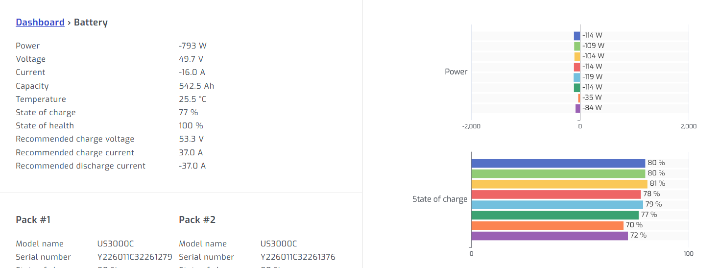

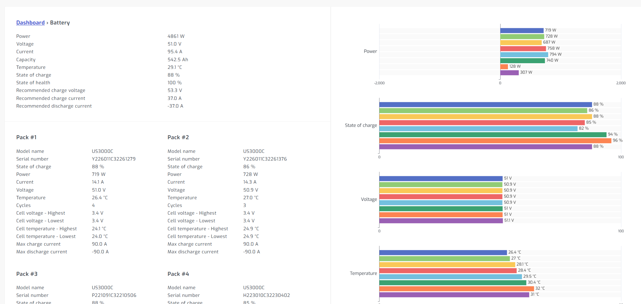

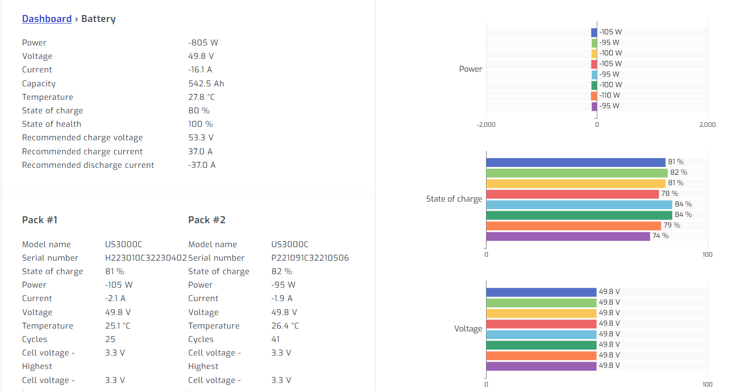

All good , all ok but I noticed one thing (this could be normal behavior as last 2 pylons are only 2.4kw model) , when discharging or charging they will never charge or discharge equally.
Not even the US3000C will have "equal" (or almost equal) level of charge discharge.
Normal or I am being paranoid again ?
First 6 packs are US3000C , last 2 are the US20000
This is in the afternoon when I start discharging , in the morning the diference is bigger.... like one US3000C is at 50% , one at 45 , one at 40 ... randomly , not in a certain order.
I cant quite tell properly, but from what you say, it looks as if the order of your batteries may be incorrect which may cause problems. You should be sandwiching the older batteries.
There can be a difference in the SOC and it will sort itself out when you charge the stack full again.
At least that is what happens on my Stack.

Curious how will look in the morning when they will discharge whole night.
I see a similar thing on my stack of 5x US3000 (mix of B and C and different ages). I think it has something to do with battery age (cell health). All of your batteries are at the same voltage, but report different SOC for that voltage
After I swapped some of them around , things started to look better. At least the US3000 are closer to each other.
