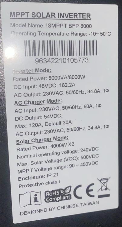

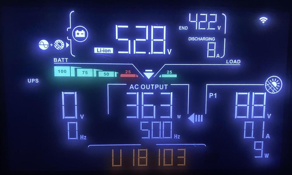

Hello friends, greetings from Ukraina!
I have an inverter Axioma ISMPPT BFP 8000and i also have trouble sleeping on 90 volts.
Can you tell me which firmware is suitable for my inverter.
Here are pictures of a model and the software it currently has.
Thanks!
The only patched firmware for your model is at present version 281.05. This is a 200 V minimum MPPT version, so DO NOT use this if you have panels that routinely operate best below 200 V. I note that your display photo shows PV1  voltage as 88 V, suggesting that you have few panels on that MPPT. I would not use the 200 V patched firmware with fewer than 6 panels (assuming 72-cell panels, but high wattage panels these days probably have many more cells than that). Your Voc (panel voltage with normal sun and no load) should be at least 260 V.
If you have a lower Voc than that and adding panels is not practical, let me know what panels you have and I may be able to produce a lower voltage patch.
The photo was taken in the evening, so the voltage is 88V. I have two strings of 9 panels of 48V each, so during the day the voltage of the string is more than 360-380V. Here is a photo from this morning.
Edited by Sanyas15
Hello friends, greetings from Ukraine!
I have an Axioma ISMPPT BFP 8000 inverter. I know that the component base is similar to MPPT Solar, Altek, Qpawer, and I have a question, is it possible to reflash it with firmware to the 11 kilowatt version? I looked at the reviews, the power elements of 8 and 11 kilowatts match. Maybe someone has already done this upgrade?
Can you tell me which firmware is suitable for my inverter. I would be very grateful if someone gives a detailed comment.
Here are photos of the model and the software that it currently has.
