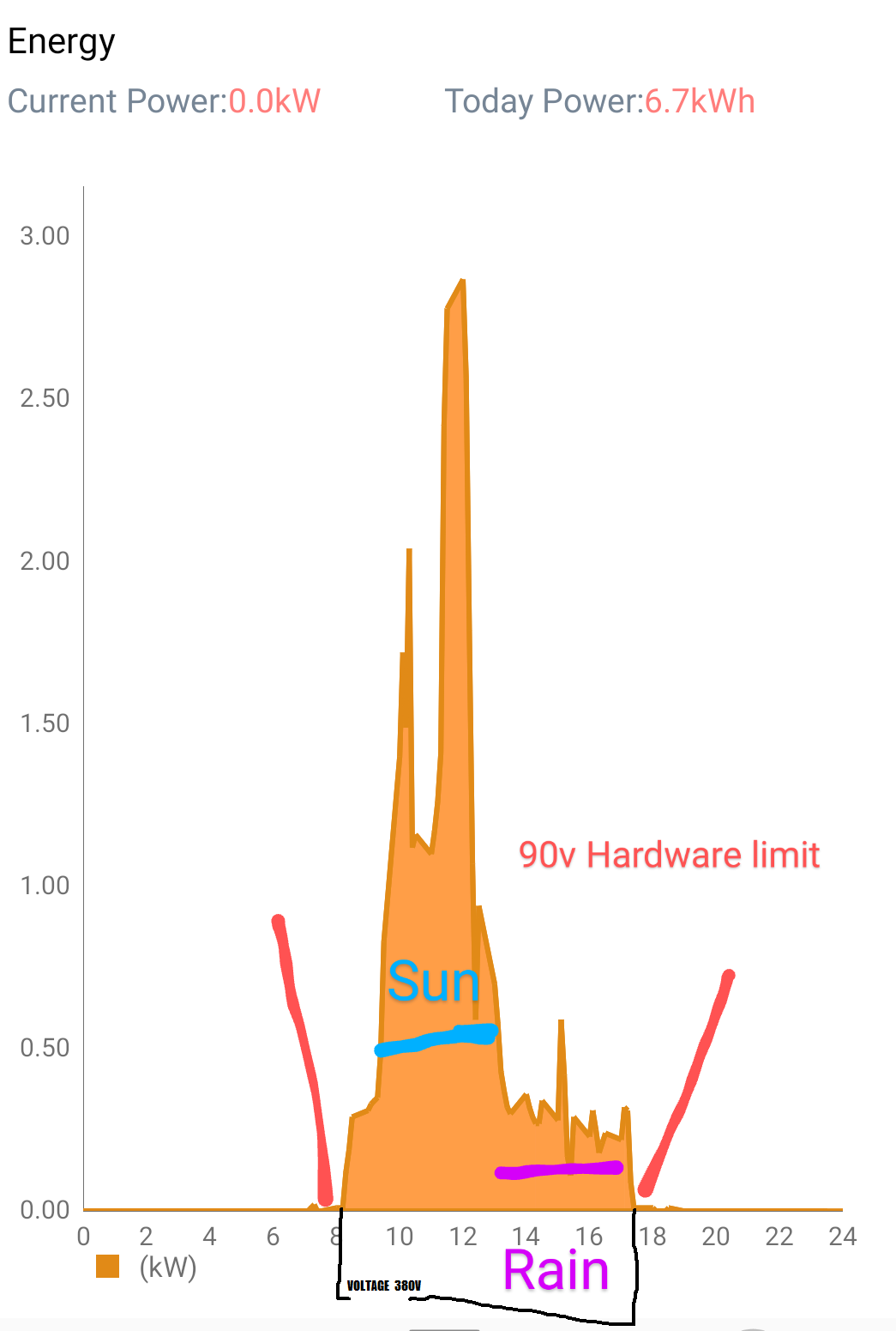

Here a view of the mppt Firmware working.
You see it Starts strait Up No more limitation even in very dark or cloudy situations.
The graph is Power Not the voltage.
In the evening also the Last bit of solar Power will be converted and used .
Screen Shot of the start

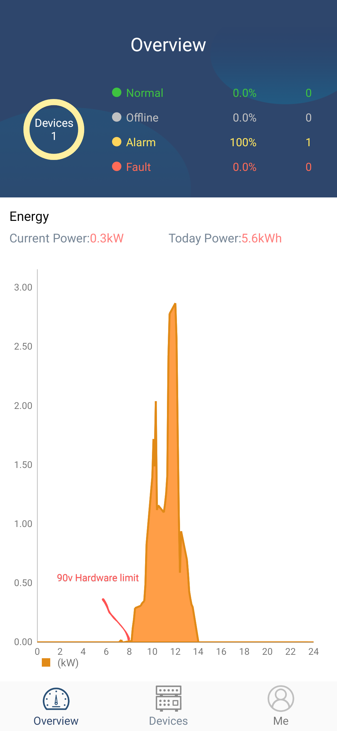

1 hour ago, Georg594 said:
See the Firmware work:
1719728036_Screenshot_20221013-1919453.thumb.png.668444eaffb46e493bf1040639a5b1ff.png
