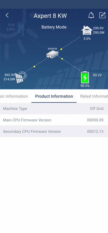

Good evening.
So the firmware from Georg594 is flashed and the inverter works fine.
The voltage value on the south-eastern string PV1 was around 300V for a long time and the current slowly decreased. At the end of the day, when the current reached almost zero, the voltage dropped to about 100V.
In one sentence, PV1 kept producing until the last moment. I have never had such a smooth end of day production.
I will continue to test it in the scope of my free time.
Georg594 thank you again for your help and your time.

Hi.
Version 90.09, 280V. With reflashxtool. I spend 12 minutes with it. After that I flashed display unit firmware to.(12.21)
