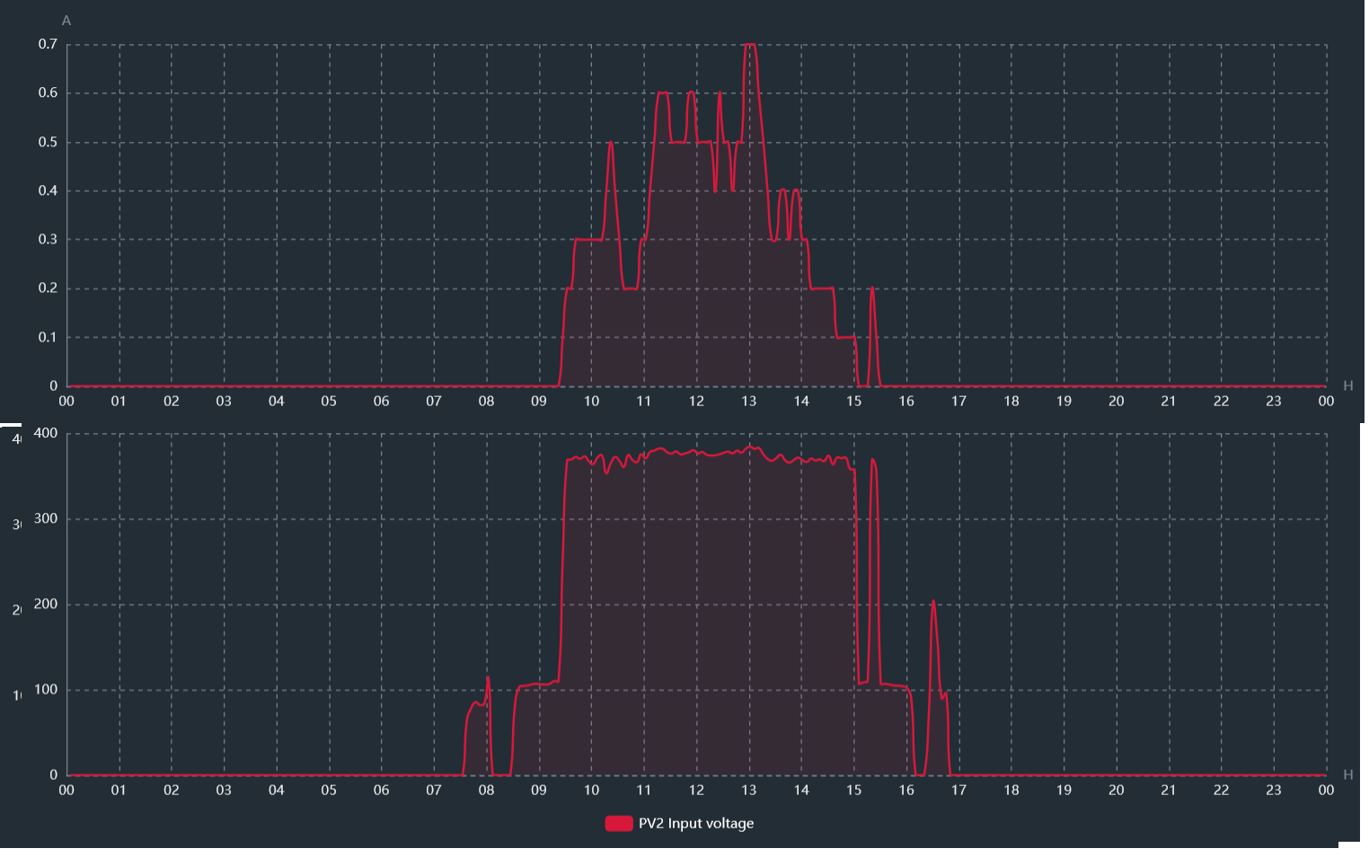

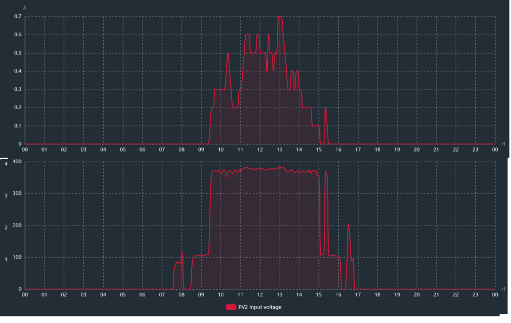

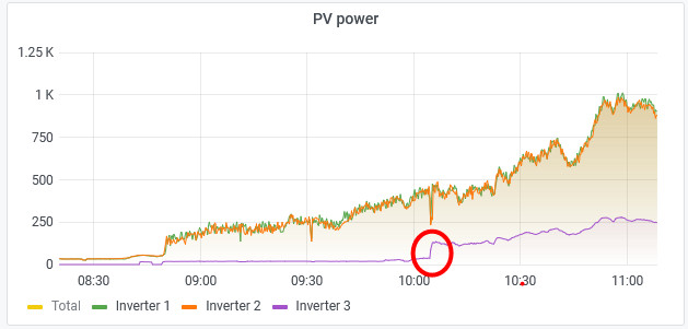

Hi Coulomb,
the pink line 3p3 inverter has 1 MPPT only with 1s7p (7) 300w mono on exactly the same roof and direction as all other panels. there was no sun peak today. Inveter 3P1 and 3P2 have 2s6p (12) 300 mono on MPPT1 and on MPPT2 on the same roof same direction and they did not show any watt change at this point of time. so definitively no sun peak.
so the pink 3P3 should go almost linear to the other MPPTs just with less watts as its 2100wp compared to 3600wp on the other trackers.
it stayed there for more than 1,5 hours until i dropped the grid breaker
i run the 175v version you made for me 2 days ago:
Firmware version
VERFW:00192.04
the red circle is breaker drop time. you can see other mppts was all nicely and very narrow each other increasing watts while pink line first stay horizontal and after breaker action it goes similar in relation to other trackers.
at this time 08:00 until 12:00 are no significant shading issues. between 10:00 and 11:15 there is absolutely no shading obstruction, later after 13.00 there is a 1000m mountain between the panels and the sun now in winter.

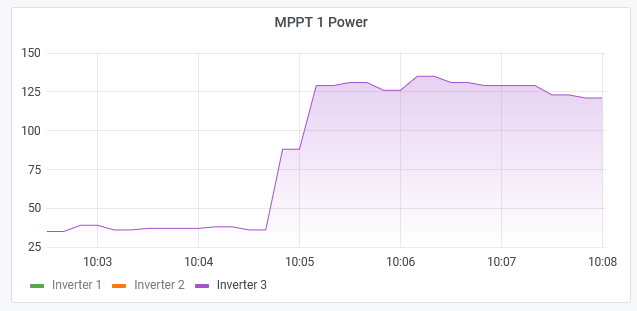

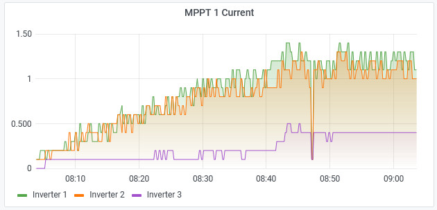

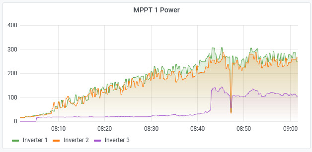

Today 3P3 MPPT1 (pink line) 1S7P started without any manual interaction, but still looks like it was locked in some time, while 1P3 and 2P3 MPPT1 and MPPT2 started very well.
mpptp.jpg.b2ec7367f82190a95803a4945cabd6c9.jpgmpptv.jpg.b98ceca3e1b82df1f9ee44f742011dcd.jpg
Looks like as soon as it hit 0.5A it started to work properly.
Looks like Georges Inverter starts 0,2+A and my Inverters over 0,5+A

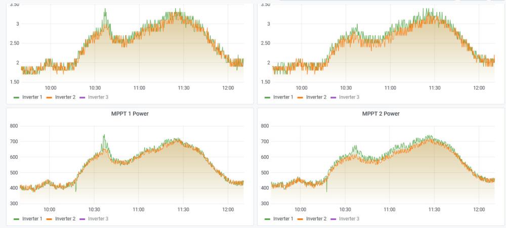

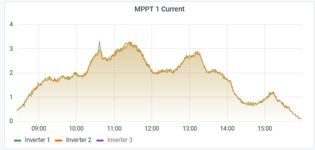

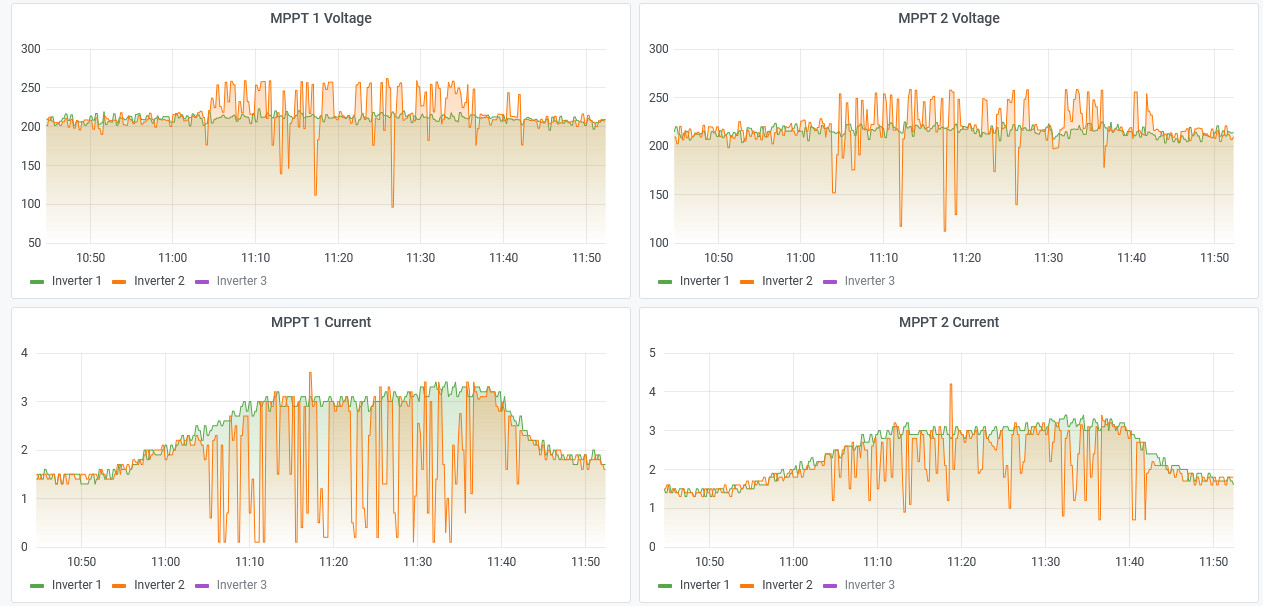

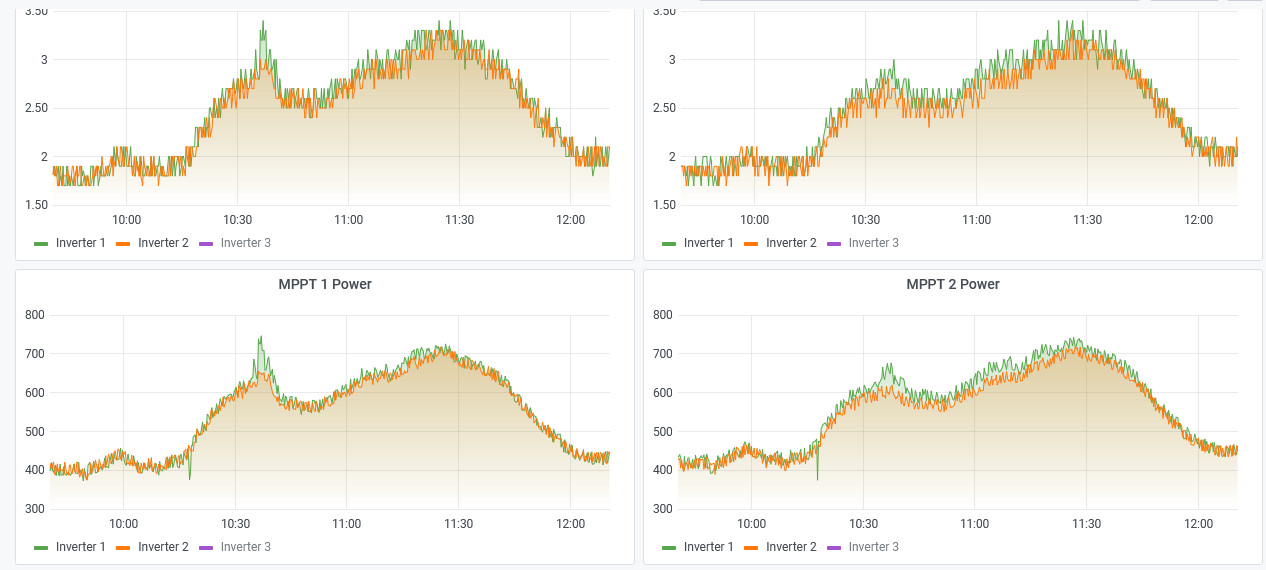

I had another strange thing today as finally there was a little bit more sun.
On a bit higher PV Power over 2 amps Inverter 2 started to make a mess on both MPPTs while Inverter 1 was completely nice. Panels of P1 and P2 are identical and side by side on the roof, so its not a shading issue. I checked connectors already but could not find any bad connection. and as it happens on 2x 2S6P identical strings (and identical to Inverter P1) i cant believe its a wiring or faulty panel issue in both MPPTs of this inverter.
some days ago before the firmware update there was a similar sunny day with similar load but these drops did not happen.
earlier day:
@Coulomb checked your changes and everything looks perfect.
@mjmx8k
Do you have a dc clamp meter for measuring the real pv input current?
(Beware of using normal series current measurements with multimeter because of the non isolated dc bus )
My axpert inverter has an offset of 0.12A until 0.16A on both mppts.
If my inverter shows 0.2A the real measurements are 0.34A .
Maybe this could be the answer 🙂😂
I hope that you are both zeroing your clamp meters before the reading; Hall effect sensors are notorious for offset and drift. Zero with the meter near the cable you are about to measure, though with at least 50 mm clearance. That's to approximately cancel the effect of the earth's magnetic field. But you probably know all about that.
yes, i will do that. thats my smallest issue at the moment....
