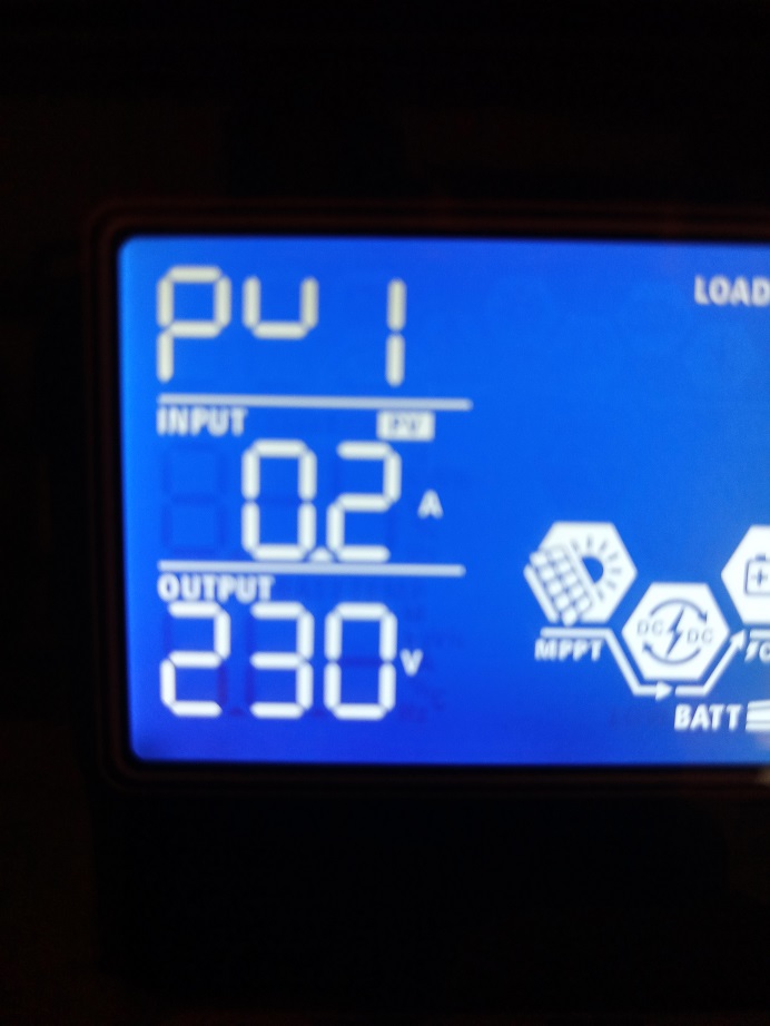

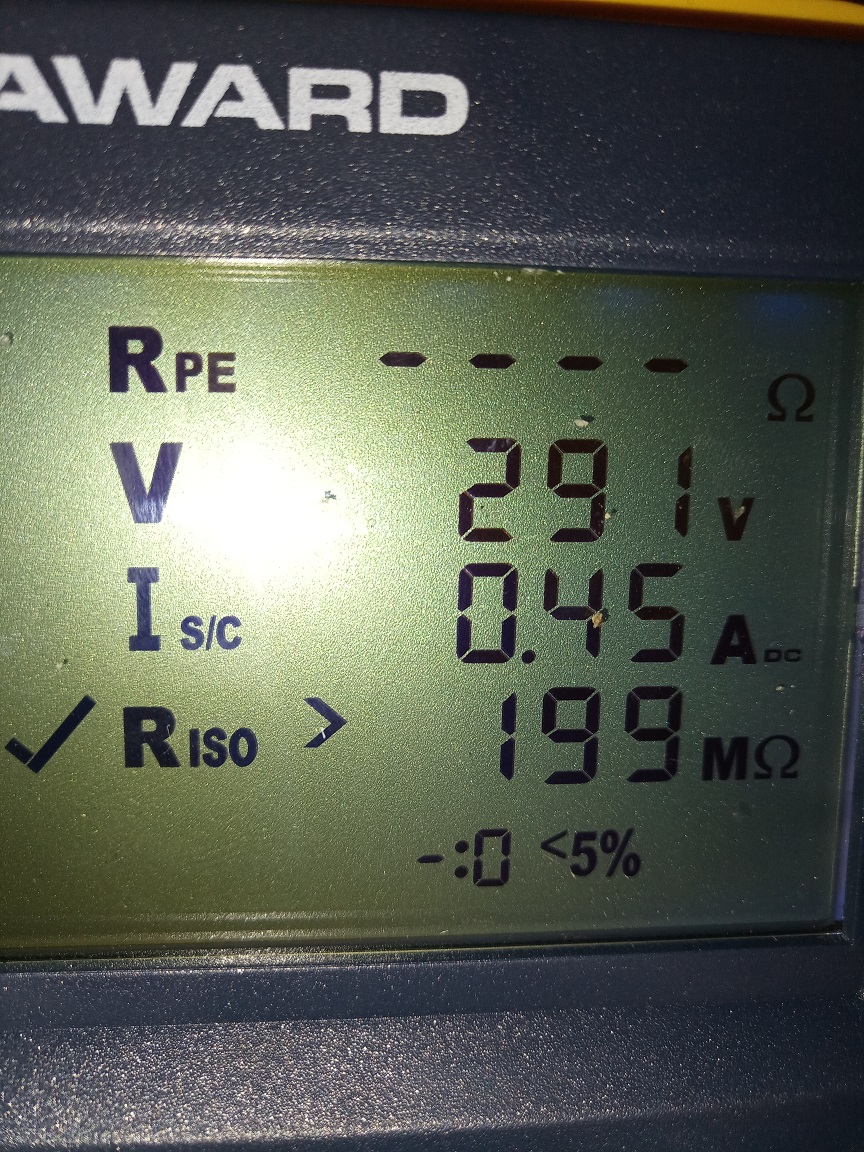

Both Clamp meters have too low resolution of only 0,1A. However both Clamp meters are very close to the readings of Inverter and also very close to Victron BMV Shunt installed at Battery Cable
So i disconnected the Panel cable(s) (very cloudy today and so very stable low power) and measured short circuit current.
Inverter 0,5A, Multimeter Short Circuit 0,598, Clamps 0,6
Inverter 0,4A, Whole String connected directly to the Seaward Meter: 0,45A
Inverter 0,1A, Multimeter Short Circuit 0,135A, Clamp jumps 0,1 0,2, Seaward 0,15A
Multimeter has highest resolution 3 digits.
  • Replies 656
  • Views 109.7k
291 Volt x 0,45A = 130 theoretical watt
The inverter give 235v 90W before and 268v 98 watt after direct panel connection measurement on the photo above
so this is ok. and inverters measurements are ok too.

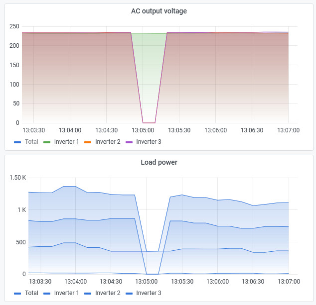

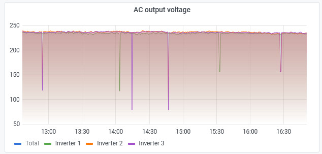

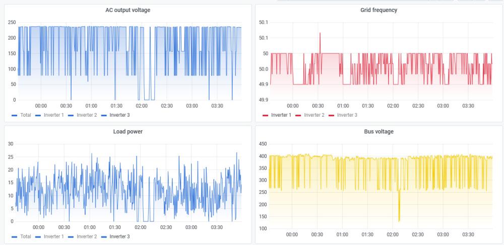

power loss again on 2 phases some minutes after F80 restart:
Not nice....
F80 errors have the tendency to appear either in the beginning of the PV day or at the end of the PV day.

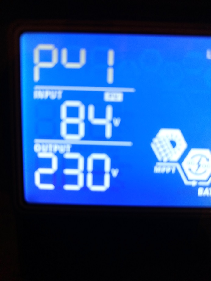

I seem to have a similar issue to everyone else in that it sticks at 90v on overcast days until switch to USB then back to SBU an then it starts tracking until some thicker clouds come over again. Please see attached photo.

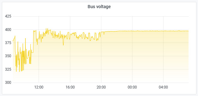

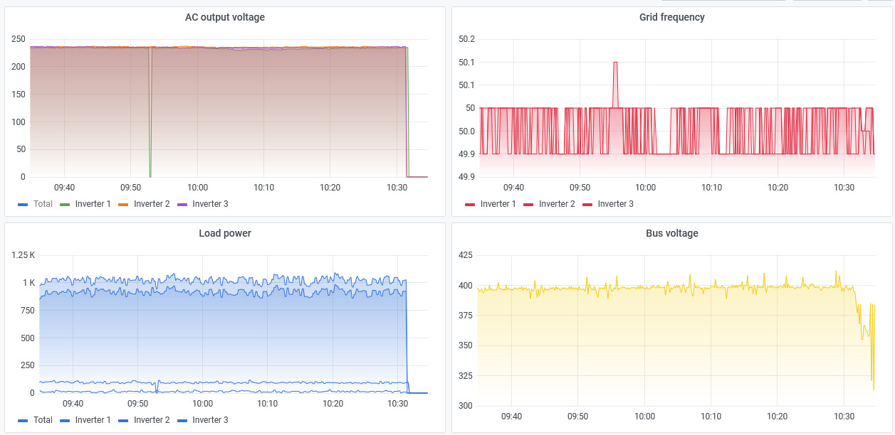

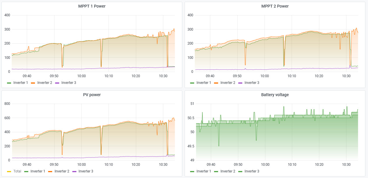

Error 80 always seems to happen when the bus voltage drops - this explain also why this tend to happen in the morning at PV Start, in the afternoon and PV End and on sun/shade situations.
I swiched on grid charging 2amp (now Solar & Grid, before it was Solar only) on all 3 Inverters.
Now Bus voltage is much more stable.
Since switched on i had zero power losses on AC Out
Cant see in SA single inverters bus voltages - only combined, but i guess the AC Out power losses also are in relation with bus voltage drops.
lets see what the next days bring up.
Georg, maybe the "steal some Energy" can affect the bus voltage and cause voltage drops?
Just an idea. Anyway, F80 and AC Out losses also happened before patched Update, but maybe there can play something together. Maybe there is a way to steal in other directions to stabilize the bus voltage.

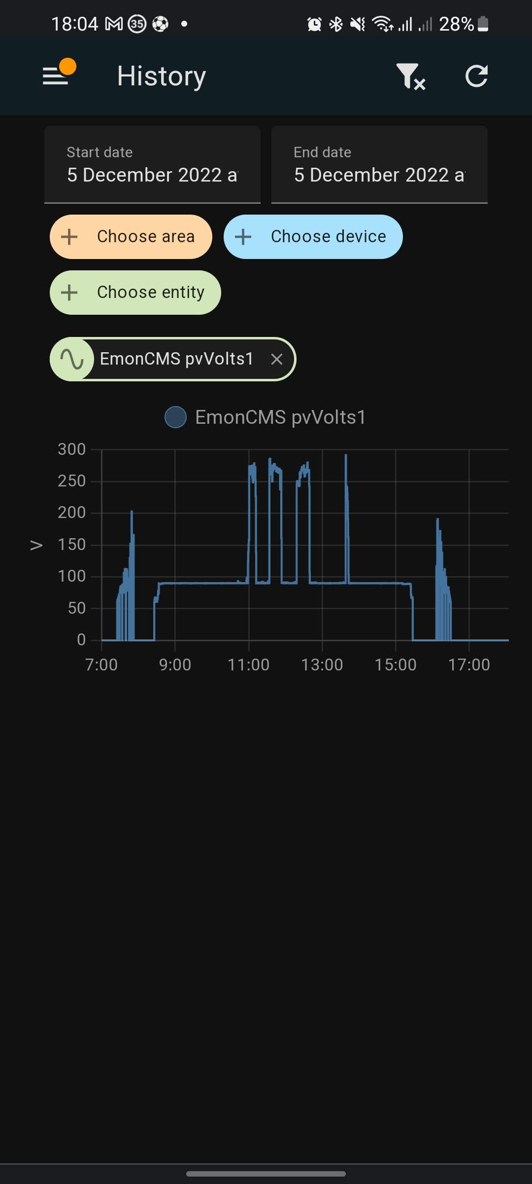

about the 90 volt issue:
the panels bring definitvely more than the inverter processes in low light conditions

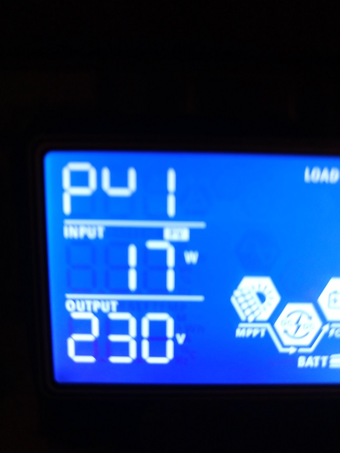

measurements from today afternoon.
Measurement equals to 139 watt 7x300w string
connected string back to inverter:
show 17 watt only.
IMG_20221206_143300_870.thumb.jpg.afd519381c0e65fa8837e2fe7f781447.jpgIMG_20221206_143307_343.thumb.jpg.36295daef4277ed1000b43d906b925de.jpgIMG_20221206_143312_103.thumb.jpg.39c56359eff2a1dd7429f62ae0d023a6.jpg
Other strings:
53w measured 13w inverter 8x195w string
85w measured 20w inverter 2x6x300w string
Edited by mjmx8k
139 W appears to be Voc multiplied by Isc. You can't get both at once; one is open circuit and the other is short circuit. You might get about 80% of that, which is still 112 W, way more than you are getting.

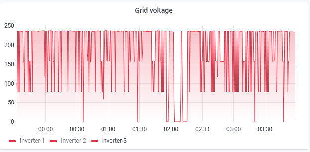

today I will replace 3P3 inverter as it makes crazy things during night. shows about 20 grid phase 3 only losses, but grid frequency still visible at ~50hz, 20 AC Out losses some as long as 7 Minutes and not switching to battery. showing in log 5 times PV Loss (in dark night) 4 times EEPROM fault.
3P1 and 3P2 behaved well without all these things and working continuously.
This is the pink line inverter which lost all stored parameter after flash.
As the 3P3 carries a AC load of only ~20 Watts, could it be that it goes into any Eco Mode or Power Saving mode to disable AC Out and Grid for 7 Minutes without switching to battery?
Or do you think a reflash could make sense?

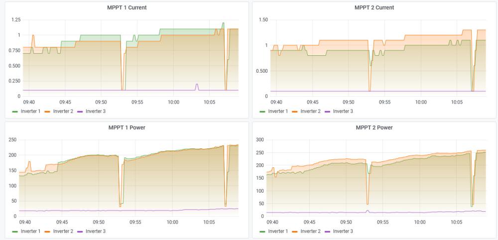

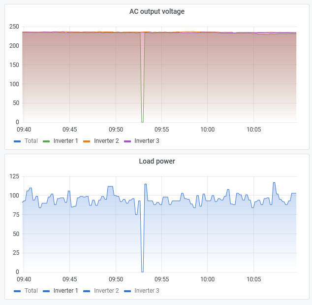

Had not much time today for this. However, PV on 3P1 and 3P2 started up very well - PV curve very nice and parallel, made 10kwh with 4MPPT
PV of Inverter 3P3 breakers was off whole day for testing as Inverter was replaced.
Not one AC Out Phase loss on any phase since the inverter replacemnet the afternoon before! Happyness...
...until afternoon...

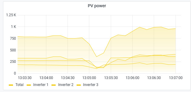

15:40 still 300w total PV Power out of 4 MPPTs
15.40 2 PV Breakers of 3P3 enabled -> got 0,1 amps / 30 watt extra
15:43 Grid breaker enabled -> MPPTs reinitialized, 3P1 & 3P2 went from 0,4 and 0,3 to 0,1 amps and did not go up any more (either locked in or really too less power)
15:45 : AC Out Loss 3P1
15:48 AC Out Loss 3P1 & 3P2
15:49  All 6 Trackers reach 0,1 amps / 100watt PV total -> Strong suddeen drop in Bus Voltage 397v down to 360v -> AC Out Power loss on all 3 Phases  -> Fatal F80
My finding:
when when PV gets very low watt / amps -> AC Out loss -> F80
when PV is gone away System is stable again
when in the morning is enough PV power to start quickly then all is ok, when its bad weather and it has to play aroung to startup this results in F80
