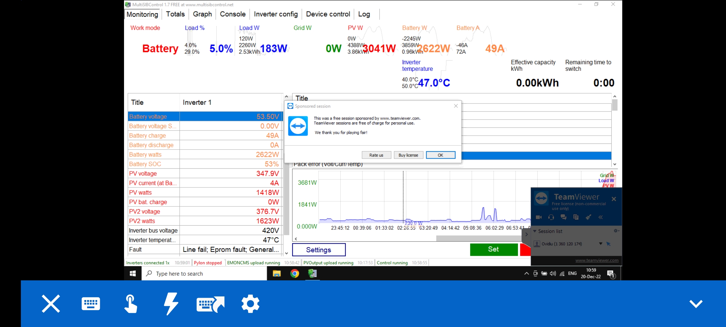

16 hours ago, mjmx8k said:
MPPT spikes bigger than 30 volt creates AC Out losses
I never experience AC Out Losses no matter how hard the MPPT spikes:
I only had AC dropouts when I had two inverters in parallel operation and only when F80 occurred.
As you can see when it spiked (4 seconds spike), it switched to Battery from Grid input (you can tell by the nice smooth 230V line since the grid is all over the place). Again, when it actually started production and MPPT Voltage went to 380V.
It starts to make a little more sense since I had F80 just for switching operation mode from Solar Assistant and Boom F80, AC out drop and all went to bypass. But I suspected Solar Assistant was doing something wrong or pure coincidence.
I'm using the inverter with the factory firmware, never patched it or messed with the firmware (73.04). I missing a lot of power production, but for now I thought it may be good to have one untouched and monitored for reference until this things are sorted out.
So I think that you might be right about the sag. Maybe the supply voltage of the parallel board sags too much during the spike and when the master inverter tries to tell the slaves to switch modes, the communication is not working right.
If you have soldering skills I would suggest to power the parallel boards from an external power supply. Since is isolated from the power side you could use the same power supply for all the boards. You would have to disconnect the small two pin white connector (CN1) and solder the external psu wires directly on the filter cap (C1 - as per schematics in Coulomb's link). This way no matter how hard the DC bus sags, the CAN driver and the optos would not be able to mess comms and F80 should not occur.
Thank you for the chart.
In fact, this proves that MPPT spikes influence the whole system in one or the other incorrect way.
as 2 parallel have shorter transfer time than 3Phase, maybe in your case the system manage to switch to battery right in time instead of loosing AC Out. Both parallel types have to monitor and regulate frequency timing synchronization, but 3Phase needs additionally monitor phase timing shift. so maybe in a parallel single phase the AC Out could be avoided as there is a load balancing for the same phase.
i think the F80 is a correct reaction in both parallel types and we need to find the source to these reactons.
i also think that the MPPTs of the newer DSP chip models work / behave differently from the older chip versions, so maybe voltronic has not yet really adopted the newer firmwares to the newer DSP but did only a drop in replacement with some get it working quickly fixes.
it seems that the older DSP models work well with the patched versions, but my models with newer DSP defintitively still have issues with the MPPT.
It also proves that these spikes appear most often when the MPPT is sticky or (of course) releases from the sticky point) (and no matter what is the definition of startup voltage in the patched versions)
( i found one spike in the middle of the night to 60v, panels covered with snow, so its not from the moon)
based on my SA charts i even want to go further and say a spike in one inverter can create an AC Out loss in an other inverter (CAN Bus communication and correction attempts)
