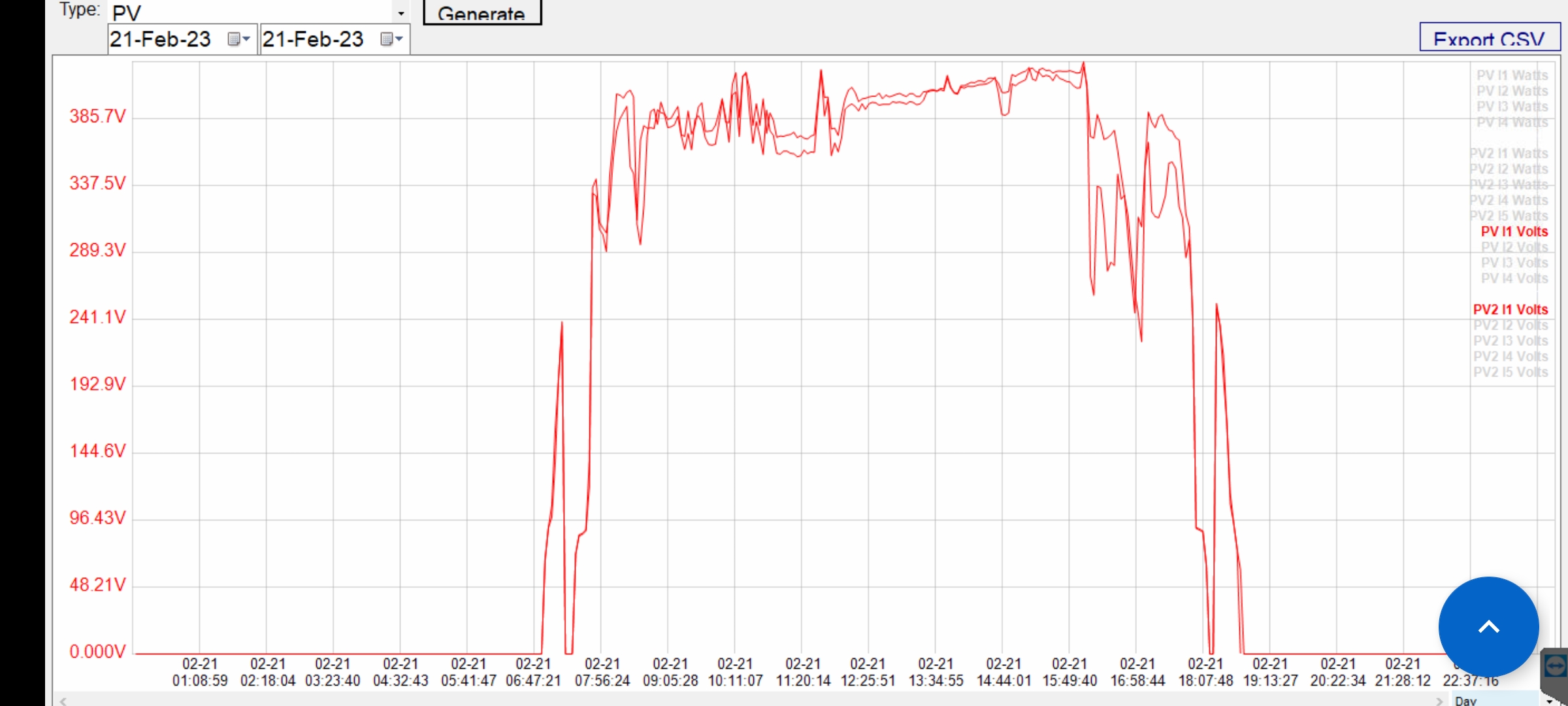

This is the voltages today. Sunny weather.
4 hours ago, add1c7ed55 said:
Pls tell me if i put the 350v and sometimes will have under 350v..what will happen?
You will get reduced PV production, possibly zero.

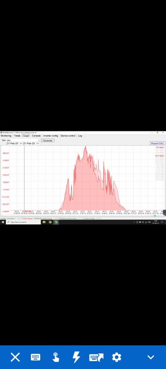

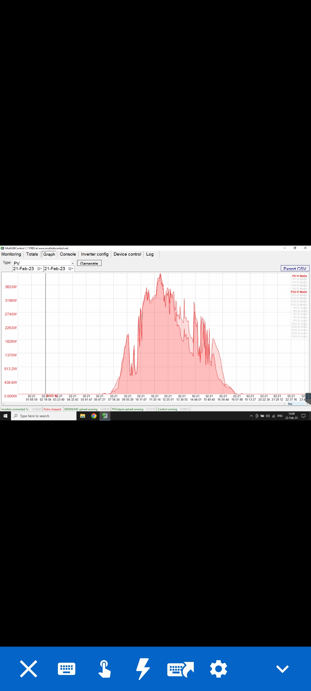

Thanks. You do seem to have plenty of voltage in good sun.
How was the current and/or power? Particularly MPPT2 after about 4pm, when MPPT1 went down to around 300 V, and MPPT2 to around 350 V? I'm guessing with the dip around 5pm, you would have gotten very little from MPPT1, and nothing from MPPT2.
9 hours ago, Coulomb said:
Mulțumiri. Se pare că ai multă tensiune la soare bun.
Cum a fost curentul și/sau puterea? În special MPPT2 după aproximativ 16:00, când MPPT1 a scăzut la aproximativ 300 V și MPPT2 la aproximativ 350 V? Bănuiesc că, în jurul orei 17:00, ai fi primit foarte puțin de la MPPT1 și nimic de la MPPT2.

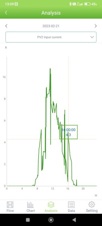

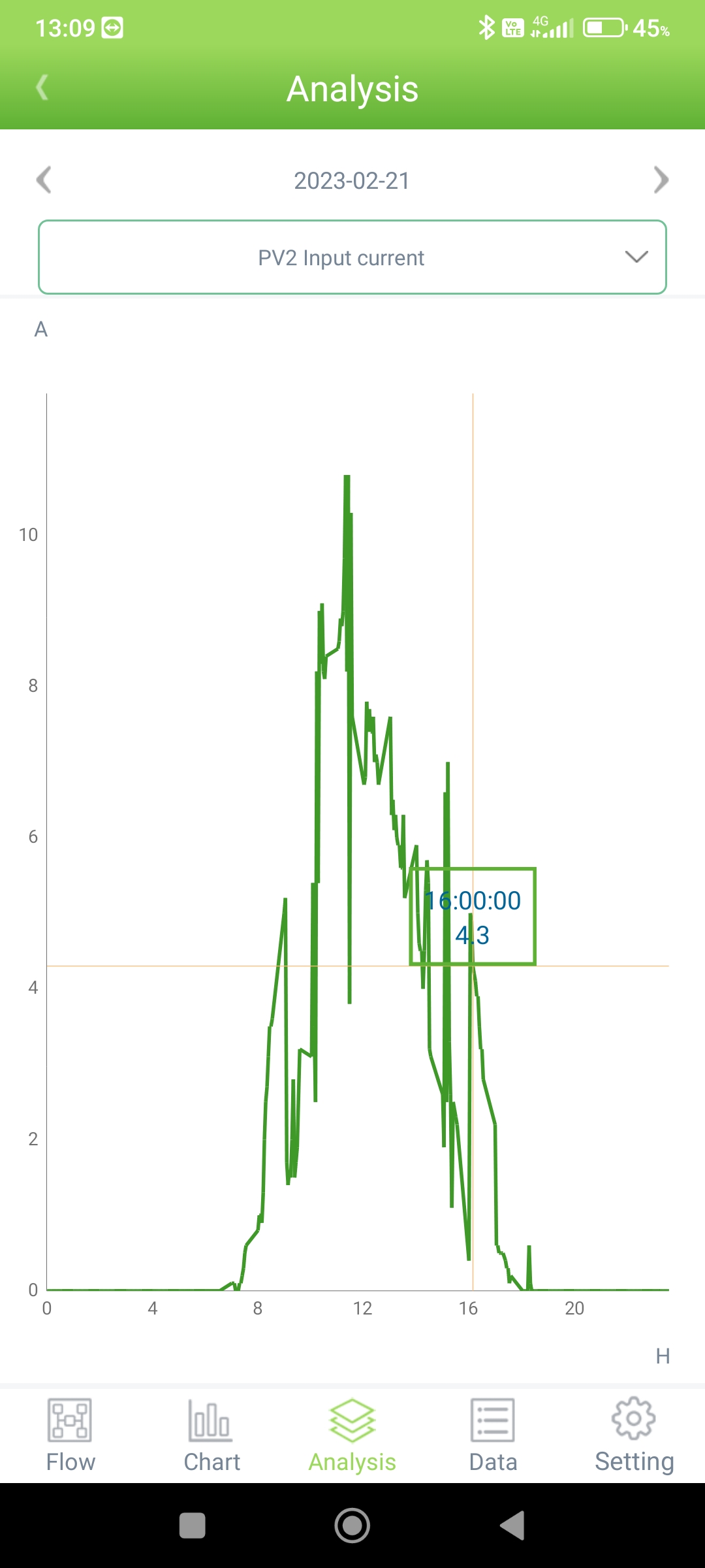

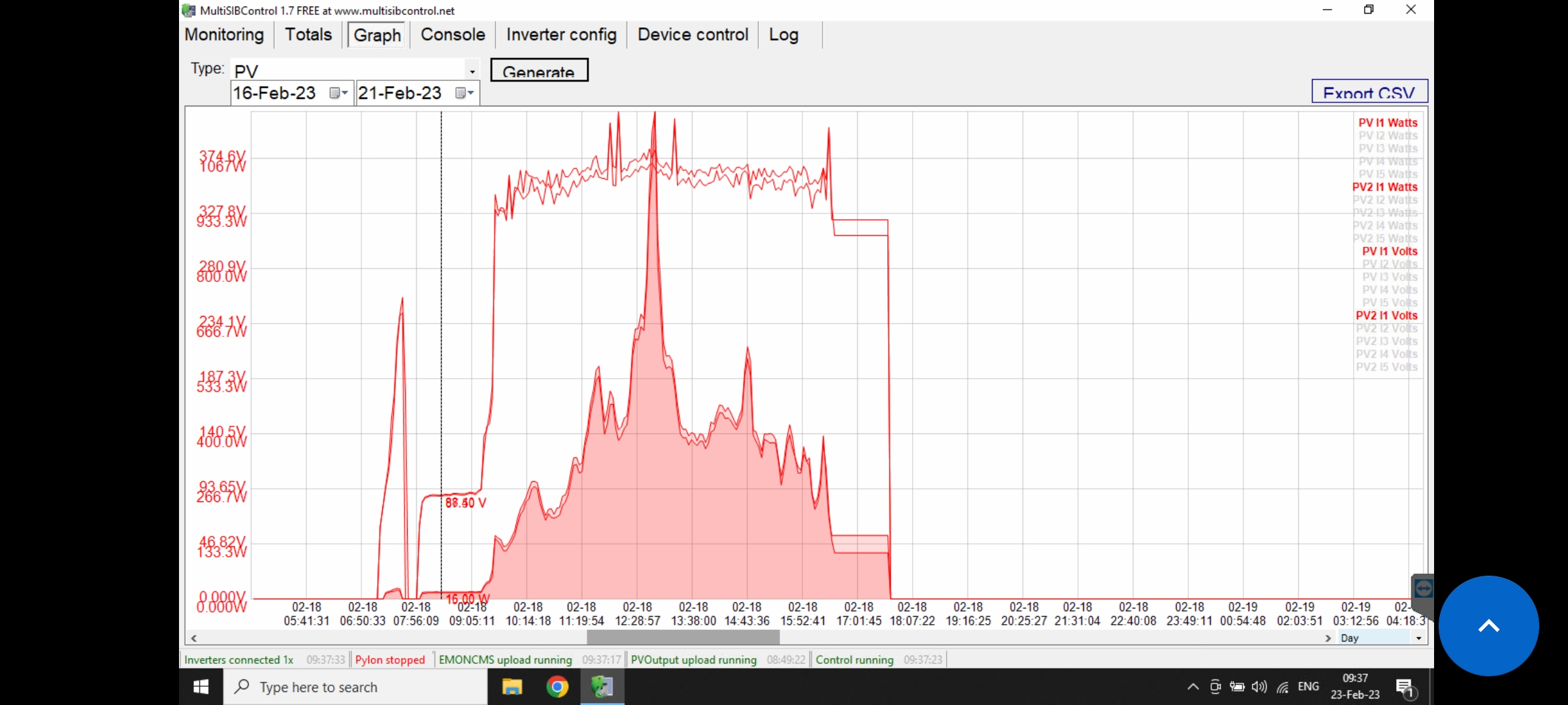

Here is the graph.
2 hours ago, add1c7ed55 said:
What voltage do u think i need ?
Well, in sunny weather, 350 V does seem to work better (assuming it's PV2 with the higher power, I can't figure out which is which on the power graph).
The power output seems well matched 9am-1pm, so the strings seem to be comparable.
But perhaps wait for a cloudy day to see if performance is really poor for MPPT2.
5 hours ago, Coulomb said:
Ei bine, pe vreme însorită, 350 V pare să funcționeze mai bine (presupunând că este PV2 cu putere mai mare, nu îmi pot da seama care este care pe graficul de putere).
Puterea de ieșire pare bine potrivită între 9:00 și 13:00, așa că șirurile par să fie comparabile.
Dar poate așteptați o zi înnorată pentru a vedea dacă performanța este într-adevăr slabă pentru MPPT2.
One of the mppts is a little shadowed, and the other mppt on the sunrise is less luminated cause the sun is rising...probably 350v is a little more...can we try 320v? I have all the graphics in all day...what to verify on the rainy days?

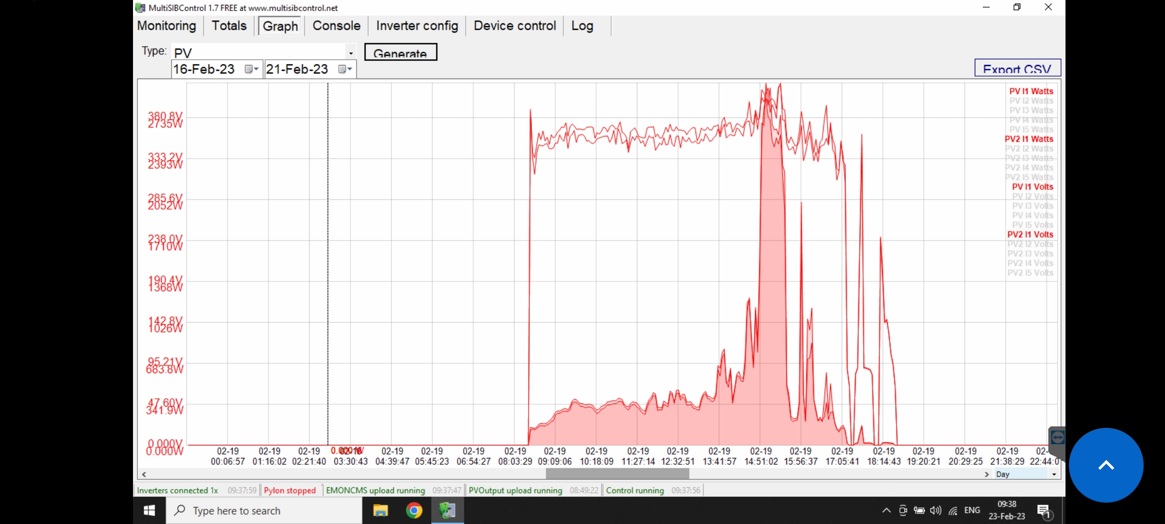

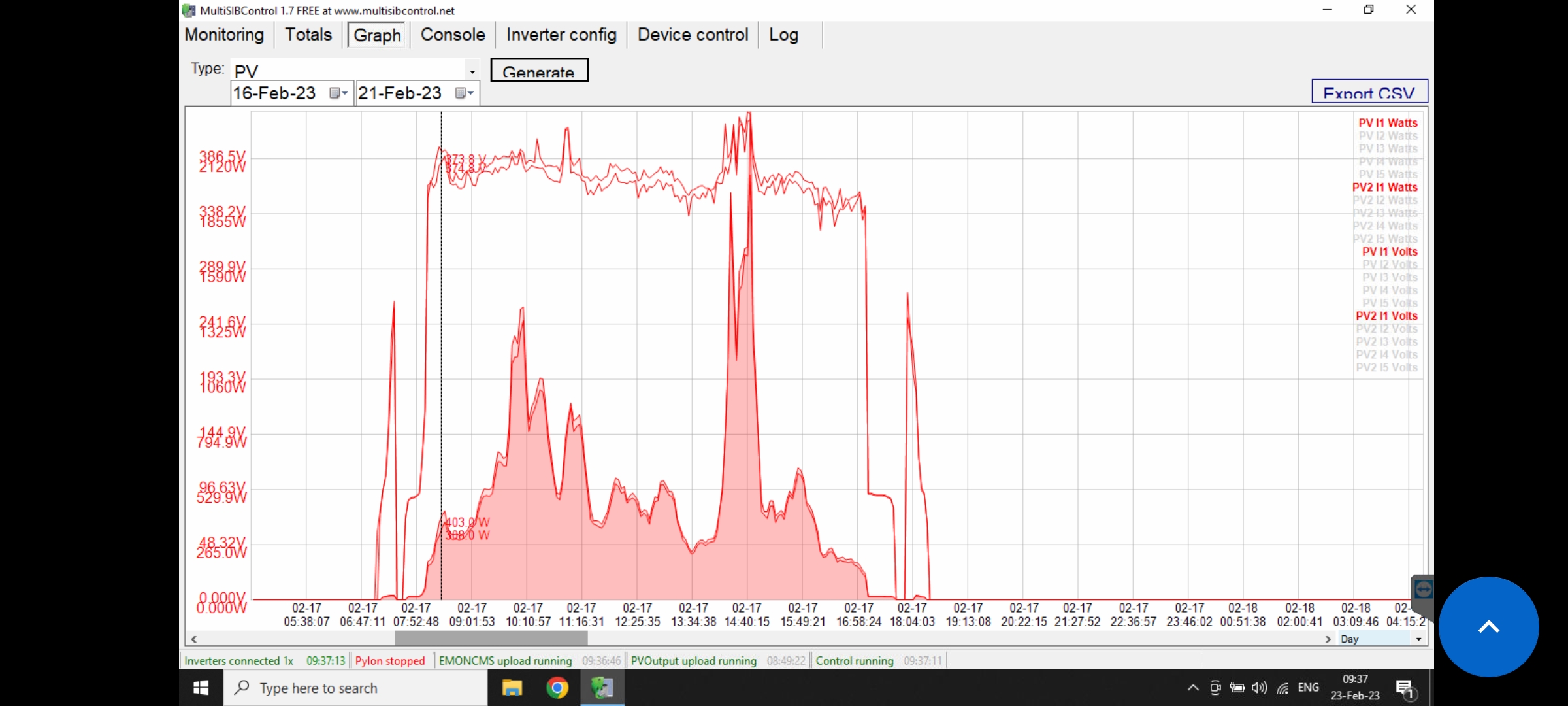

Here are 3 days cloudy and rainy. Mppt2 produce a little bit more than mppt1 but is a bug of this.inverter, all 8k make this bug even i change the firmware.
