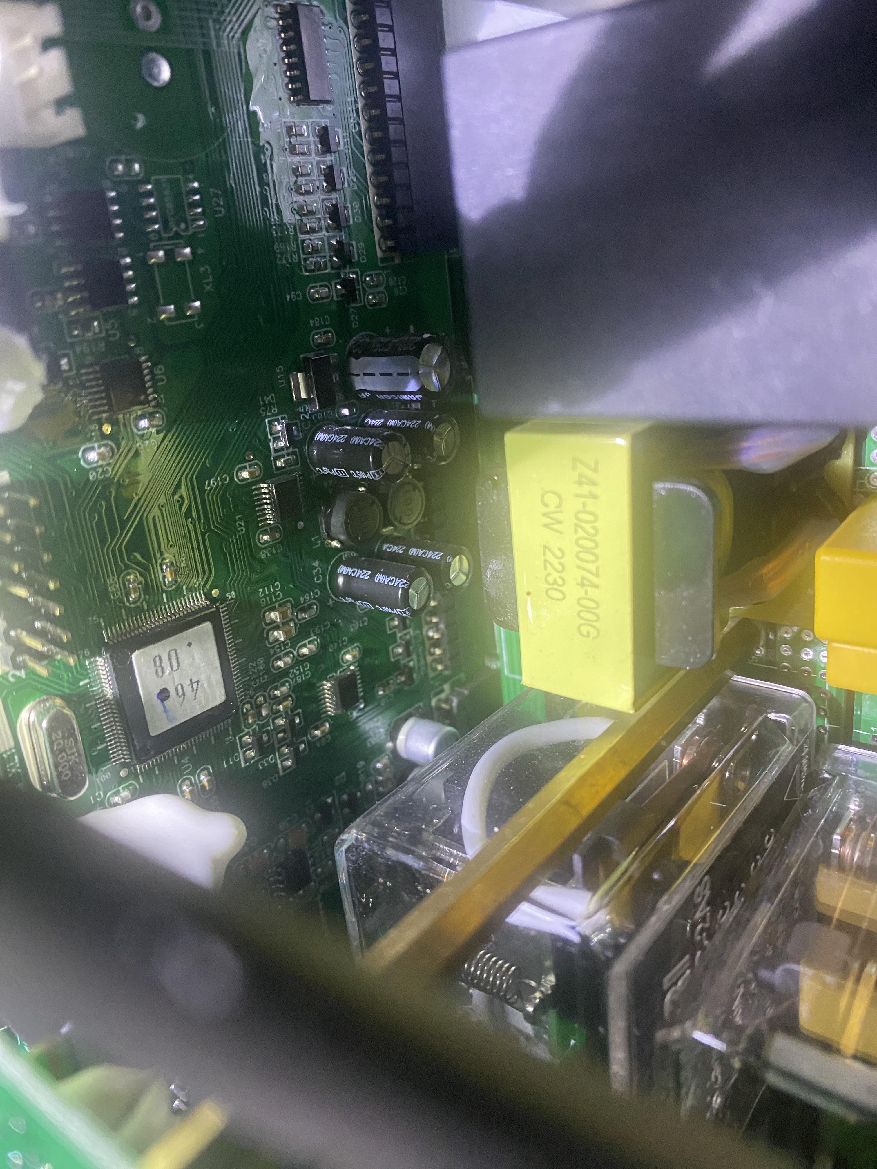

hello again Coulomb, I opened the display and tried to take a picture of the processor,
Ah. It's good to know that you have the GigaDevice processor in the removable display, but for MPPT problems, it's all about the DSP chip inside the inverter's case.

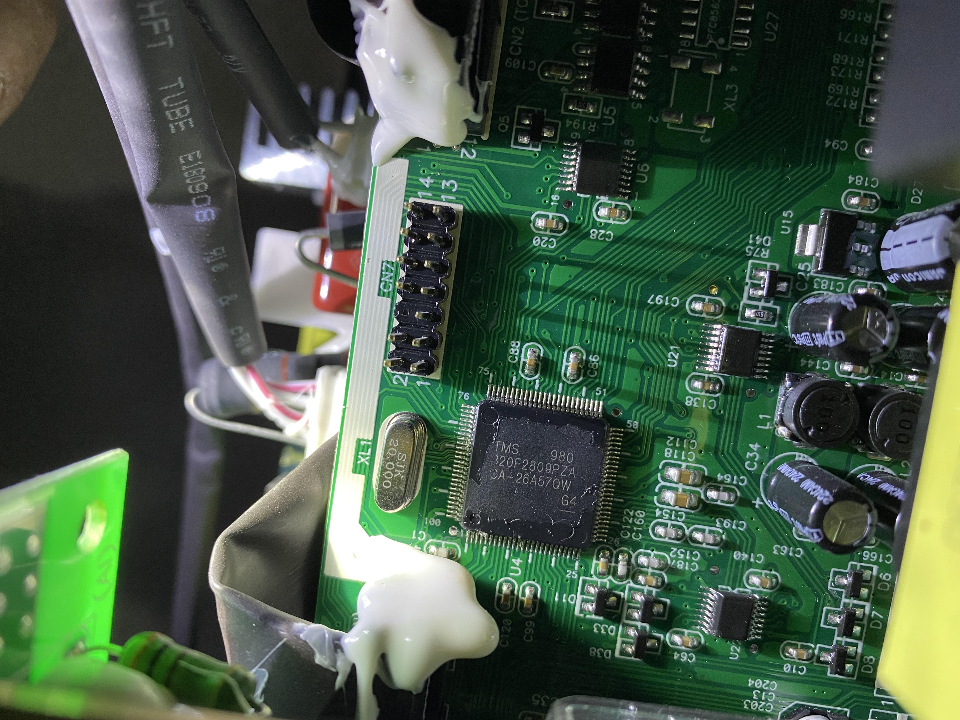

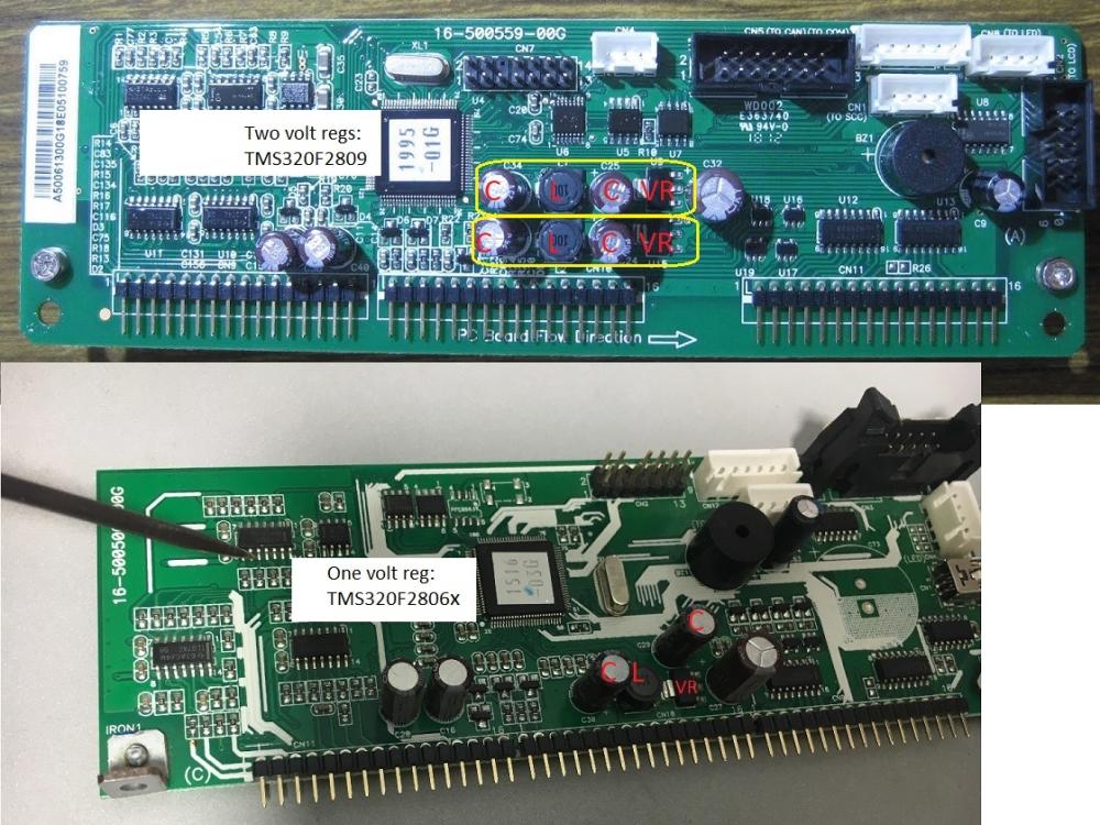

hello again CouLomb!
I opened it and I have version 2809 at DSP,so it should work,
what do you say?
what do you say?
Sorry for the delay, it's been a busy day patching King firmware.
Yes, you could try any of the patches in this thread that are based on 90.06. I would suggest the very first patched firmware in the very first post, unless you have particularly low PV voltage (e.g. few panels), in which case try the 100 V MPPT version a few posts later. If you are more interested in shade management, there is a separate thread on that.
