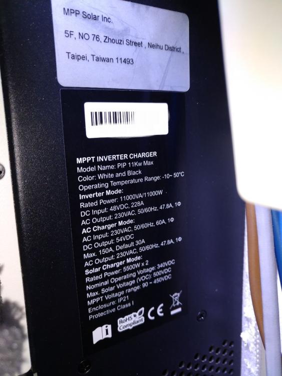

I can't find such sticker with the month; was purchased around May 2022.
Is MPP Solar 11Kw model, with 2 PV streams, each with 5.5 Kw, tested, it works with 5.5 Kw on each PV stream. more details in photo
