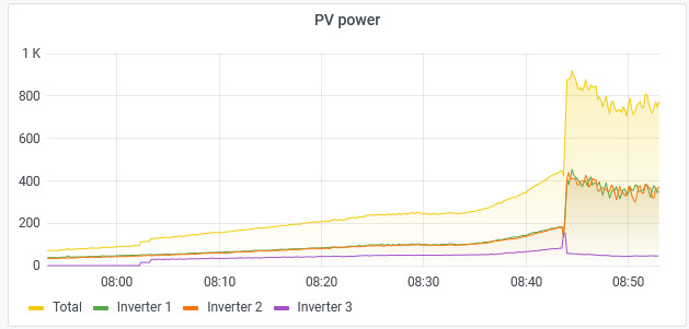

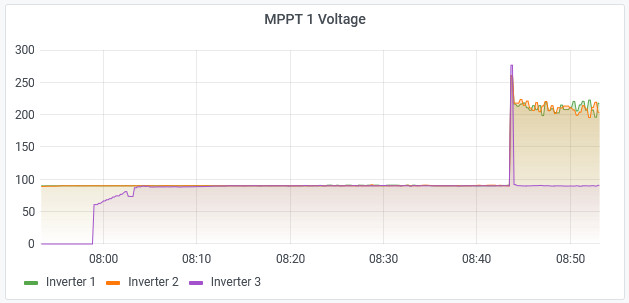

8:43 Grid breaker off

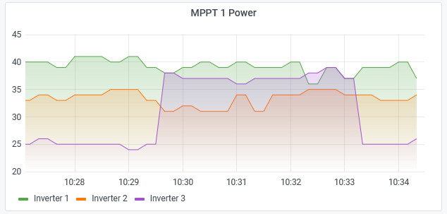

3P1 & 3P2 MPPTs jumped up double watts
3P3 MPPTS still stuck at 90v, stay at 15 & 33 watt, should be at least 80w each.

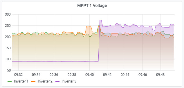

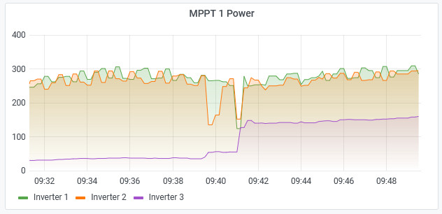

09:39 Grid breaker on, 3P3 MPPTs went up a little
09:41 Grid breaker off, 3P3 MPPTs released from Lockin at 90v and went to real watts

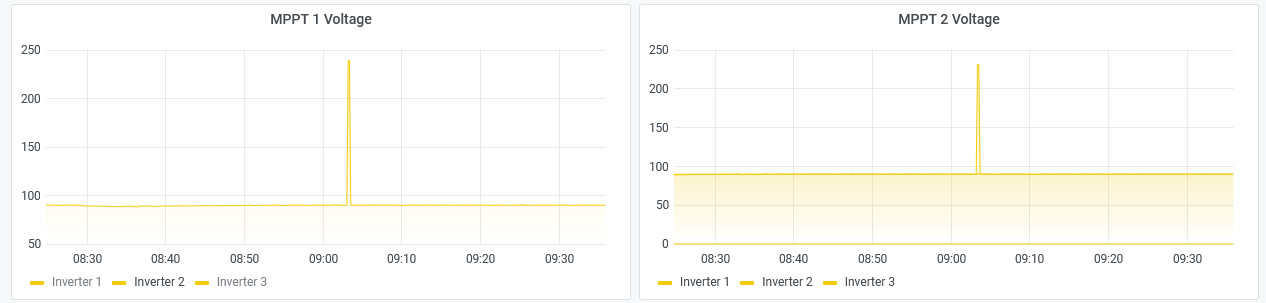

by reading your thread about plugging off the mppt cable from the help supply board:
could this MPPT voltage spike be related to the help supply PCB?
this spike is exactly the same time as the AC OUT power loss
shall i give it a try to plug off the cable from the helper supply board on all 3 inverters?

It could be that the MPPT spike is a result, not a cause, of the AC out power loss. We know that the MPPT resets to not clamping at 90 V when you change operating modes (line to battery or vice versa), but that the MPPT sometimes tends to go back to clamping shortly after. So in your graphs above, it looks like the MPPT is clamping all the time, except for that one point, which might be related to a mode change, or some other event that has the same effect as a mode change.

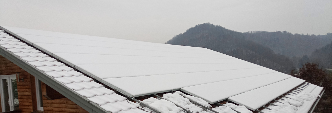

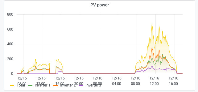

Its snowing and this is how the panels look. they do in this situations 680 watts!
AC Out is stable
No F80
All in all, it looks like a HUGE improvement already now...
As we have very stable "bad" weather and guaranteed no sun irradiation changes, i think there is still some kind of "locked in by amps" and not locked in by volts:

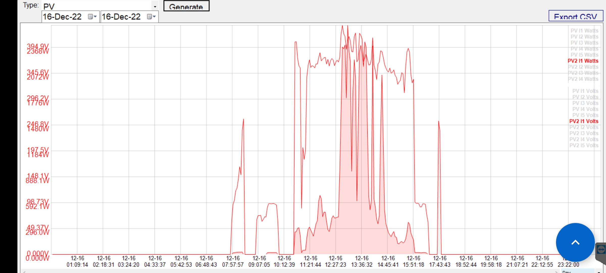

in this chart - for absolutely no weather related issuse - suddenly the watts jump from 70 to 177
it looks like the MPPT did not find a better point for long time and suddenly found.
so maybe there is still space for more optimizarion of the MPPT code
It's amazing to me that any light gets through that snow.

Edit: As a point of interest, is it feasible to melt the snow from the panels with a garden hose? Or would the water from the tap be frozen anyway? Or maybe it just takes too long, or it's just too miserable outdoors to attempt such a thing. You can maybe tell that I live in a vastly different climate, where we never see snow.
I looked on the panels again and It looks like snow slipped downwards on the panels and opened them partly. maybe this caused the sudden amps change. i will closely monitor this the next days.
currently snow falling down from sky is faster than me with a water hose and i should use salt water.
hopefully the weather to become a bit warmer the next some day and maybe will melt down a bit.
sorry, there are no kangaroos in Austria 🙂

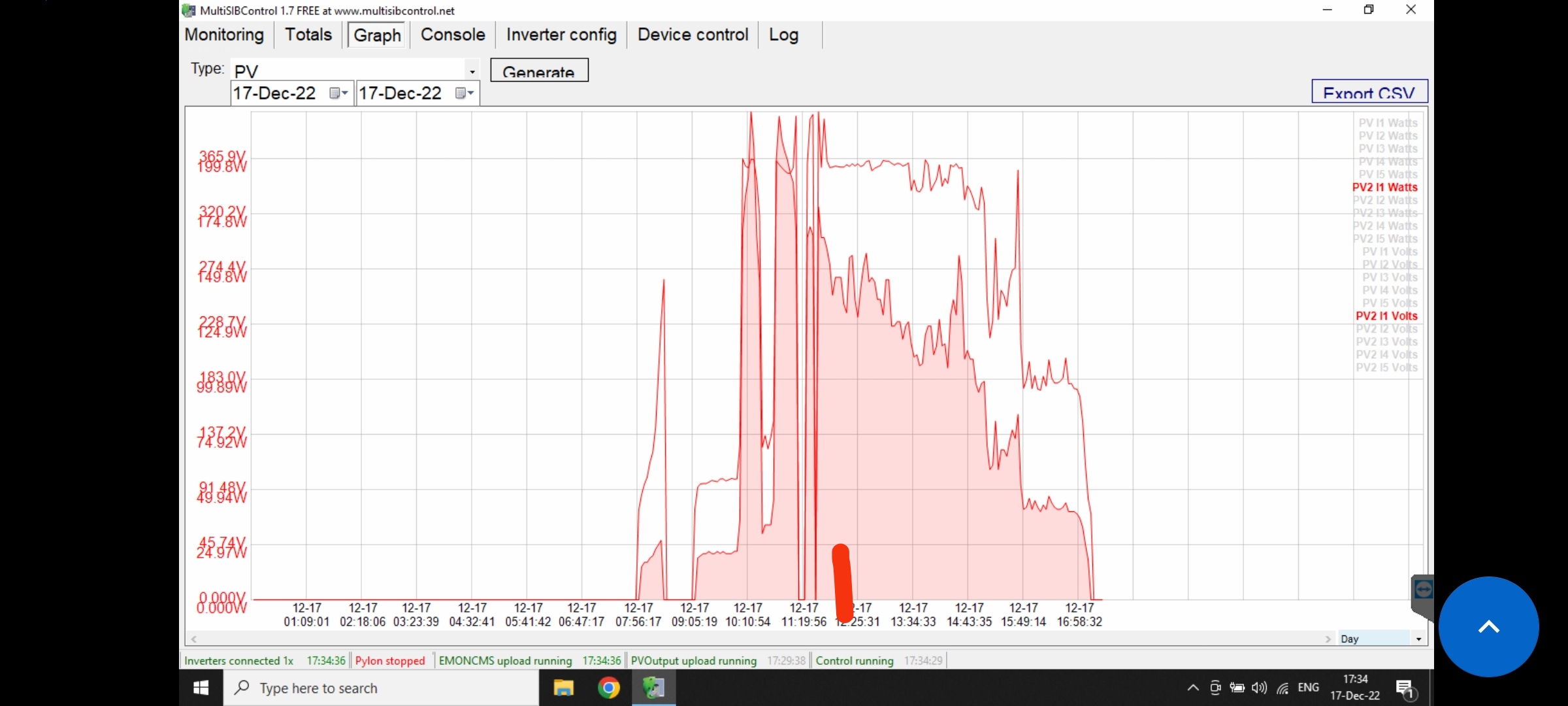

stressed the system today a bit for almost an hour. at the time when pv is close to problem time i used 8kw load on 3P3, some AC Units heating on 3P1 and 3P2, Computers running on P1, ... 15kw peak load.
switched grid off / on, to BATT, to SBU, ...
ALL WAS WELL! no AC OUT losses even on SBU SUB changes, no F80
I really hope the system continues perfectly stable like today.
2,9kwh today in worse weather compared to 0,9kwh yesterday

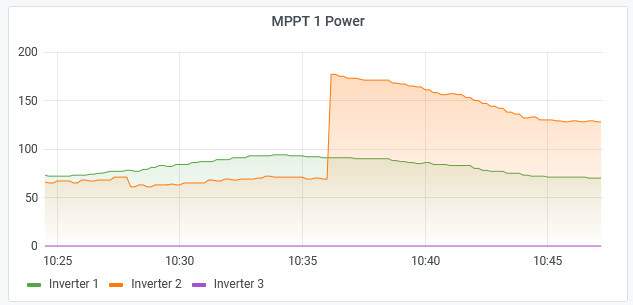

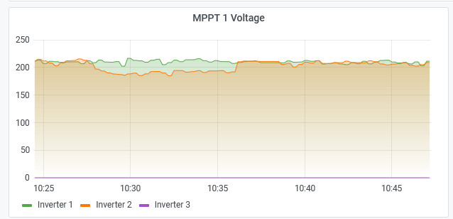

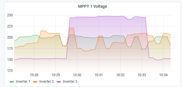

The Grid "power on" is still blocking the MPPT:
see the chart pink line.
grid off, Panel voltage and watt up,
grid on, panel voltage and watt down:
its a 100 volt difference!
another cable to pull?  🙂

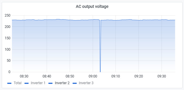

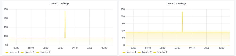

ARGHH, and this power switch caused now an F80
Correction:
the reason for this F80 was not the Grid Off ON but it was another Spike +95v in MPPT1 of 3P3
Edited by mjmx8k
