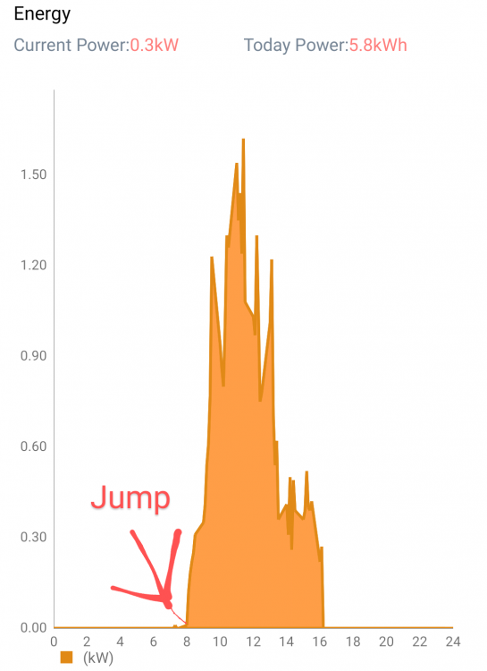

Look at the solar power when it jumps....this is under 30 watts
If you relate I got 4.4kw solar peak power it's just nearly perfect

This is my voltage at 20°C outside
And this happenes in sunny sky and cloudy or rainy too ? I ask this cause with my firnware 72.03 work ok on full sun, when i have 70/100w its increasing, but on rainy or cloudy, i have 3A om string and tge voltage remains 90v.

The original MPPT works fine with direct sunlight.... only if not, then my tweak is relevant.
My screenshot is a cloudy day definitely no direct sunlight.
