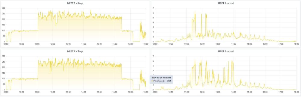

I have EASUN ISolar-SMV-IV-5.6KW with stuck at 120v. Is any chance to obtain mppt fix?
61.01 & 22.20 updated to 61.03  22.21.
I can provide detailed graphs and test it.

The starting PV voltage is 120V. It's a very cloudy day. Successful breakout. It doesn't stick.
The loss is small.

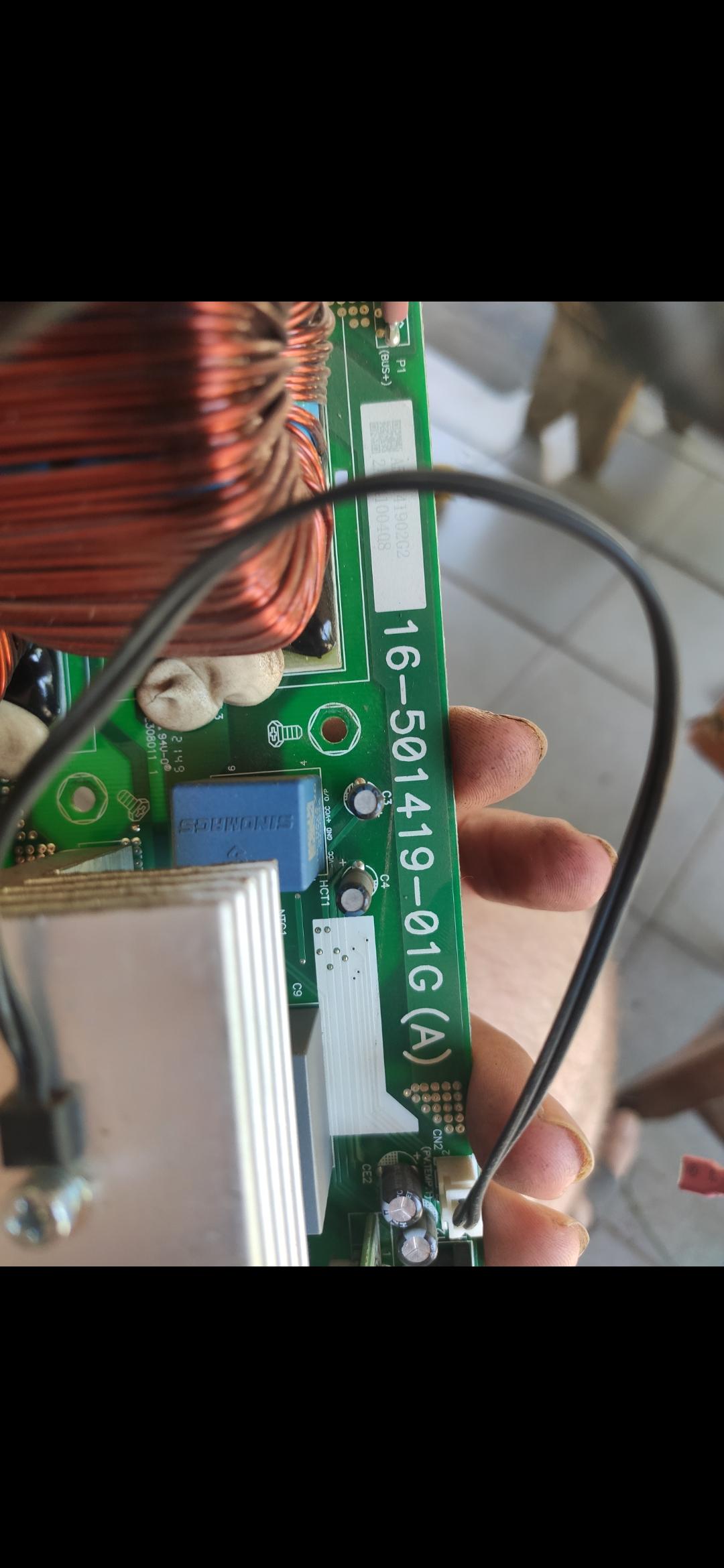

Help board supply solar connector remove
I don't understand this sentence.

Helper PSU board PV connector removed

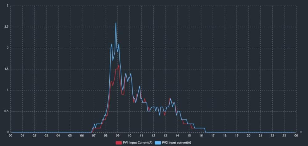

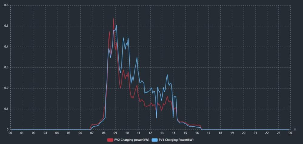

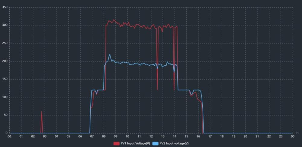

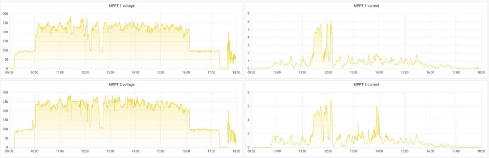

I have been testing firmware 372.66 for 5 days, and for me, there has been almost no change from 272.66
Since the exposure of my 2 strings is the same, the impact of such granularity is beyond what I'm able to measure with Solar Assistant.
Attached are 2 screenshots from 2 similar days on each of the firmware (Sorry, the weather hasn't been good lately in Brittany, France)
Basically, since the abandonment of forcing a fixed voltage like on firmware 92.06 at 200V, which, if I remember correctly, reduced it the most, the 90V blocking effect in the morning and evening is still quite pronounced.
Anyway, I'm a bit lost because personally, I can't concretely translate the impact of different patch threshold values on current and voltage just by observing the curves.
I have the vague impression, perhaps incorrectly, that the threshold value only applies to the descent, and even then, I'm not sure.
In any case, once again, a big thank you for your work! The premature float bug fix is invaluable
PS : 272.66 is the first and 372.66 is the second
Edited by sharkut

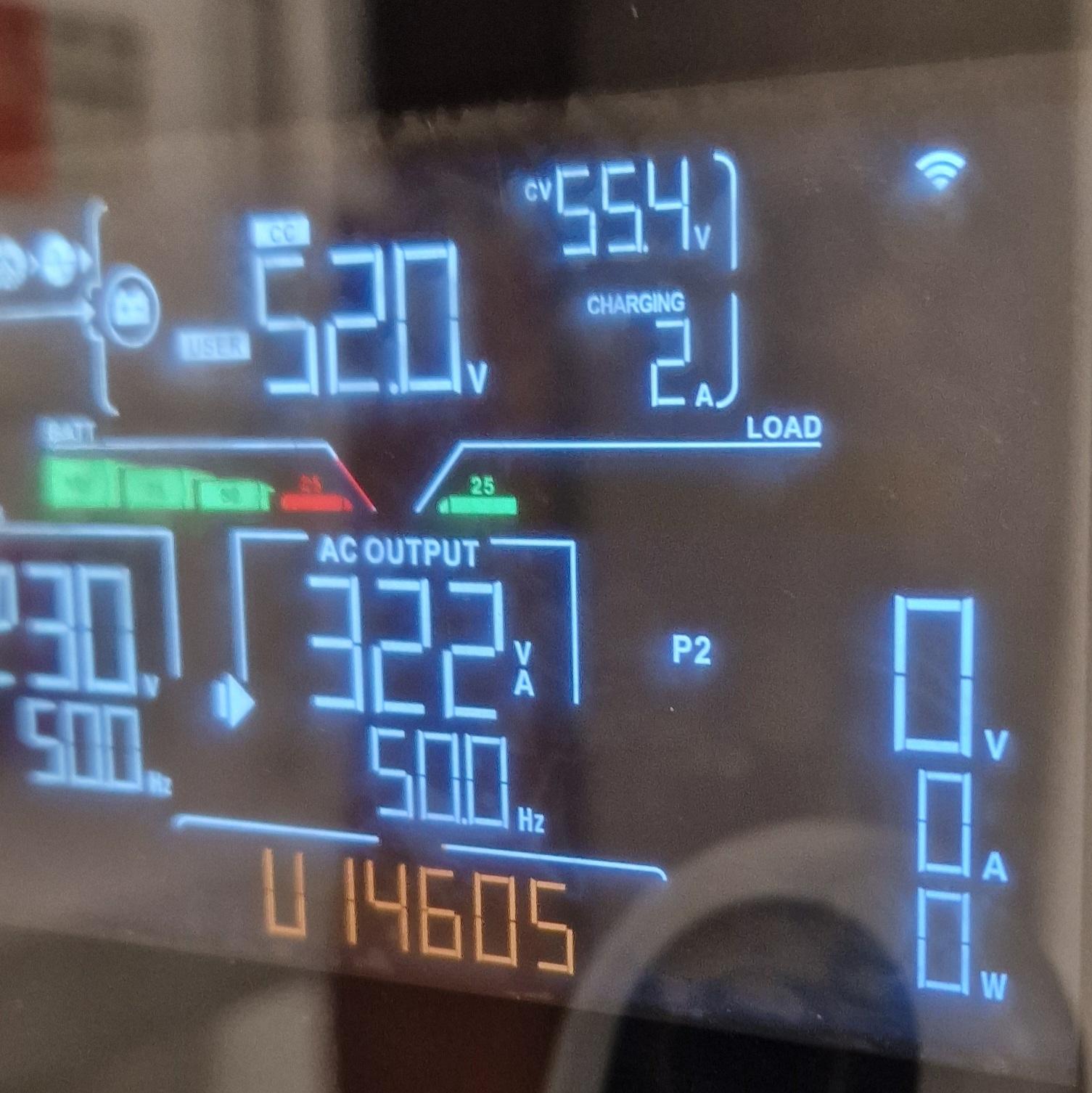

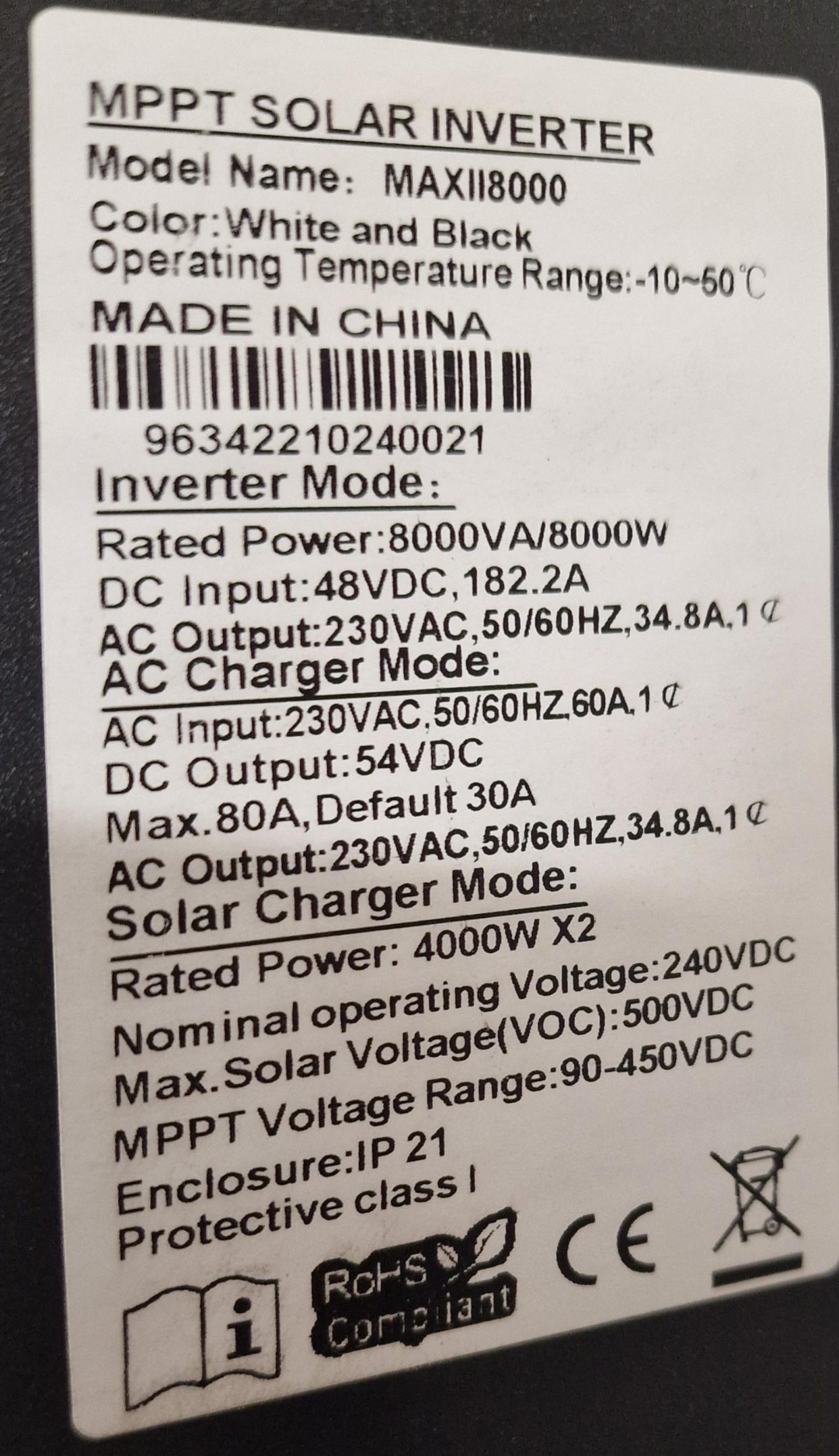

Ciao ho questo inverter in foto con 5 panelli 400W su MPPT1 e 5 panelli 400w MPPT2
ho il problema dei 90V, ho provato Firmware postati nei messaggi precedenti ma inverter non li accetta
i firmware ora sono questi:
U1 46.05
U2  22.12
come posso risolvere grazie

Hi I have this inverter in the photo with 5 400W panels on MPPT1 and 5 400W panels on MPPT2
I have the 90V problem, I tried the Firmware posted in previous messages but the inverter does not accept them
The firmwares now are these:
U1 46.05
U2 22.12
How can I solve it thanks
Please post in English on this forum.
It's hard to say what's going on with your clone. It seems to be running a Voltronic Max E firmware, but it's clearly a Max II. Any genuine unmodified Voltronic 46.xx firmware should accept the 90.06 based patched firmwares.
Which patched firmwares have you tried?
A few clones can't accept any firmware updates, but that was a long time ago; cloning technology has advanced a lot since then.
Here's my guess: The clone is using a Max E firmware (designed for removable displays) because Max II firmware was not publicly available until 2023. This clone is made in 2022, if they follow the Voltronic serial number convention. They may or may not have changed the firmware; if they changed the reflash command, then you will not be able to use standard Voltronic software, patched or factory. If this is the case, you will have to get new firmware from your supplier (good luck with that). If they have a version based on say 46.71, then this will largely fix the stuck at 90 V issue.
There is also the chance that you are not updating correctly. Are you using a USB to serial adapter? If so, what brand/model? There are many that simply don't work with the Voltronic reflash tools. Can you post the error message from when the reflash failed?

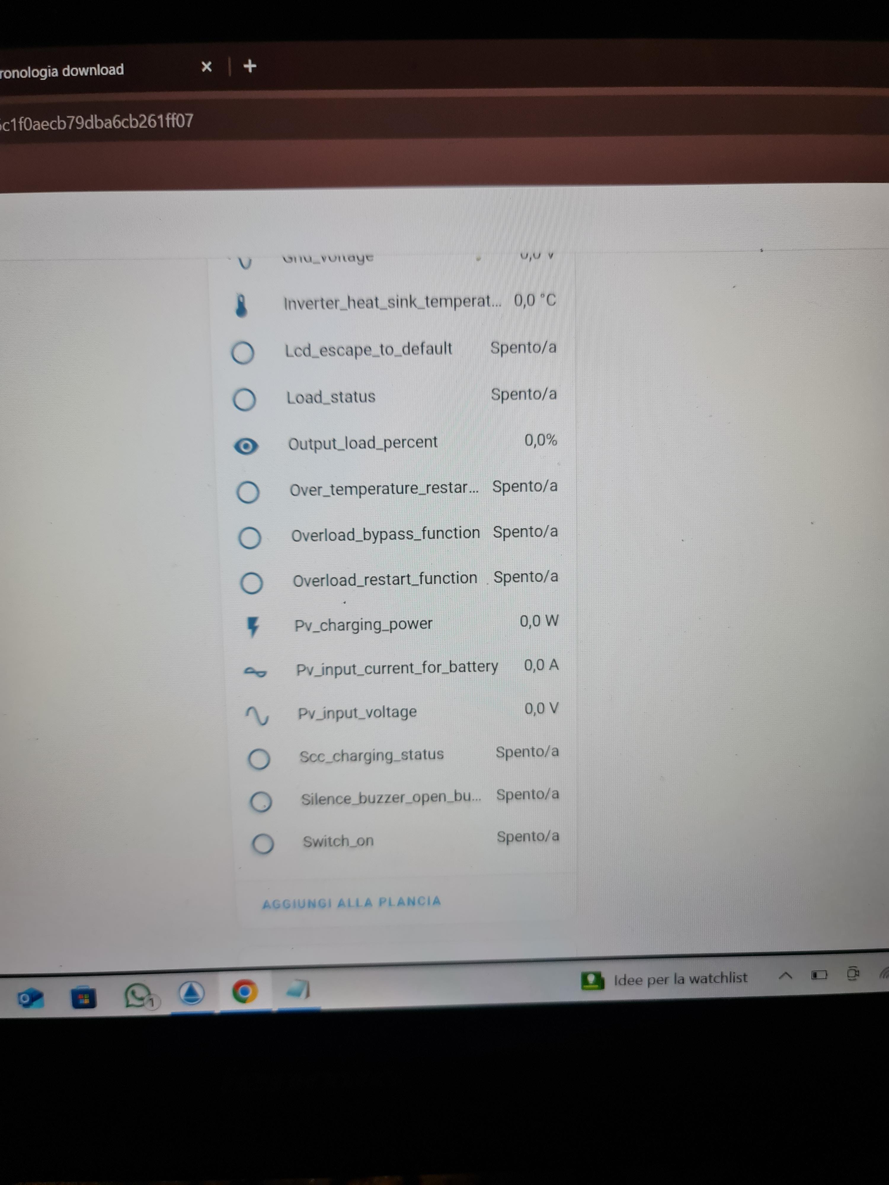

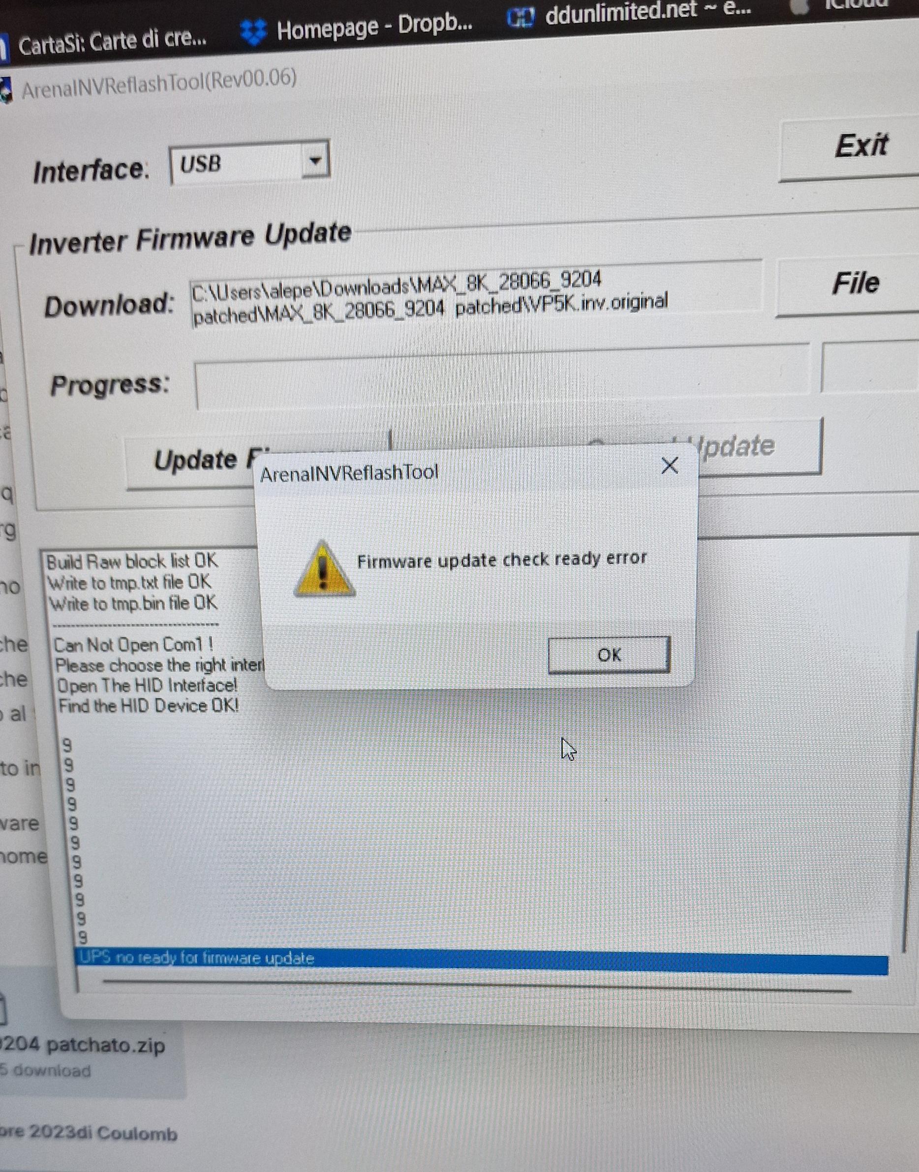

Ciao, scusa se ho scritto in italiano, oggi ho provato ad installare il firmware che allego nella foto ma purtroppo non ha funzionato, ho utilizzato un cavo micro USB

38 minutes ago, Tomeek said:
Don't do it!
usb-RS232 cable is required!

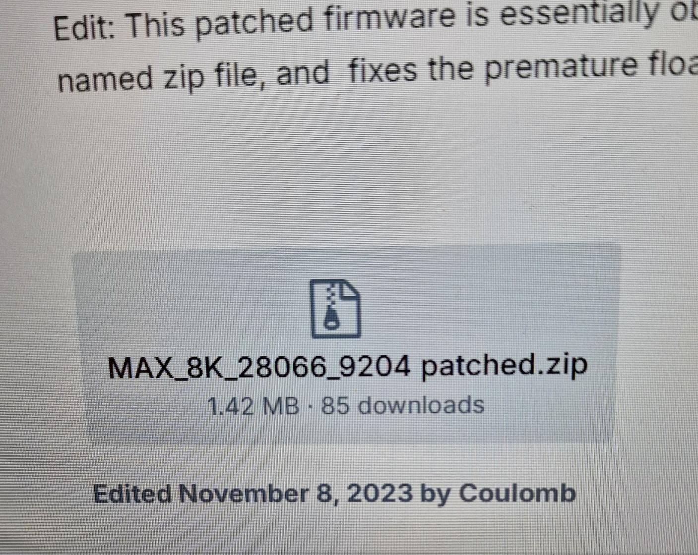

I used to believe that, but the models with '28066 processors have a newer reflash tool that has the USB option as shown above. My understanding is that with a suitable cable (e.g. USB-A to micro-USB), you can use this option and it should communicate directly with the micro-USB port in the removable display or the inverter. I've never done this, and I'm quite hazy about how it would work, but I believe that some readers on this forum have reported success.
That zip file has had some 85 downloads, so if there is a problem with it, we should well and truly have heard about it by now.
@Ale70, you have posted in Italian again. Even your quote of my post comes out in Italian. Please sort this out.
Are you sure that your inverter has a '28066 DSP? The best way to know is to check the presently working main (U1, DSP) firmware version. Note that the 9x.xx firmware versions are all over the place. If your present firmware is 72.xx or 91.04, then you have this processor. Otherwise, please report what you have.

On 2024/12/15 at 10:30 PM, Artur said:
If you check the marking of the mppt board, it coincides between the 8 and 11 kilowatt versions.  check the low-voltage transistors on the battery and they match.  .  The only difference is in the marking of the sine cut transistors.   It's just that I have a 5-kilowatt solar field, and in the 8-kilowatt version, the limit is exactly 4,000 watts.  Therefore, if someone asks for 8 by 11, write.
8kwt аксіома працює на прошивці від 10квт моделі, але значення які видає інвертор при навантаженні не відповідали реальним і були завищені, але по сонцю 5квт інвертор вибирав.
