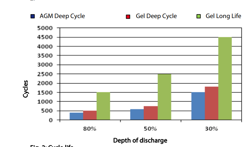

Deep cycle Lead Acids all seem to have the same sort of cycle life, i.e. +-500cycles at 80%dod going up to +-1000 cycles at 50% dod
I would check out the battery manufacturers spec sheet before you get your lifespan hopes up too much .
