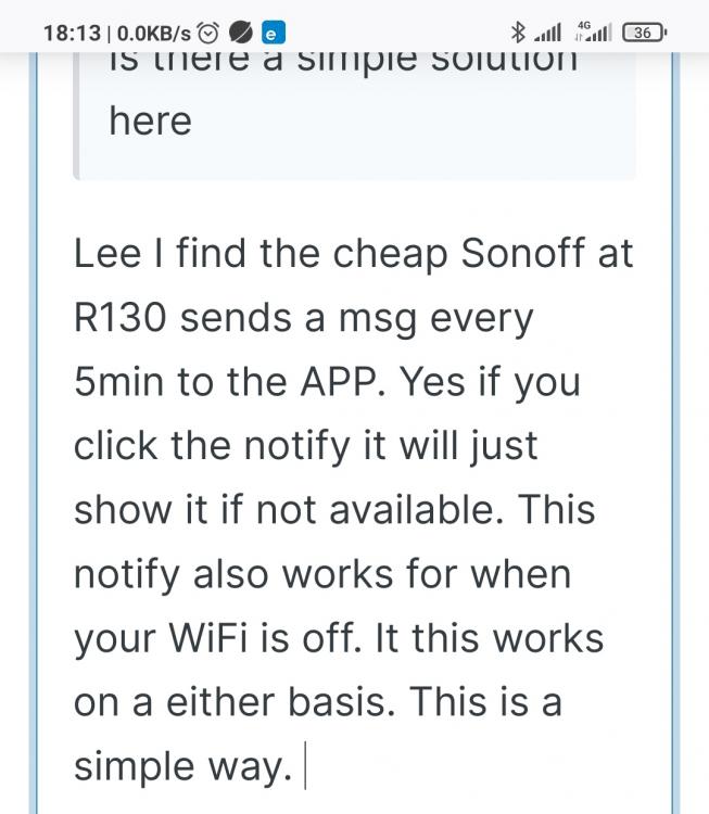

Lee I find the cheap Sonoff at R130 sends a msg every 5min to the APP. Yes if you click the notify it will just show it if not available. This notify also works for when your WiFi is off. This works on a either basis. This is a simple way.
Do mention when you have LS the unit is not off but only not available. Just move it to a circuit that is OFF when you have LS.
May be I am missing what you want notification for.

Scenario 1 is ideal for a basic Sonoff that can alert you provided it is connected to a always on WiFi. This will provide you with a notify as per the blue icon at the top in my picture.
Scenario 2 can be achieved where a relay is connected on the output of the Sonoff connected to scenario 1. Use the normally closed contact of the relay to power up device B. Thus when device A is switched off only then can B be powered. As soon as A is on it will switch B off.
During LS A and B will be off. See A as the master and B the follower.
