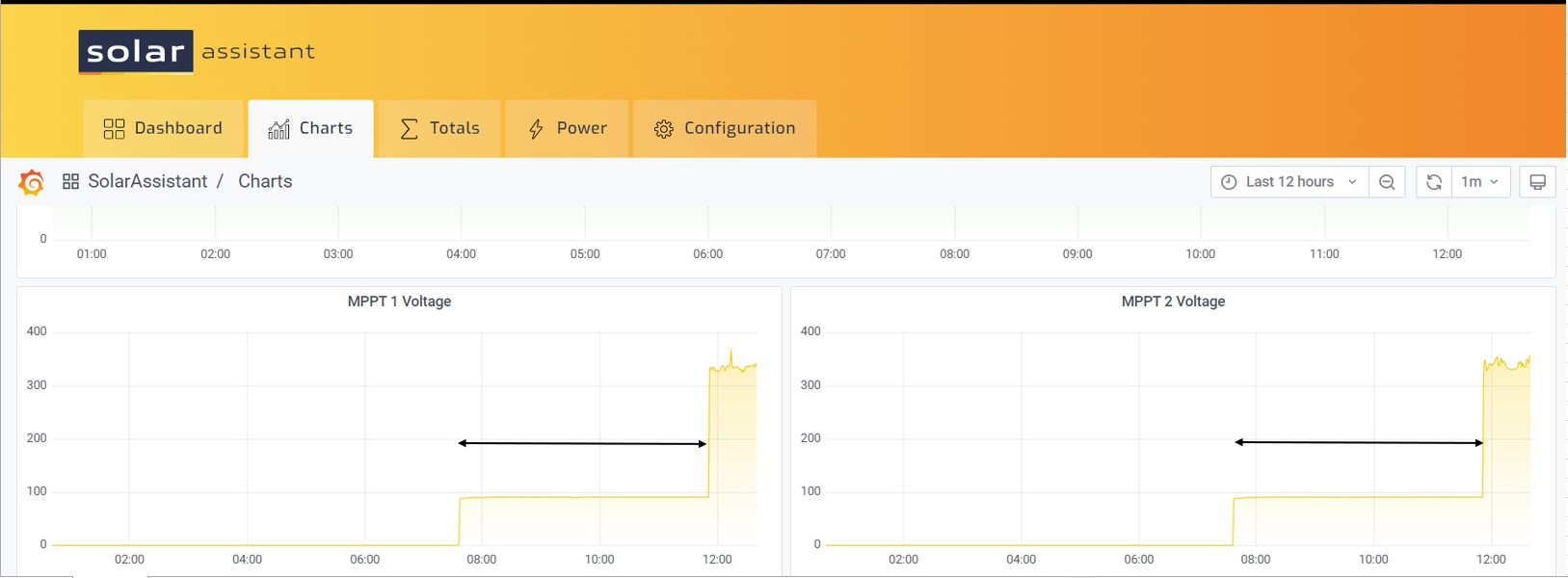

Hi all
Im a newbie here, so in case that I have opened topic which have been discussed here sorry for redudant theme but I couldnot find much info about my Axpert Max II, 10kw - probably its not so widespread model yet. My inverter is original one.
I have same problem like other colleagues - during summer time invertor has been working great(from the morning till the end of daylight) but now in the fall(cloudy weather etc) Im struggling with issue that invertor is showing around 90V on both strings. When I will turn off output power(by pressing the button under the big display)  and that turn that back on the value of PV1 and PV2 voltage sudenly increase to 350V and invertor is starting to produce much more power from solar. It will be probably same firmware bug like on previous versions
Does anyone have patched firmware for my invertor type?

So, I have tried to flash 90.01 fw but I was not succeeded. I have choosen right port(COM4), turned on Axpert, disconnected PV and turn on output voltage, than start flashing but after confirmation that Im sure to flash on display appeared info about fw upgrade and nothing had happened. I couldnot confirm YES message on display by any button - they did not react. Any recommendation how to confirm flashing?

The "90V problem" annoys me a lot, it now leads to possibly 60% less PV energy in winter...
Yikes. So that's hardly negligible.
I'm having a bit of patch fatigue (laziness?), and I have this theory that maybe we don't need all of Georg's patches, and maybe the current threshold to stop clamping is really all we need. So as a compromise, I've patched 56.05 with only one "stuck at 90 V" change, and only to MPPT1. That allows comparison with MPPT2, for those that have similar PV arrays connected to MPPT1 and MPPT2. Or you could disconnect the array from MPPT1 and connect it to MPPT2, and the weather hopefully changes little in the 5 minutes to make that change safely.
If I'm wrong, I'll do the full patch set. If I'm right, I'll just patch MPPT2 the same way. Either way, this will be a temporary patch.

Please test this patched firmware, and if possible, compare performance of MPPT1 and MPPT2 on a cloudy or otherwise poor PV day.
