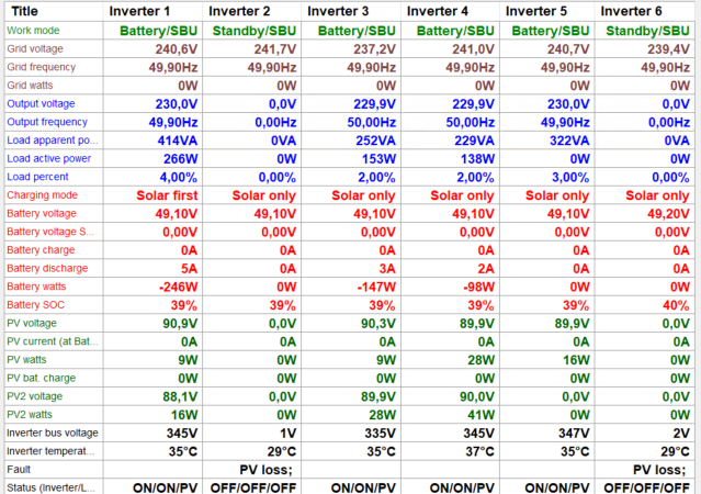

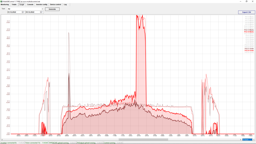

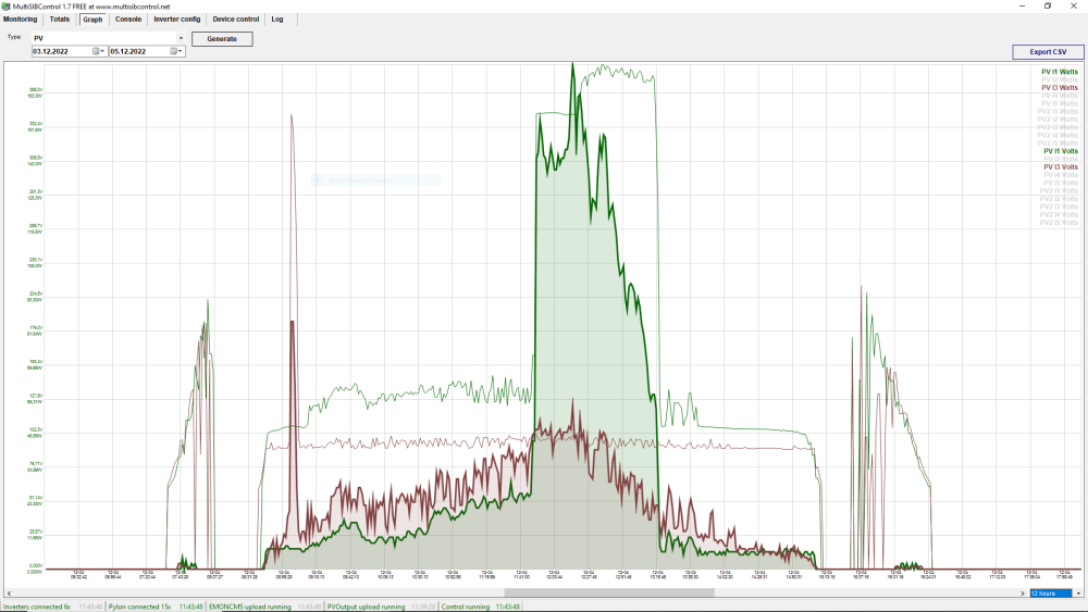

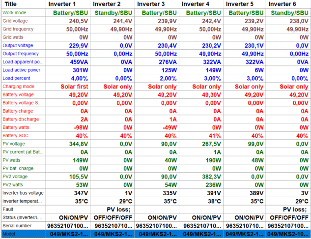

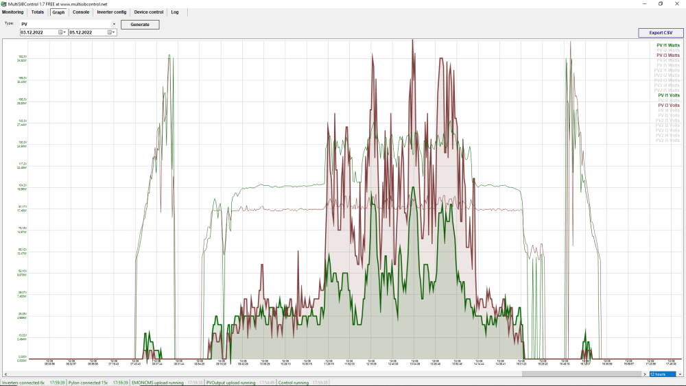

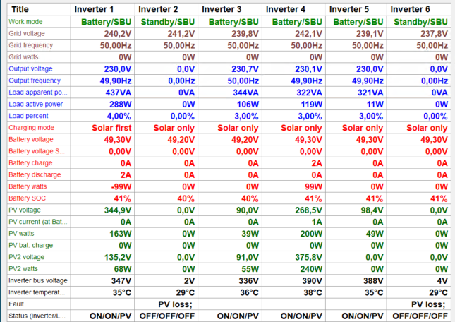

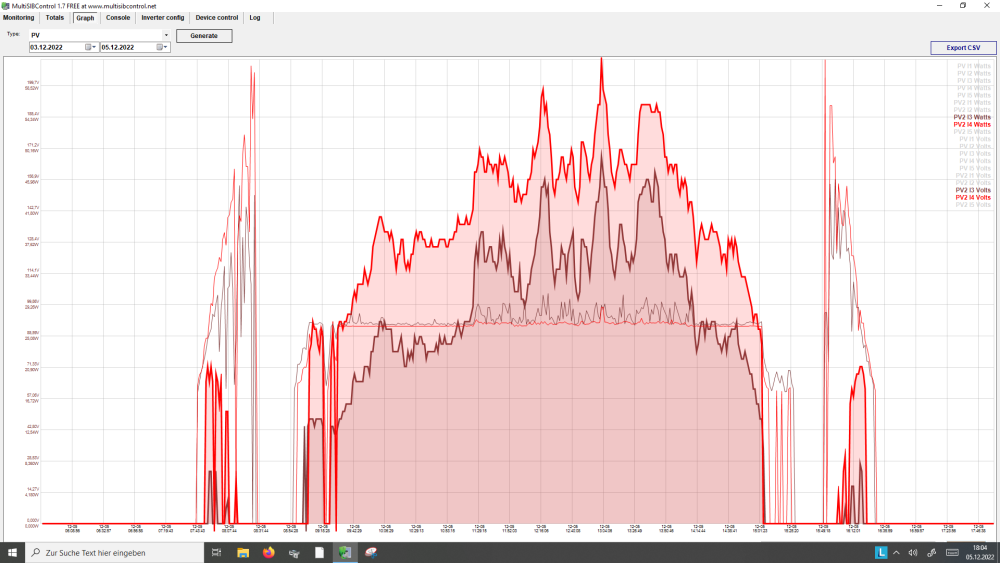

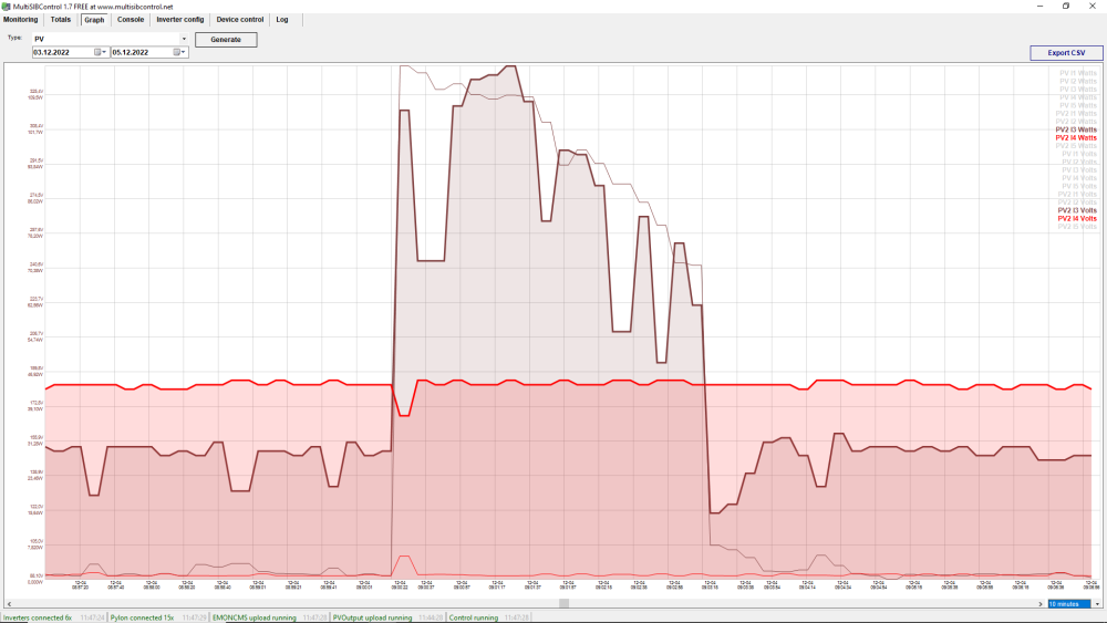

Please test this patched firmware, and if possible, compare performance of MPPT1 and MPPT2 on a cloudy or otherwise poor PV day.
The minimum changes to get it work as ist should is:
1 . The 90v limit rise to 120v.
2. The subtraction value down to zero.( @Coulomb you know what i mean )
The other tweaks are just for smoothing the regulation.

I'm still new to the forum here, but very impressed with how far the participants have "explored" with the firmware and hardware!
     Patch location 2: 0x3E3175: 5232 -> 5205 Cmp AL,#50 -> Cmp AL, #5
The change only affects the comparison value. Since I haven't read enough in the forum and don't know the code, I don't know what exactly the comparison does??
Without having deep insight (!!), I would recommend making the start value of the MPPT controller variable, so that one could adapt to Voc of the PV field. voltronicpower would of course be responsible for this.
Unfortunately, the MPPT control seems to be programmed somewhat "simply"! Actually, the "clamping" to 90V should not happen at all...
Greetings from Northern Germany
(I have some snow on the PV panels)

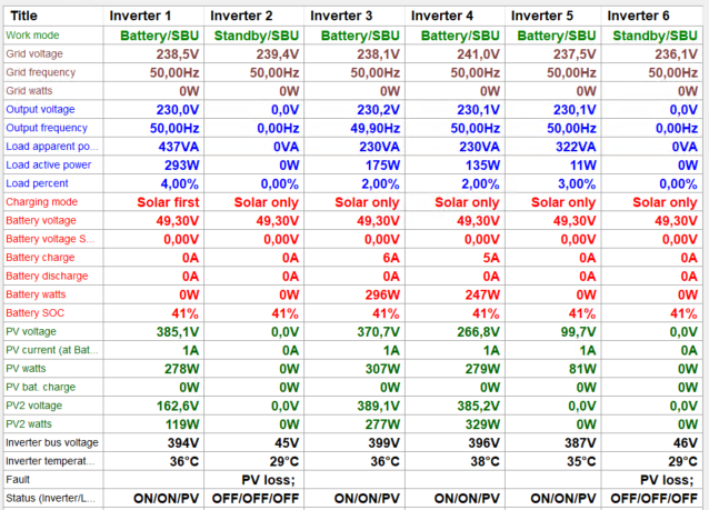

Short interim status: I have only flashed the update in my inverter 1. Inverter 2 has an identical PV field at PV1. Since I have restarted everything and it is shortly after noon, the MPPTs are not stuck. I have to watch it - it will be dark here in 4 hours. I don't see any difference yet...
Next:I quickly skimmed the code. Of course, I only understand it partially - my wooden relays don't switch so quickly...
The patch makes sense. I think the value has to be only slightly larger than the measurement error. It could be that they set such a high value because they don't trust the current measurement.
48 minutes ago, Volker said:
I suspect that this is a bug: solar PV can get stuck
.text:003E317C           ; with about 99V PV and just under 0.5A
It works - great + thank you - I have no more words for my joy.
The difference here is Inverter 1 PV1 (new firmware) 163W to Inverter 3 PV1 (old) 39W.
Inverter 5 PV 1 also jams but around 99V - this often happened before, also with other PV arrays. Are you right: "I suspect that this is a bug"? image.png.327d454af34e8a840339c58d88e9402d.png
1 hour ago, Coulomb said:
So I guess my minimalist patch is doomed to fail.
It works to my satisfaction! No problems with the update and 3 to 4 times more watts in the moment.
Please also patch the MPPT for PV2. I am very grateful for your efforts - great.
That's quite pleasing. Though this is the best case scenario for demonstrating the bug: in the first set of data, the PV current is 0.47 A, just under the 0.50 A threshold.

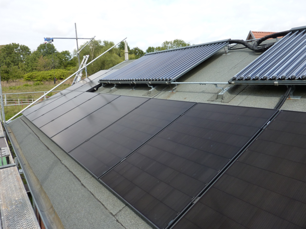

The following PV fields are connected (alignment approx.):
Inverter 1 PV1 10 modules, almost horizontal, only 7° WSW
Inverter 1 PV2 4 modules, 35° WSW
Inverter 3 PV1 10 modules, almost horizontal, WSW
Inverter 3 PV2 10 modules, 35° ONO
Inverter 4 PV1 7 modules, 35° WSW
Inverter 4 PV2 10 modules, 35° ONO
Inverter 5 PV1 8 modules, 40° S
So two times 10 modules can be compared. I mounted all modules flat on existing roofs.
The picture shows the 4 and 7 WSW modules (during installation):
Now it is getting dark outside:

Have set myself a test strategy now:
OG-10 DSP Reflash_156.05 patched in to Inverter 1 and 5
OG-10 DPS Reflash_5606 patched in to Inverter 4
Inverter 3 stays on the original version as comparison.
It will take some time to make statements. We know that the original version is not good.
If I could make a request to you both, a file in the directory with the info would already be good (so I could also keep track). That way it would be perfect: see txt-file
This would also support my learning process...
Best regards

compare the patchs, Georg594 and Coulomb: Inverter 1 PV1 and Inverter 3 PV1
compare Coulomb patch with the Original: Inverter 3 PV2 and Inverter 4 PV2

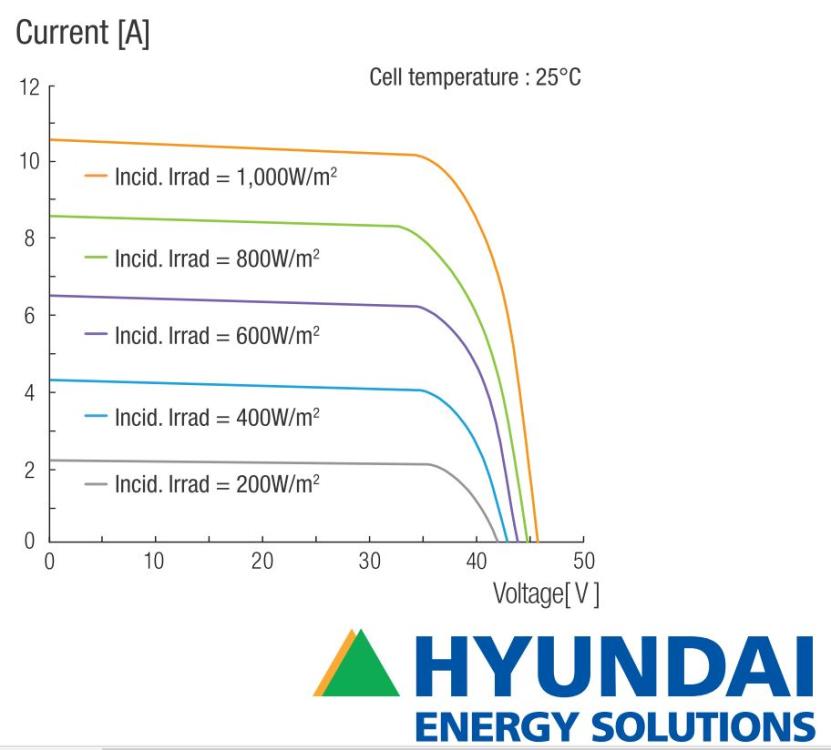

From this I can already conclude that no firmware finds the optimal MPPT operating point at low PV power.
If you look at the curves of the PV modules, it would be better to have a fixed adjustable voltage for each PV field than a bad MPPT algorithm...
Let's wait for the results in the next few days.

On 2022/12/02 at 3:17 PM, Coulomb said:
Done.
After two days there are results.  I will explain some of the circumstances of the PV system in advance and then interpret the diagrams only briefly. Please write what you think about the values?
Today, on 5 December, from about 9:00 to 10:00 a.m., I changed my router (copper to glass) and the PC also had to be restarted - please do not pay attention to this time.
The diagrams always show the two comparable PV fields. Bold is the power and thin is the voltage.
Please note: The sun is about 25° above the horizon at noon. But we have a completely grey sky, little light penetrates the thick cloud cover and today there is fog and later rain. There is only indirect light and no rapid changes due to clouds. Therefore, we should expect a steady rise and fall of the power curves.
The following can be compared:
a) Georg594 patch with Coulomb path: PV1 I1 and PV1 I3 (green and brown)
b) Coulomb patch with the Original FW: PV2 I3 and PV2 I4 (brown and red)
The PV fields have the same structure, but due to the low position of the sun, there is still a considerable amount of shading caused by trees.
I can see this:
1. The "morning and evening hole" must not exist. But you can see them every day on every PV field! If the MPPT controller were to work correctly from zero point, the output would have to rise and fall again continuously in these weather conditions. Of course, it will also wriggle more at low power levels, and the controller cannot work optimally close to zero...
2. The "peaks" show that much more power would be possible if the algorithm did not hold the voltage!
3. georg's path (green) in diagram "2022-12-04 Inverter 1 and 3.PNG" also shows what would be possible if the MPPT controller could be freed from its "Voltage hanging".
Two grey tags are of course only a small sample. But I can see that the problems are in the algorithm.
The changes can give an improvement under certain conditions, but the PV voltage will also be limited to values that are definitely too small. I see no reason why the MPPT controller leave power unused. Only with more PV power, everything works. With less light, optimal use would be important for me. The developers have obviously only tested in sunlight...
I have only skimmed the code so far. Can you find out why the voltage is held?
Can you find this point in the programme and then change it?
Best regards to both of you
Volker
