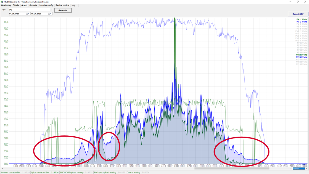

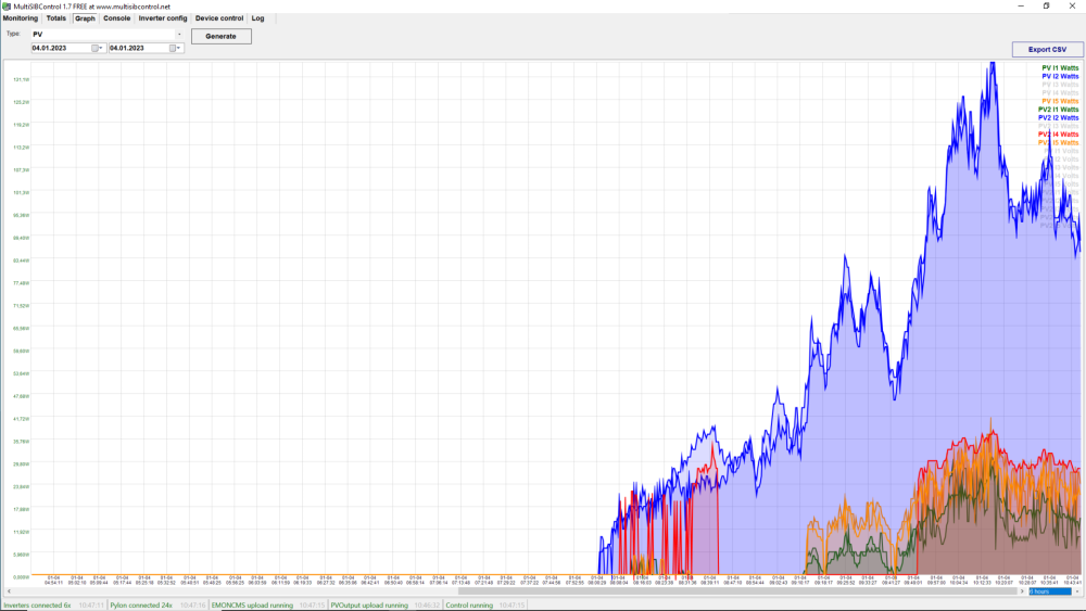

2 hours ago, Volker said:
Attention - Attention - Attention
When the SOLAR cable is disconnected at the SPS, EVERYTHING changes!
The two blue curves are the inverter with the cable disconnected!
Red is the original firmware, otherwise all on version 656.05.

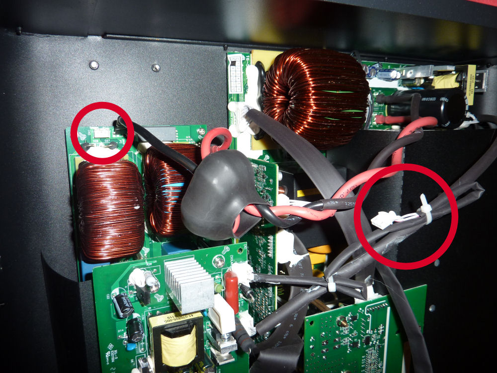

I disconnected the SOLAR cable at the output of the MPPT board. I wanted to avoid a cable with 400V that was not connected at other end. The cable was secured with a cable tie (see picture).
I have modified 3 inverters. One inverter has the original firmware, so I will see tomorrow if the 90V error occurs.

Green: original condition
Blue: SOLAR cable disconnected

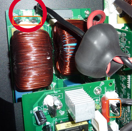

I'm having doubts about this now. Looking at some photos, CN5 (where the cable in question connects to the SCC/MPPT board) seems to be connected to BUS-, the thick black wire that runs off to the main board. That's the output of the MPPT. Though there seem to be medium current diodes (3-6 A) near either end of the cable in question. So confusing.
Edit: It might be useful to know if these are ultra-fast diodes (often with part numbers starting with UF), or slow, DC diodes. Outlined in orange:
Can you see that this cable in fact has BUS+ and BUS- on it? I guess that makes some sense. And my idea that this connector has HFPW+ on it is looking very unlikely. The fact that it is a 3-pin connector with the middle one unused suggests that there is high voltage, and they are increasing creepage distance this way; that would only be needed if the cable carried high voltage between the two conductors.

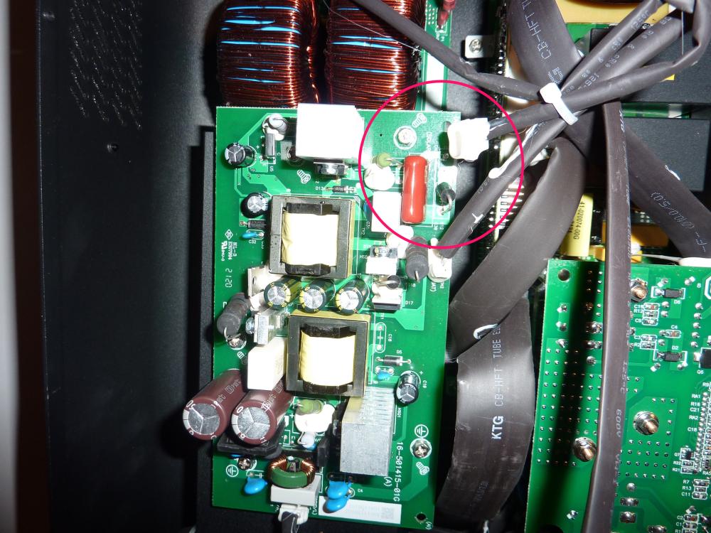

The reason for disconnect the AC plug is when you disconnect Solar it pulls constantly around 60 watts from grid , in every situation and every mode (usb,sub,sbu) .
To originally avoid this there is a priority logic (in hardware)on the help supply so solar prio1 , ac prio2.
So if you don't disconnect both the grid meter shows around 1.5kwh per day.
Are you shure with bus - and bus + ?
Mine has 2 diodes ( pv1+ diode + pv2+ diode , the other wire is pv -.
I testet it on mine and then the inverter was not able to switch of because of the information from the 4 pin plug on the help pcb is : stay on .
Ah, that makes more sense. I'm guessing that PV- is commoned to BUS-. So it only takes power from whichever PV input has the highest voltage at any instant. It must be confusing to the MPPT logic, especially in low light conditions, to suddenly have 40-60 W of load come or go. This could well be the core of the problem. Say the algorithm decides to lower the voltage, but it's now 20 W below the maximum power point. It measures the PV power, and finds that it has gone up. Not because this is a higher power point, but because the power supply's 40 W is now being supplied by the other PV panels on the other MPPT port! So it rewards that bad behaviour by lowering the PV voltage again, reducing power further.
But that would mean that this is exclusively a MAX problem, with its dual high voltage SCCs. Or at least a lot worse on the MAX models, especially if the number of panels is roughly equal on each MPPT. As they often but not always would be. Perhaps you owners could keep a lookout for that behaviour?
I imagine that the power supply's load would be very roughly constant. So it might be possible to take this effect into consideration. Taking out the plug from the Solar power supply means that the power for the main power supply has to take a longer, less efficient route: through the SCC(s), via the DC bus to the DC-DC converter. That's 2 conversion steps,  potentially going up then down in voltage, compared to just one step for the Solar power supply. Add one more step for the output of the main power supply, so then it's 3 steps (PV -> bus -> battery -> output) versus 2 (PV -> battery -> output). I assume that the solar charge controller board's gate drivers and logic run off the 48 or 60 V (battery) bus.

I also think it is a connection to the bus. I measured 0 Ohm between MINUS-SOLAR and MINUS-BUS.
The inverters are mounted on the wall, it is difficult to measure when holding the cover with one hand. I should probably take an inverter out of parallel operation and run it on the table in the workshop....
But that would also be the case for my latest presumed arrangement:
Perhaps you could verify by finding about 0.4 V drop from PV1+ or PV2+ to Solar+.

Have you connected the SOLAR cable behind the two diodes?
Unfortunately, I still don't know why the inverter switches off when I disconnect SOLAR and GRID from the PLC. Minimising the consumption would be good...

I cut off the two small wire from mppt board and adapt them to the two big outputs from the mppt pcb .
But this let the inverter run constantly and like coulomb said triple energy conversion losses .
