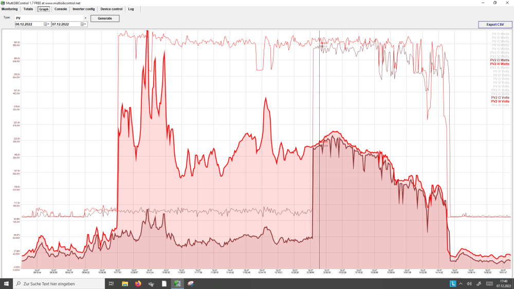

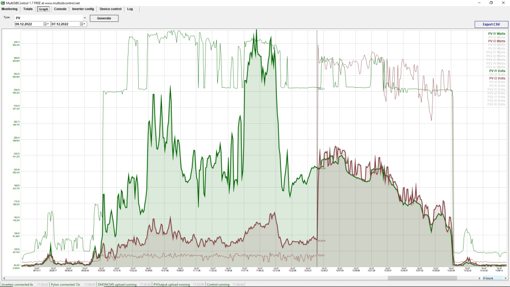

I forgot one more important hint: The two peaks (Inverter 3, no patches) in yesterday's charts are exactly at 9:00. On this day and time, the inverter switched from grid to battery mode. The switchover was no longer active today.
Edited by Volker
I can't think why switching modes makes any difference, except that it might somehow "reset" the power tracking code somehow.
My patches are obviously inferior, but clearly even Georg's aren't doing all that well in these conditions. His tends to spend a lot of time at 120 V, mine at 90 V. Clearly, once it gets into that state, it finds it hard to get out, unless or until there is a burst of PV power.
I'm tempted to try a patch with Georg's patches, plus every minute or so forcing the target voltage to a high value, perhaps the maximum MPPT value. The tracker seems to have no trouble going down in voltage, so it should not take long to get to a sensible voltage setting. This would be a very crude form of "scanning" for the MPPT.
I might go hunting for the code that might be resetting the MPPTs when it changes to battery mode. That might be appropriate code to call or to copy and run it every minute.
[ Edit: Added "in these conditions". ]

The power tracking can be restarted by the following methods:
- Inverter is switched from grid to battery mode.
- Inverter changes the power balance strategy.
- The PV field is disconnected by hand for a moment and then reconnected.
I had already considered an hourly switchover as an emergency solution...
The power then actually always increases by a factor of 2 to 4. If the PV current is too low, however, the reading quickly falls back to the previous value.
On 6 November it was overcast again, but there was a little more light.
On 7 November at 12:41 I disconnected and reconnected the PV fields of Inverter 3. In the diagram "2022-12-07 Inverter 1 3 4 5.PNG" all PV fields are shown and the time is marked (orange is the field with south orientation). The day started with snow on all PV fields, but it disappeared quickly. It was often sunny until 12:15, then it was grey like the previous days.
Georg's firmware starts early (this is its biggest advantage), but it does not use the power well with small brightness fluctuations (see "2022-12-07 Inverter 1 and 3.PNG" time 12:41+.

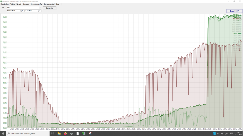

The picture from 12 December shows Georg's version in Inverter 1 compared to 156.05 in Inverter 3 and the pictures from 13 December show Georg's version in I1 compared to the new version 356.05 in I3.
The changes cause a complete restart of the MPPT algorithm at 450V. Therefore the found optimal PP is always left. However, I think the MPPT controller works fine at higher voltage values.
Therefore, it would be better to restart only when the voltage is below a certain value (e.g. 175 V) and then start the restart in a medium range (e.g. 200 V). Then the power drops would no longer occur (see pictures A and B from 13 December).
Of course, it would be even better to examine and adjust the algorithm directly. But the proposed solution would be a good compromise.

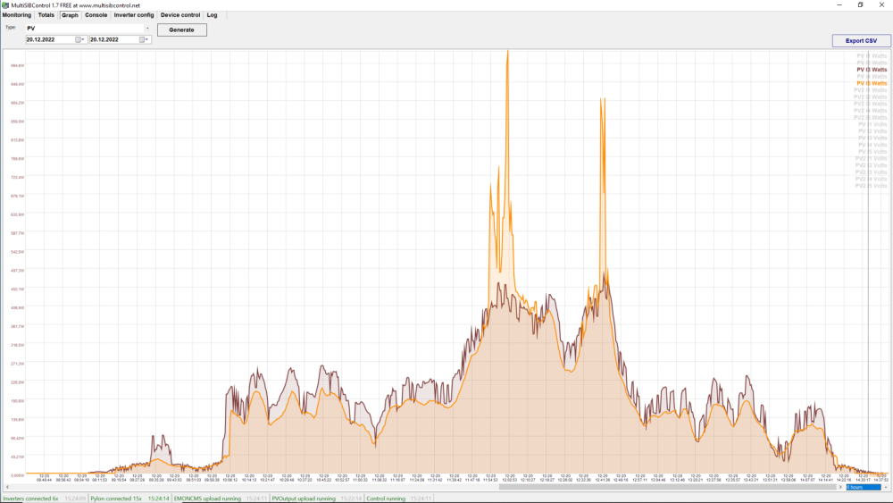

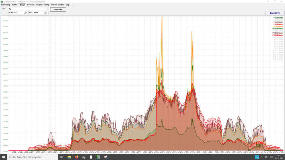

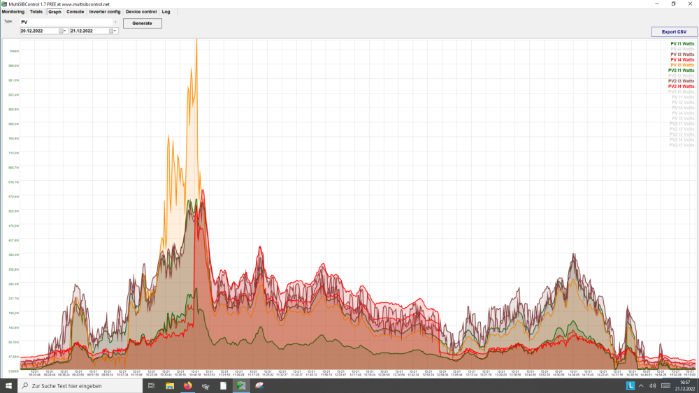

3 days ago, snow and ice thawed away due to a warm rain. As I could not fully interpret the results yesterday, I waited for another day and yesterday the forum did not work…
The inverters have been running with the following firmware since then:
QVFW
(VERFW:00056.06 [Inverter 1, by Georg, green in the diagrams]
QVFW
(VERFW:00465.05 [Inverter 3, brown in the diagrams]
QVFW
(VERFW:00056.05 [Inverter 4, original, in the diagrams red]
QVFW
(VERFW:00465.05 [Inverter 5, in the diagrams orange]
Notes:
a) I1 PV1 is comparable to I3 PV1, but I3 PV1 has more shading from the south by trees (10 modules each, to the west, but almost horizontal).
b) I3 PV2 is comparable to I4 PV2, but due to the orientation the sun cannot shine directly on it (10 modules each to the east).
c) I5 PV1 almost south and receives direct sunlight from noon onwards (8 modules)
d) I1 PV2 same direction as I3 PV1 (but 4 and 7 modules and different shading)
e) At the winter solstice the sun is at 21.5° at noon! In the last two days there were only very short periods when the sun was visible through the cloud cover - almost only indirect/weak light.
I'll keep the interpretation short, please do it yourself:
The comparison between I3 PV2 and I4 PV2 is simple: the original software is poor, but it regulates much more "smoothly".
With I1 PV1 to I3 PV1 you can see that Georg's version can still "hang on". But his curve is very smooth. Whether the "shadow adjustment" remover is good or not, I don't know (yet).
I think the latest firmware flutters too much and this causes losses. Surely the last change should have prevented it?
With the latest firmware I would have expected no flutter behaviour (I3, brown curves, PV1 and PV2 each 10 modules)!?
