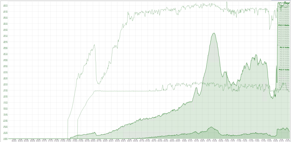

Here are graphs for today, a very beautiful and sunny day from morning to evening with the mention that the sun rises at 8:00 AM and sets at 17:36 PM.
Coulomb, which firmware would be the most suitable for me considering that I have two strings of 10 Canadian solar panels 455W with Voc 41.2 (412V / string)
P.S.What does the 150V mean? Is it not the voltage from which the mppt starts or did I understand wrongly?
And is there for the 11 Kw Inverter firmware of 150, 180, 200,280,380 and what would be the difference?

Unfortunately, it's not something I can predict in advance. Since these patches don't truly cure the problem (only Voltronic with the source code and extensive lab equipment can do that), it's a matter of trial and error.
22 hours ago, ClauBebe said:
P.S.What does the 150V mean? Is it not the voltage from which the MPPT starts or did I understand wrongly?
It sets the minimum value for a firmware variable that represents the set point for the MPPT voltage. In this context, set point means the point that the control system is aiming for. So if that value is 150.0, then the MPPT won't ever be aiming for say 140.2 V, even if that is the true Maximum Power Point (MPP) for the present conditions.
Starting is sometimes different to running, but with Voltronic's firmware, they don't seem to do anything special for starting, apart from forcing the MPPT voltage set point low under some conditions, and ironically, this seems to be the crux of the problem. Too often in cloudy conditions, it's acting as though the sun is extremely weak, and it has to drive the panel voltage down to extract enough power from that very weak sun to get everything started. It has no memory of operating at 90% of rated power two minutes ago, for example.
