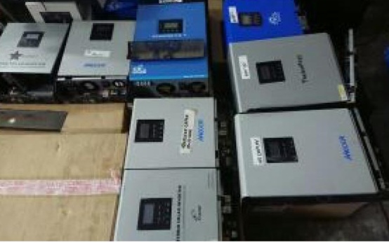

Pity i am in Gauteng i fix a lot of inverters up to 12kva1110080946_Inverterrepairsbypinepienaarinfo.jpg.f14c88f991205f94189e4ba8b006aa09.jpg114355.jpg.c2eb092604c11f8906aad5c28676004c.jpg

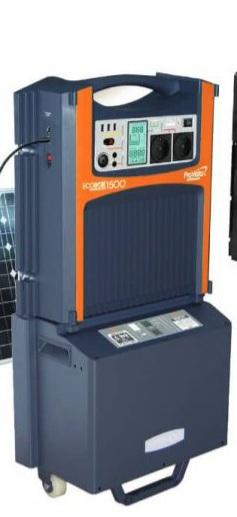

Good day
I have an Ecoboxx 1500 inverter that does not power on.
How can I get hold of you?
11 hours ago, itz_ben said:
Good day
You can pm me with your phone number then we can discuss. Maybe just check your battery for voltage as i suspect these units was sold with lead acid batteries.
