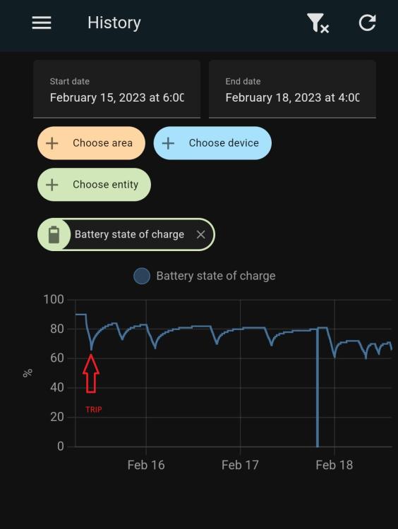

The problems started about 1 week ago when the Inverter tripped with the error F56 DC Low Volt when it was under load. Since then, the batteries haven't wanted to fully charge, even though there have been enough opportunities to do so from the grid (Setting is to charge them to 90%, Grid charge amps 60A).
SoC gradually decreasing:

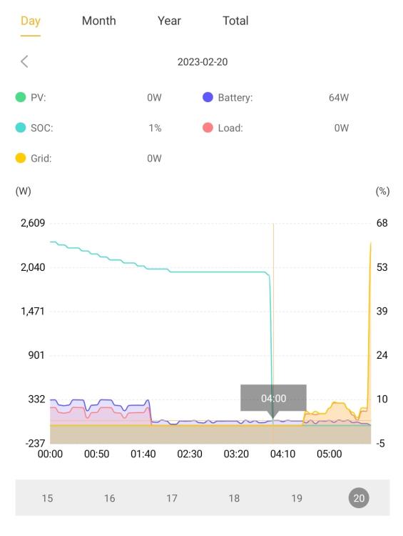

Yesterday, I woke up to the batteries reporting 1% SOC according to the inverter, with the 'Master' battery making a clicking noise repeatedly (Cycling On / Off / On / Off permanently), and both batteries refusing to charge.  (Click link for video).
SoC dropped from 51% to 1%

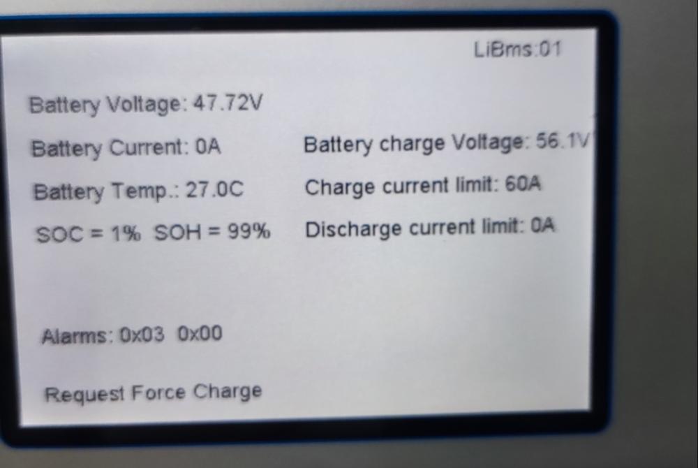

Readings from Smart BESS appear to be okay, with both batteries cell voltages appearing 'okay' (All cells report between 2.98v and 3.02v), with both SoC values being 0, and voltage of 1 battery at 49v (The tripping one), and the other at 51.3v (The original 'slave')
The inverter LiBMS screen shows a fault code 0x03, and 'Request Force Charge' (The battery manual doesn't mention this value in the fault code list).

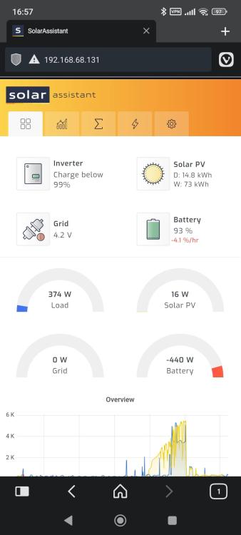

Oh NICE, the sun is hitting my panels!
OH, but the load is coming only from the batteries because they recently hit 100%. And of course, there's no way to stop charging from PV at 99%.
