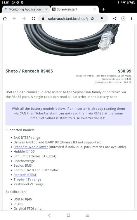

April 6, 20233 yr There is a Shoto specific cable available on the Solar-assistant shop. I also found the values coming from inverter to be unreliable with a totally different setup. Purchasing the correct cable to connect battery to Raspberry Pi solves that issue
April 6, 20233 yr Author I’ve got SHOTO batteries https://solar-assistant.io/shop/products/shoto so this is the one that goes from the SA to battery right

April 6, 20233 yr 1 hour ago, Raiden2912 said: I’ve got SHOTO batteries https://solar-assistant.io/shop/products/shoto so this is the one that goes from the SA to battery right Is your battery on this list
