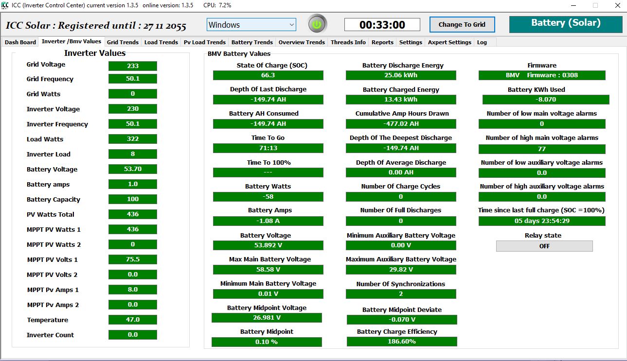

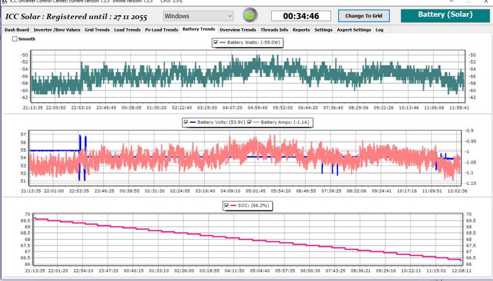

    Hi @gabriel, There seems to be a problem with one of your reporting devices, either Axpert or BMV is lying and I am beginning to suspect the BMV (because we all know that in an Axpert/Victron env
  • pilotfish
    pilotfish
    Remember that the BMV will probably report 100% when you remove and restore power because it must start somewhere. Make sure that your Axpert reports full voltage and 100%, then sync the BMV and even
And yet no change to BMV amps...
Check through all your BMV connections CAREFULLY, if no fault found then remove power from the BMV and reconnect to see if it comes right.
If you want to be absolutely sure then switch of AC and PV inputs to the inverter leaving only battery, at your current load you should bu pulling close to 10amps from the battery.
