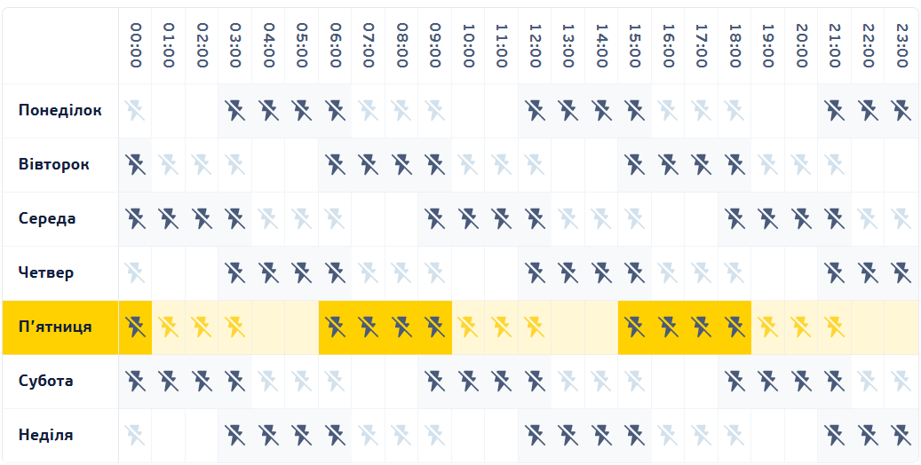

Thanks again! Fortunately, we have a schedule for electricity supply.image.thumb.png.1e29b90030982579bcbf657ba47215f9.png
As a South African who's dealt with load shedding, I feel your pain. At least we understand why we have power problems (lack of maintenance, lack of added supply to meet growing demand). In your case I have no idea why this needed to happen (Land grab? In modern times? What the heck! My neighbour has a nice house should I walk into there and take it?). It's insane.
Anyway I digress, what's the difference between the dark and light yellow here? Is it 4 hours or 7 hours? In either case, you'd pick a SOC that can withstand that duration (both daytime and night) so that when the power goes, you've got a few hours. So if you find that an outage consumes 40% of your battery, you'd set your minimum SOC during the day at 40% (plus maybe 10-20% in case it lasts a bit longer). So say, daytime SOC would be 60% for each slot, and then nighttime would be 100%. Then if there're two outages, the inverter will charge back to 60% when the power comes back and stop there in the day, and at night it would continue to 100%

🤝I really appreciate your support! It's truly tough. I don't have an answer whether it's a bunch of criminal idiots in power in the neighboring country or the madness of an entire nation.
Black hours are off period, grey are non-guaranteed supply, white are guaranteed supply. Now here is hot weaher and we have like 5 black /4white slots. Coming winter will be huge challenge.
In South African terms, that's something like Stage 8 loadshedding or worse, which is tough, but the inverter will make a massive difference. It's going to be tricky to find one timer setting that works for all days of the week but you'll figure something out with experience.
That's a lot of off-time 😢.
Once your system is up, run from full battery (leave timer disabled) and see how much battery you end with after a long outage. I'm nervous your 10kwh of battery may not leave you with that much spare over such long outages. See how you go. If you regularly end an outage on 40%, then you can target 60% to give yourself some headroom. Otherwise you may need to follow @GreenFields advice and just keep at full battery (with a charge limit to not strain your grid too much)
