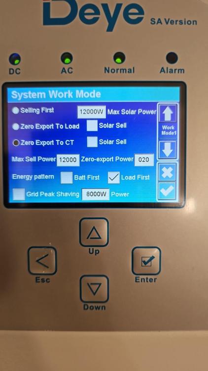

I'm sitting with a small issue that seems to be messing with the values.  I'm trying to change from Zero Export to CT to Zero Export to Load.  The reason being that I have nothing on the "non-essential" side of things.  Everything is on main backup feed of the inverter.  It goes grid -> inverter -> house.  My geysers will soon be on the "Smart Load" but that's besides the point.  When I had the single inverter for the first two weeks my values made sense and was on the Zero Export to Load setting.  Now that I've connected the second inverter and put them into Parallel it keeps jumping back to Zero Export to CT and I'm now getting negative values under very specific circumstances.
I was told by Deye Support to factory reset and I still get the same problem.  See below:

Problem Solved.  Long story short is Deye downgraded me one version and suddenly I could select Zero Export to Load.

For those interested in the firmware, this was the version I was on and Deye downgraded me from 1127 to 1126:
