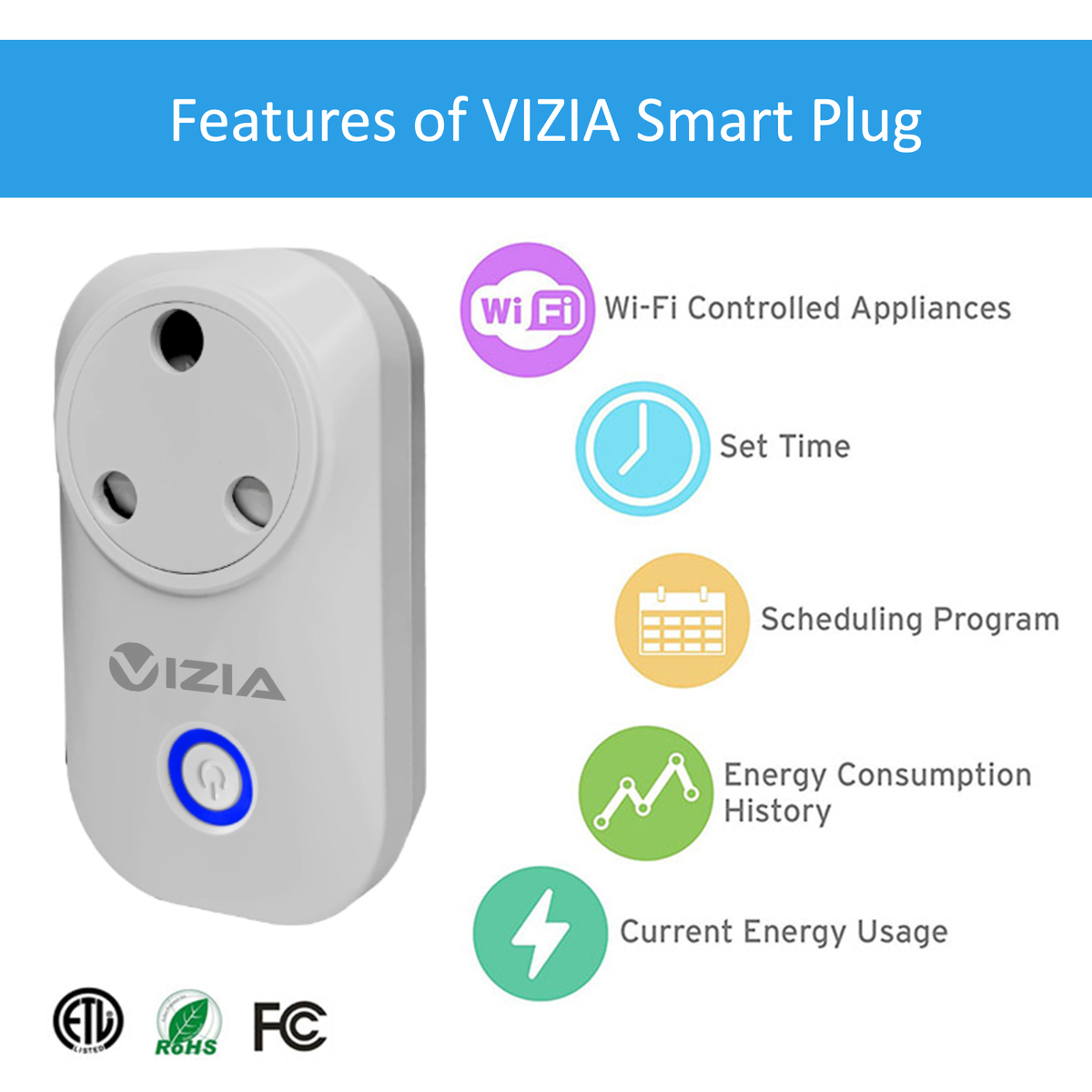

Use one of this WIFI plugs then you can control it via WIFI and is available on Takealot or Builders

55 minutes ago, PGM said:
Thanks for feedback. It seems I have no option but to get a smart plug and manage it via the app
AFAIK, the Sonoff LoadShedder as mentioned by @rkistner once setup will automatically do what you need - no need to use the app to turn off/on.
