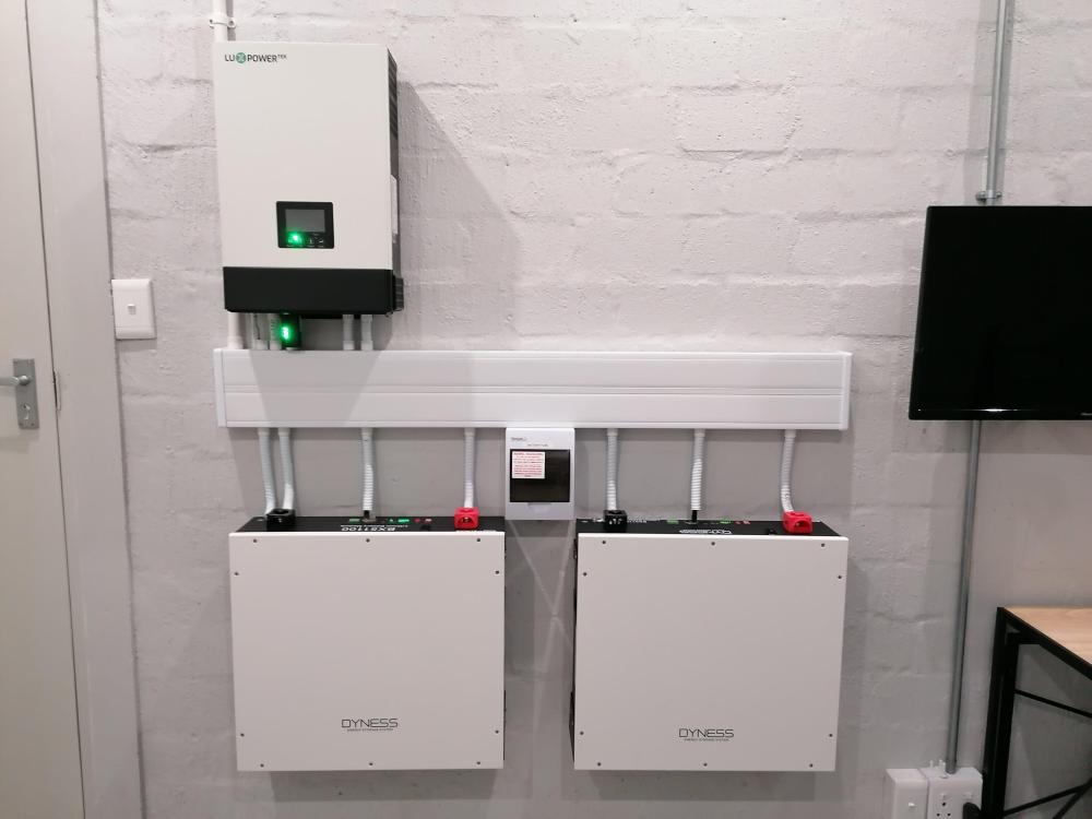

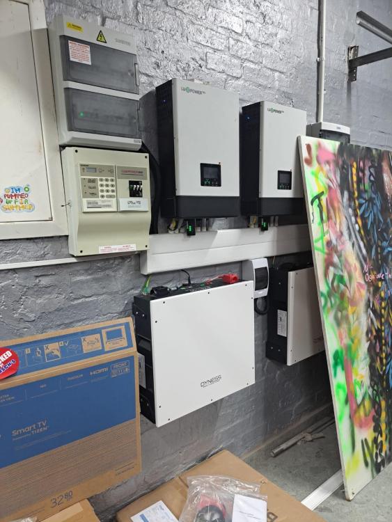

I have an SNA5000 installed at both my homes and one setup at my office with Dyness batteries.
Very happy with them they have not let me down.
At one home I have 10 panels and two SNA5000 working together an honestly I could not be happier with the systems. My only recommendation on the battery side would be to go with a 1c battery and not 0.5c batteries like I have now.

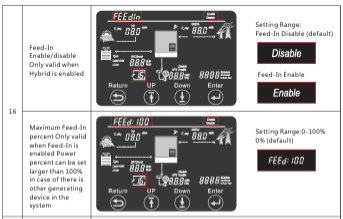

39 minutes ago, FixAMess said:
IIRC, the SNA does not have a CT coil, so you can only supply power on the essential side, from 1 AC output . To supply power to the entire house, essential+non essential, 2 AC output (but not feedback to grid) you need a CT immediately afterthe escom meter..
AFAIK it can only export after the battery is charged and you have activated the export and what looks good is you can set the % that you want to export.

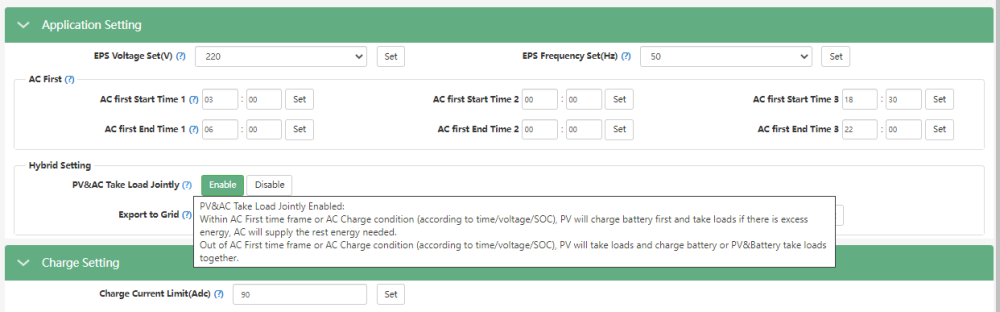

@mzezman
Just a question. When you activate AC and PV to power the load as per your picture. Say the battery needs a 1000W charge from the 2000W PV for the 4500W load would it not mean only 1000W will be used from PV and 3500W will come from te grid?
Link to comment
Share on other sites
@mzezman
That is my understanding - i will test this and let you know (possibly only tomorrow)
