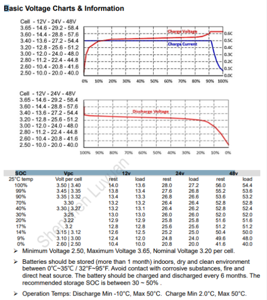

Here are the specifications for LEOCH LFePo4 15 cells batteries:
Float charge voltage: 51.75V
Bulk charge voltage: 54V. ( I set it to 52.5V)
Hi,
3.45V is very high and in some mentions even 100% resting.
Drop it a tad, you wont even notice the difference and it is a little better for your battery. If you want to have it chock and block full, take it to 3.4, or 51.00V on the 15 cell batt.
