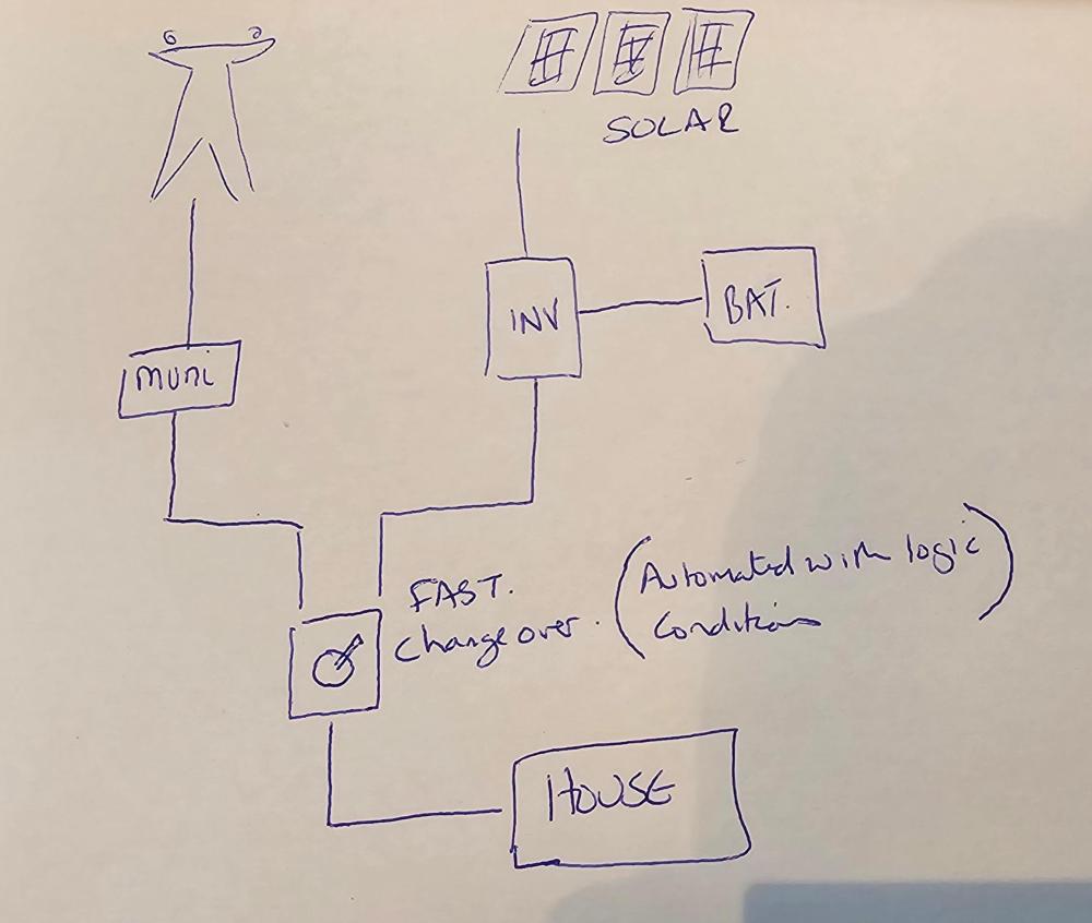

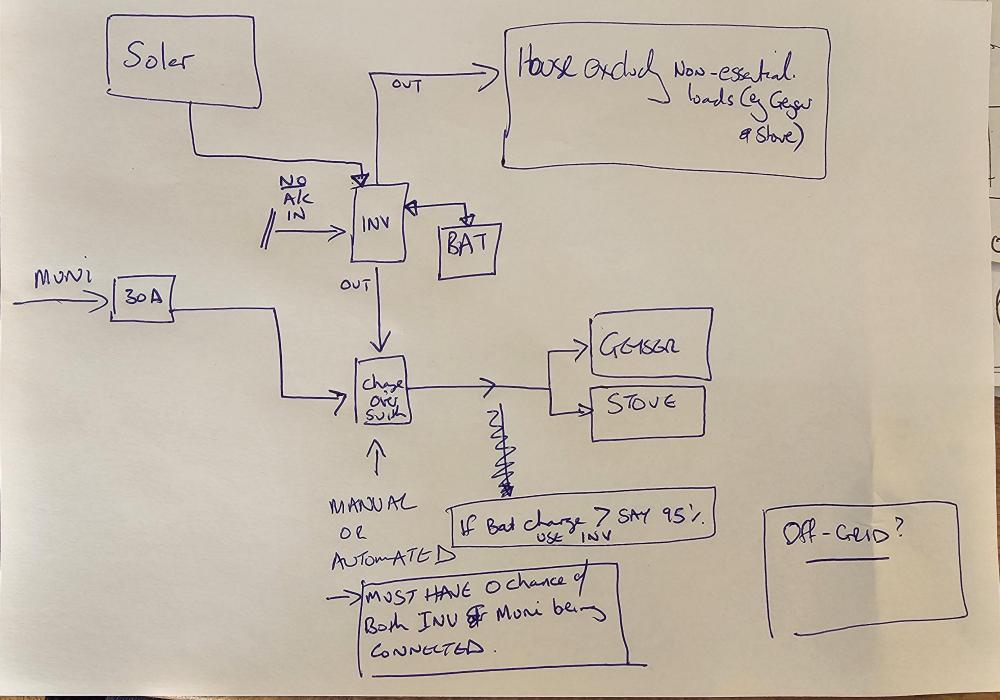

a) Does a non Grid tied system - ie totally at all times disconnected from municipal grid still need to be registed  - ie would the SSEG monthly charges still apply?
b) Assuming you go Grid tied - you have to install a TOU meter, but why does it say IBT rates apply - makes no sense TOU tarrifs should apply on any Grid draw down.
c) Cost of the TOU meter?
d) What options are there for breaker size which determins power charge - I presume either 30 or 60 Amp?
e) Is the diagram below / atatched still off-grid - has no connection between Inverter and Muni supply ...

Also note Knysna Municpality does recognise and allow off grid systems with no tarrif increase / addtional charges
So by the defination above, the strictest interpretation would be "there must be no physical conneciton between the Inverter and the Munipal Grid unless concent obtained."
Okay fine - how about this then - insert a change over switch between house and the munipal supply and inverter - see diagram below. At no time is there a conenction between the inverter and the grid. Inverter cannot charge from the grid either.  Controll the changeover switch with some home automation (eg no loadsheding allow SOC to drop to 10% before change over - with loadshedding keep a larger buffer - say 40% SOC - all depends on Battery capacity.
Register system as off grid - happy days.
3 hours ago, Tim said:
So the crux of the matter is this:
"The Municipality’s Electricity Supply By-Law and National Regulations state that, “No electrical generation equipment may be connected to the municipal electrical distribution network without the express consent of the Municipality”.
That is the correct interpretation of SANS 10142, and how it should be done anywhere in the country for a valid CoC to be issued. Just make sure your fast changeover is also compliant - I'm not aware of one that is compliant and cost effective. (They cost more than the difference between a NRS097 certified inverter and an "off-grid" inverter.)
