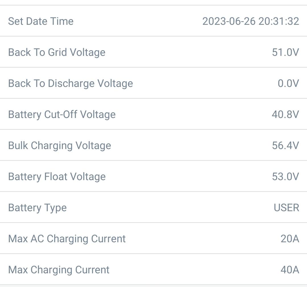

Unfortunately, such charts are not available in my Invetor. But you can see inverter settings for battery in attachment. At any battery capacity level, peak charging current never goes up to 9 A. So charging current is between 1A to 9A.
I want to know is there any charging limit setting in BMS which can be adjusted to change charging current as we do in Invertor settings?

I think your charge voltages are set too high for a 15S (48V) battery. I have a 16S (51.2V) battery and I only charge up to 56.4V to reach 100%, I think your battery might be going in to overvoltage protection when it is charging.

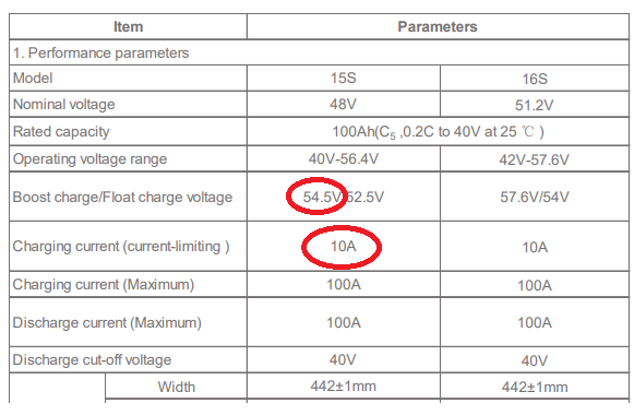

Take a look at this table from the shoto manual, I know it has 56.4V as the typical value for a 15S battery, but I use the minimum value and it charges fine. You can also see in the bottom table that the BMS will go into overvoltage protection at 54.75V which is below your bulk charge voltage.
Your float and cutoff values should be ok, but I'm not sure what a "Back to discharge" setting of 0V might be doing, you should set that to something like 52-53V.

I agree with jumper, the charge voltage on the inverter seems to high, I would recommend setting it to 54.5V as defined in the battery spec:
Then you should see the higher charge current. Also switch off and switch on the battery as it might need that before relaxing the charge current limit after going into protection mode due to the previous voltage being too high.
