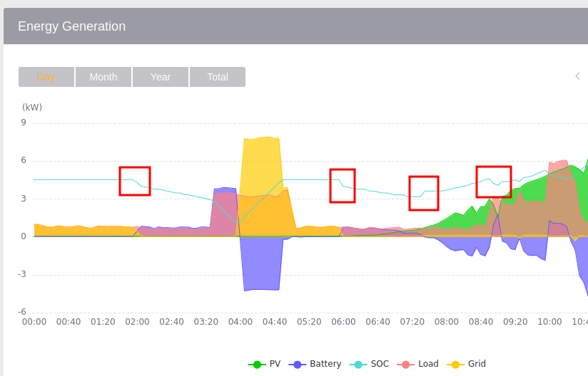

August 3, 20233 yr Author To test the theory, I changed the work mode from 8pm to 8:45pm and as expected, the spike came at 8:45pm. Here’s the “real-time” from solarman during and after. I’ve also posted the stats from the inverter at the time, I’m not sure if it helps?
August 3, 20233 yr My gut says we shouldn’t be seeing a negative value for CT1 (-886W) as this might indicate a reversed CT causing unwanted selling to grid. Can anyone with 3-phase experience confirm the above?
August 3, 20233 yr 24 minutes ago, iOddJobBob said: To test the theory, I changed the work mode from 8pm to 8:45pm and as expected, the spike came at 8:45pm. Here’s the “real-time” from solarman during and after. I’ve also posted the stats from the inverter at the time, I’m not sure if it helps? L1 power reading shows negative 886W which seems like a CT direction wrong. Further if L2 draws 10A then the power could not be only 566W. What happens if you switch the grid off just before the timer change. Edited August 3, 20233 yr by Scorp007
August 3, 20233 yr 2 minutes ago, Scorp007 said: L1 power reading shows negative 886W which seems like a CT direction wrong. What happens if you switch the grid off just before the timer change. Yes, that reading looks odd. @iOddJobBob is it possible to check the directions on the arrows on the CT coils and the way they are connected in inverter?
August 3, 20233 yr 17 minutes ago, PowerUser said: Yes, that reading looks odd. @iOddJobBob is it possible to check the directions on the arrows on the CT coils and the way they are connected in inverter? Without checking the CT2 just reverse the 2 wires in the inverter.
August 4, 20233 yr Author @Scorp007 if I switch off mains while the drain is happening, it stops and functions normally. @PowerUser firmware is ver2005-1128-1807 excuse my ignorance, but which ones are the CT coils? 🙈

August 4, 20233 yr 5 hours ago, iOddJobBob said: Thanks. This helps. I’ll have a look when home this evening 5 hours ago, Scorp007 said: Is our problem not CT1 (since that's where we're seeing the big negative in the Solarman screenshots)? Or do the small trickle-sized negatives on the inverter display indicate a problem with that coil, i.e. CT2 instead? I run single-phase so I'm not entirely sure myself; just asking to be safe. It looks like we've found our phantom load!!! Edited August 4, 20233 yr by JayMardern
August 4, 20233 yr Author 1 hour ago, JayMardern said: Is our problem not CT1 (since that's where we're seeing the big negative in the Solarman screenshots)? Or do the small trickle-sized negatives on the inverter display indicate a problem with that coil, i.e. CT2 instead? I run single-phase so I'm not entirely sure myself; just asking to be safe. It looks like we've found our phantom load!!! I'm a complete noob here, so will take advice from the experts
August 5, 20233 yr Author I opened the DB and can’t tell which direction the CT coils are going and don’t feel comfortable enough to start fiddling around. opening the inverter though is easy enough. Should I be looking at changing the wires for CT1 or CT2?

August 5, 20233 yr On 2023/08/02 at 8:55 PM, iOddJobBob said: The confusing bit for me is the massive drain that correlates with the change in work mode times and then the subsequent stabilisation at much lower consumption. Shouldn’t the discharge be more gradual? The SOC overlay shows an immediate drop - within minutes - from 55 to 40 at 6am and similarly the drop to 70 at 8pm. If I were to change to time of use to any other time, the same pattern is observed. I’ve got 2 Hubble 5.5Kw batteries I want to offer another possible explanation. Please check the SOC on the batteries individually. My experience is that if the one pack has a different SOC than the other one, the master battery will report the highest SOC to the inverter when charging, and when discharging, it will report the lowest SOC of the packs (This is a PACE BMS, so not sure what the Hubble does). So if its stable for long when maintaining e.g. 70% (highest of the two batteries) and it suddenly starts discharging then drops to e.g.60%, which is the SOC of the other battery. I also notice it when charging. If this is the case you need to investigate why the one battery loses charge faster. Mine is not quite as dramatic, but I notice 3-5% drop sometimes. Edited August 5, 20233 yr by gimme_power
August 5, 20233 yr Author 26 minutes ago, Scorp007 said: We did point out there was a strange reading on ph1 as well as ph2. See how it goes. Will try and see how it goes. Otherwise I’ll be calling the installer. There’s only so much I’m willing to experiment 😁
August 5, 20233 yr 6 hours ago, gimme_power said: I want to offer another possible explanation. Please check the SOC on the batteries individually. My experience is that if the one pack has a different SOC than the other one, the master battery will report the highest SOC to the inverter when charging, and when discharging, it will report the lowest SOC of the packs (This is a PACE BMS, so not sure what the Hubble does). So if its stable for long when maintaining e.g. 70% (highest of the two batteries) and it suddenly starts discharging then drops to e.g.60%, which is the SOC of the other battery. I also notice it when charging. If this is the case you need to investigate why the one battery loses charge faster. Mine is not quite as dramatic, but I notice 3-5% drop sometimes. In this case we’re seeing quite big negative CT readings (nearly 1kW); it definitely looks like an unwanted export to grid. The Sunsynk manual describes this as a sign that a CT is reversed. 6 hours ago, iOddJobBob said: Will try and see how it goes. Otherwise I’ll be calling the installer. There’s only so much I’m willing to experiment 😁 Yeah regardless of anything else, this is an installation or (less likely) hardware issue; if you don’t come right call in the cavalry. Let us know what happens once you’re sorted!
August 5, 20233 yr 1 hour ago, JayMardern said: In this case we’re seeing quite big negative CT readings (nearly 1kW); it definitely looks like an unwanted export to grid. The Sunsynk manual describes this as a sign that a CT is reversed. 1000W draw for a short time is not enough to reduce SOC by 10%-15%. What is the duration of those spikes of unwanted export to the grid?
August 5, 20233 yr Author Just now, gimme_power said: 1000W draw for a short time is not enough to reduce SOC by 10%-15%. What is the duration of those spikes of unwanted export to the grid? About 10 minutes. As long as it takes to get to new SOC
August 5, 20233 yr 1000W for 10mins equals 3% SOC of one 100Ah battery, so not quite going to get to a 10% drop in SOC of the combined bank. Have you checked the individual SOC of the two batteries, do they differ and by how much? Or are we talking about a 10kW draw? Edited August 5, 20233 yr by gimme_power
