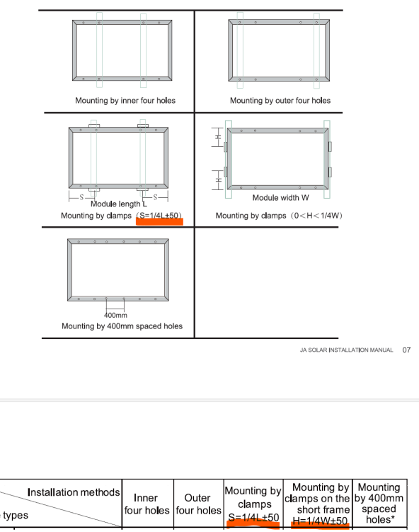

August 10, 20233 yr In regards of reusing the old mounting hardware, most likely you can re-use it but it will depend on the current panels mounting method and size, compared to the new panels. Take a look below at the different mounting methods for JA Solar, if you are using clamps, the allowed deviation is +/-50mm from 1/4 of the Length or Height of the panel. With different panel sizes the rails will have to be re-positioned. Edited August 10, 20233 yr by PowerUser

August 10, 20233 yr Author 29 minutes ago, PowerUser said: In regards of reusing the old mounting hardware, most likely you can re-use it but it will depend on the current panels mounting method and size, compared to the new panels. Take a look below at the different mounting methods for JA Solar, if you are using clamps, the allowed deviation is +/-50mm from 1/4 of the Length or Height of the panel. With different panel sizes the rails will have to be re-positioned. Thanks. There's clearly more to this panel mounting business than I'd thought.
