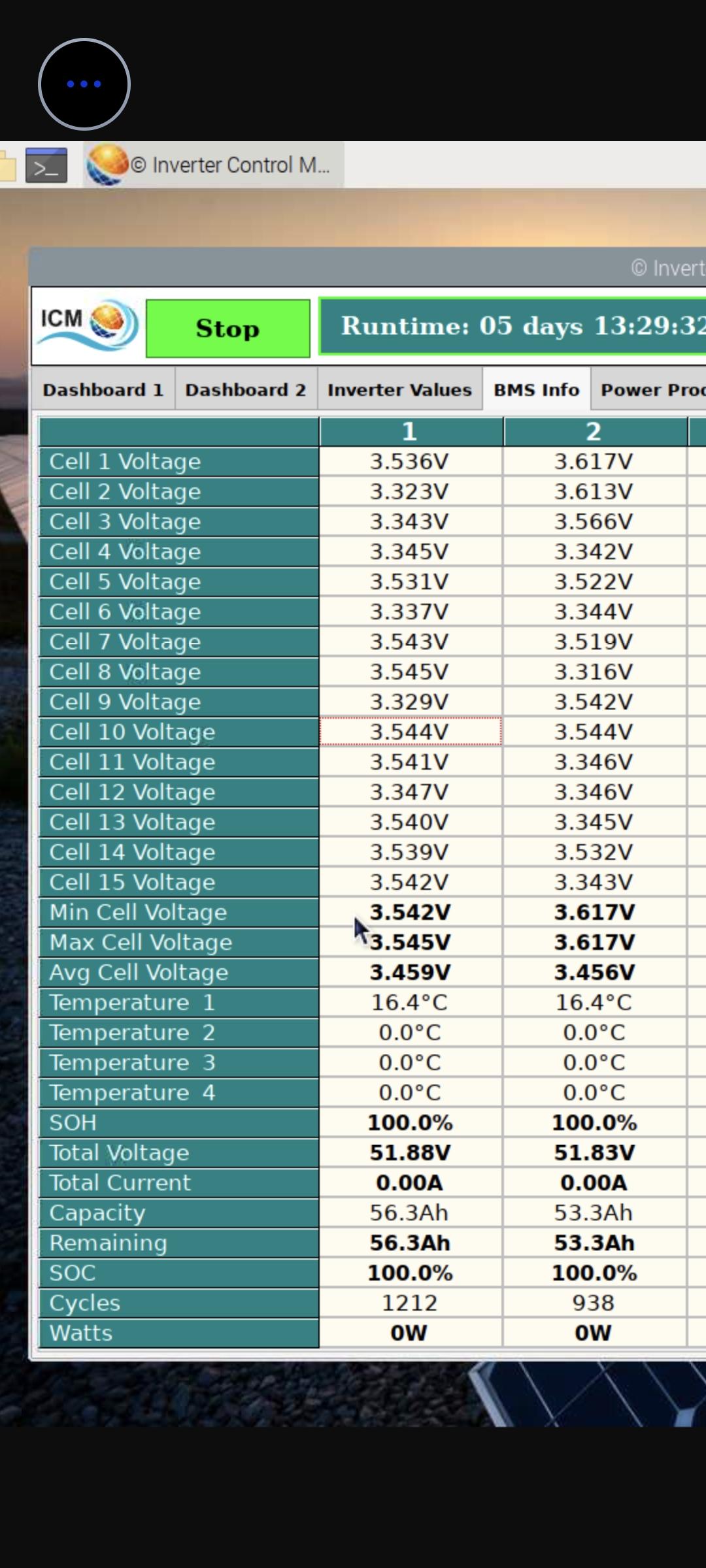

August 10, 20233 yr Hi all, if my Narada 48v 15s 100aH battery has mixed capacity cell's, what would the symptoms be? The bms shows the SOH as 100%, but capacity shows 53.8 ah. Looking at the cell voltages, there is a definite difference between some cells. At 100% charged, at +- 51.8 v, some cell's voltage is about 3.6v, while others is below 3.4v. As soon as I make the float voltage 51.9 or 51.2, 2 of the cell's go above 3.65v. I first thought the cell's is totally unbalanced, but now I think that there is a capacity difference between cell's. Both my batteries was installed in 2019, but only resently I got software where I can read the bms. I also noticed that the batteries was opened before as some of the screws is damaged. So the installer installed 2'nd hand batteries I believe! I am planning to strip the batteries to test all the cell's and top balance them next month. Has anybody got some idea's? I tried for about 3 weeks to keep batteries fully charged, but no change. I have 2 batteries connected in parallel, connected to 2 inverters connected in parallel.

August 10, 20233 yr 4 hours ago, Oros said: Hi all, if my Narada 48v 15s 100aH battery has mixed capacity cell's, what would the symptoms be? The bms shows the SOH as 100%, but capacity shows 53.8 ah. Looking at the cell voltages, there is a definite difference between some cells. At 100% charged, at +- 51.8 v, some cell's voltage is about 3.6v, while others is below 3.4v. As soon as I make the float voltage 51.9 or 51.2, 2 of the cell's go above 3.65v. I first thought the cell's is totally unbalanced, but now I think that there is a capacity difference between cell's. Both my batteries was installed in 2019, but only resently I got software where I can read the bms. I also noticed that the batteries was opened before as some of the screws is damaged. So the installer installed 2'nd hand batteries I believe! I am planning to strip the batteries to test all the cell's and top balance them next month. Has anybody got some idea's? I tried for about 3 weeks to keep batteries fully charged, but no change. I have 2 batteries connected in parallel, connected to 2 inverters connected in parallel. How can you have a reading of 3.323V yet the BMS gives the minimum value 3.543V for the lowest cell.

August 10, 20233 yr First thing is to open it up. See if you can find a qr code that you can scan to show you the manufacturer and the capacity of the cells. Also, noted by @Scorp007. There is something wrong with that readout. Minimum voltage is higher than voltage of cell no2, and many other cells. Not sure what is going on there

August 11, 20233 yr Author 7 hours ago, gimme_power said: First thing is to open it up. See if you can find a qr code that you can scan to show you the manufacturer and the capacity of the cells. Also, noted by @Scorp007. There is something wrong with that readout. Minimum voltage is higher than voltage of cell no2, and many other cells. Not sure what is going on there Yep, i think the only solution is to strip the batteries and the check all the cells and connections. As with the reading, I'm also thinking of later to replace the bms. The Narada bms is not user friendly!! But, ja, as soon as i strip them i'll know. I'm also thinking of removing the comms between the 2 batteries. As some cells on number 2 reaches 3.65, then charging on both stop. So no.1 does not fully charge. I first need to get another comms cable to be able to monitor both.
August 11, 20233 yr 12 hours ago, Scorp007 said: How can you have a reading of 3.323V yet the BMS gives the minimum value 3.543V for the lowest cell. I keep seeing this with this ICM software, I think it is a problem with the display of the values, but I don't know if it affects the balancing or not. It's a little disconcerting that so many people use this software and there is still such a blatant error.
