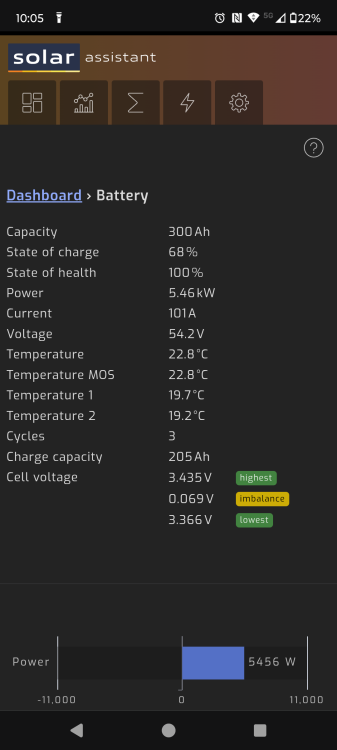

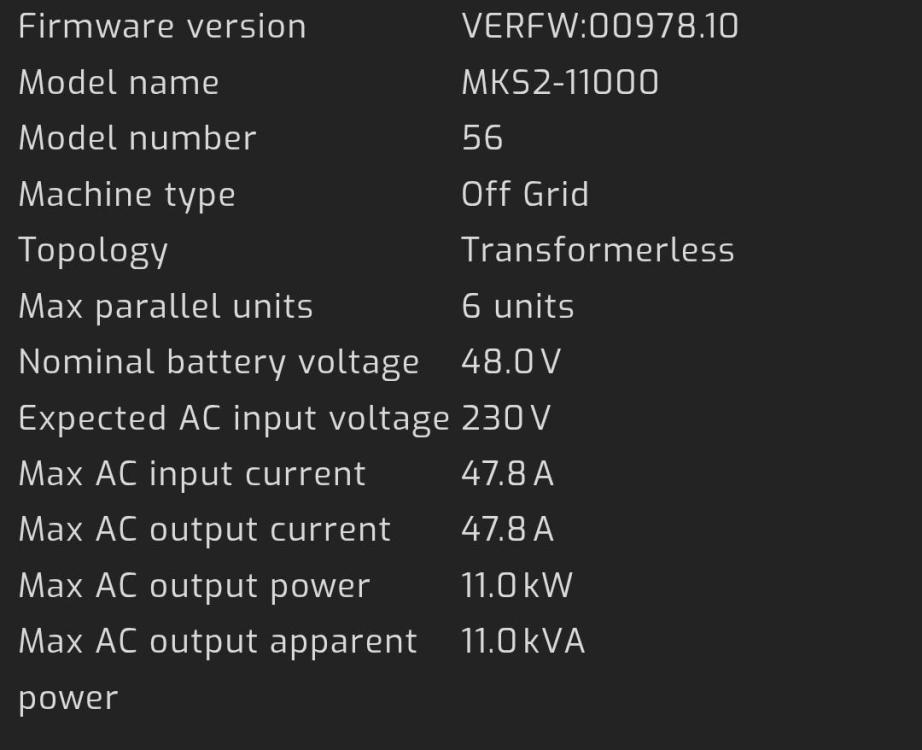

    Here is my comparison between 978.11 (still stuck at 90V) and 378.11 Before: After: Similiar full sunny morning, same time, same configuration. Change was only FW and looks much better
  • It won't update, just as your mismatched 8 kW didn't update. It's sad that some resellers don't know about the different DSPs. However, the difference between '28066 and '2809 firmware is ju
  • Check out this thread, you seem to have the same problem. Try turning on sbu mode, does the power increase?

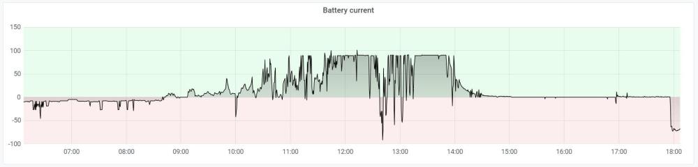

Hello, greetings and many thanks for the efforts. I have easun swm 11kw twin with detachable display, I have flashed 978.10 from the above post over original 78.10 firmware, but I still have charging limited to 100A.
Any ideas?
Thanks, regards.
EDIT:
I think that could be because my grid voltage is extremely high (253-257v) and if I read correctly >250v is a derating condition while my inverter temperature is around 47-50*C.
If I turn off the grid, it goes to 115-120A for a short while, and then capped to 100A again.
Is 0v grid also a derating event?
Regards
That would seem to indicate that the patch is working.
I would not think so. At a quick glance, I don't see any derating related to line voltage.
Is it possible that you don't have more than about 5 kW of PV power (100 A at ≈50 V battery) available at this time of year?
Is the 115-120 A charging repeatable?

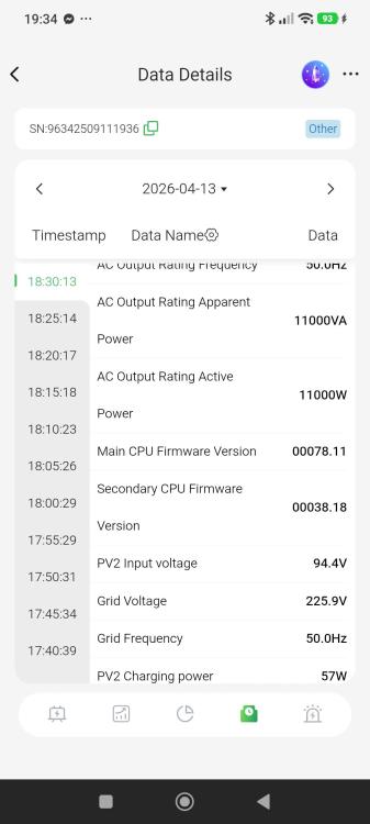

Hi,
sorry for silly question. I am newby here.
If i have Axpert iSolar SMW 11kW TWIN (U1 78.08 + U2 38.18) can i update with patched 78.11 (978.11)? No EEPROM mismatch issue?
Thanks in advance for advice.
Edited by bruno1975

For info: Axpert iSolar SMW 11kW TWIN (U1 78.08 + U2 38.18) and trying to update with patched 78.11 (978.11) from @Coulomb
Any idea what to do? At second laptop, i did not install Watchpower to eliminate issue with COM port occupation by WP. Trying also different COM port (COM1, COM3, COM5) aways same output.
