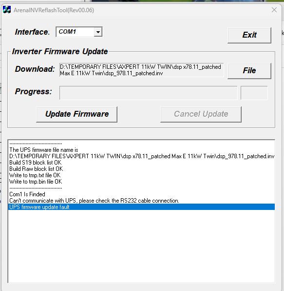

Hi. Now i have the firmware for 11k twin 28066, can u check and modify it ? Thanks.
MAXE11K_TWIN_DSP_7807.7z
how i can flash ?
Try the below. I wrote this some weeks ago, but I can't find it on this forum, so perhaps I forgot to upload it. Sigh.
This is patched firmware version 964.62. ...
Deleted as it is now obsoleted by the above. I was literally 10 minutes late... sigh.
Wow. I had just posted a hacked 64.62 for you to try. Thanks for the 78.xx firmware; it's the first I've seen.
I will check soon; I have errands to run now. Checking '28066 firmwares is harder for technical reasons.
I'll try and patch it soonish, but work is piling up at present.
I would like if u can check rhe 78.xx and patch it....it will work i think
On 2023/09/11 at 7:58 PM, add1c7ed55 said:
I would like if u can check the 78.xx and patch it....
This firmware update (with version 78.07) is indeed Axpert MAX E 11kW Twin '28066 main firmware; it should work for your inverter.

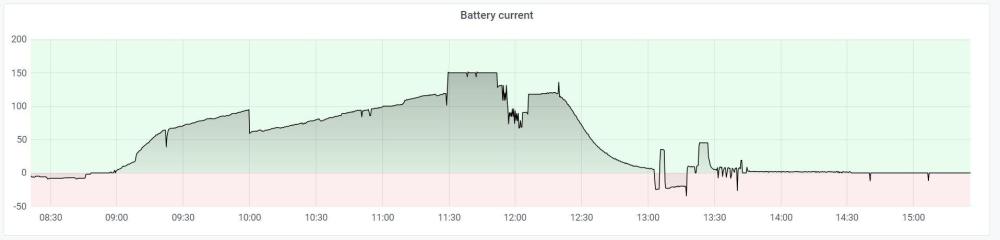

I have the following problem with Axpert Max 2 11kw Twin:
Sometimes the battery charge does not exceed 90A even though the setting is 150A.
This poses a problem when the day is cloudy, because during clearing the charge is not maximum, so there is "lost" energy.
Do you have this problem with yours?
Sometimes by playing with the AC load for example by activating the water heater then turning it off or other consumer devices this clears the blockage at 90 amps
This is what I did in the example below
