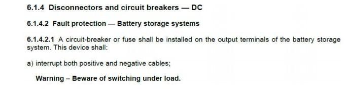

Many thanks for the explanations above. Could anyone share where in SANS it says we need a battery fuse for each battery.
Interpret below as all pos and negs needs to be disconnected.
Screenshot_20230915_065234_Microsoft365(Office).jpg.402a09188f61062c5ec6dd2a325baa56.jpg
