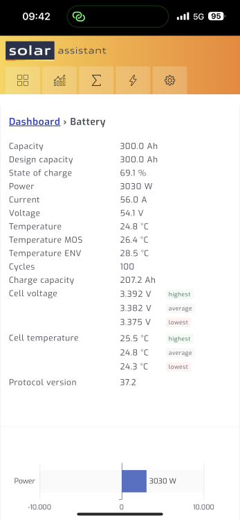

I have the 15kWh BSL Powerwall now for the past 4months…just hit a 100 cycles. Have not had any issues. Just my 2cents from a user perspective…I’m sure the installers on here will provide better input 🙂
Edited by Carl Anthony

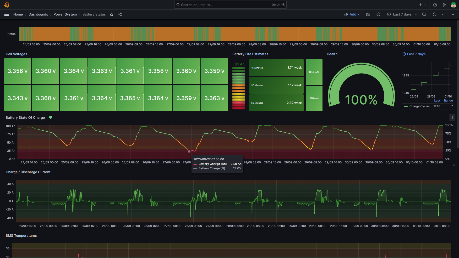

 The Sunsynk module consists of Lithium ferro phosphate rechargeable cells with 5.32kWh capacity rated at 51.2V 100Ah with a built-in battery management system. Just be careful of the fine print in the 10 year extended warranty that states the maximum cycle per year is 750cycles is it possible with SA load shedding especially when on stage 6.
That depends on how the BMS count is set, I have a LBSA battery that counts 1 cycle every time SOC goes bellow 80%. I very seldom use my battery bellow 20% SOC yet it shows 1 cycle every single day see attached, in the last seven days only once gone to 22% soc yet it counted a cycle every single day.
