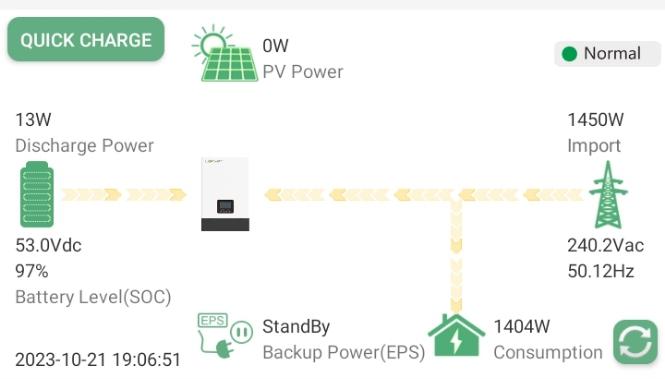

First image is luxpower .

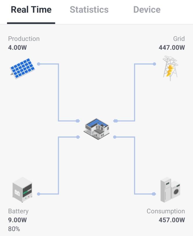

Second image is deye

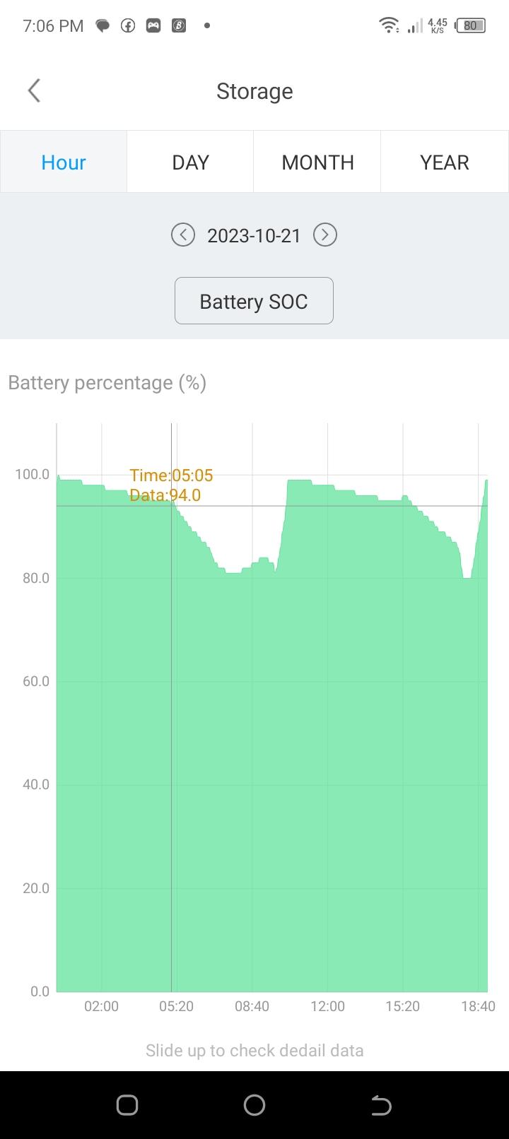

And lost is growatt and as you can see growatt has the highest consumption with about 6% battery used at night lithium is an Hubble am-2 5.5kw
