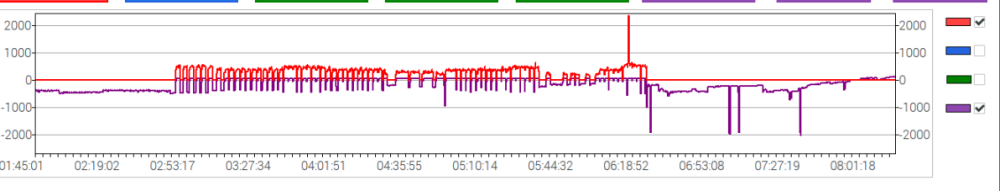

I was wondering if anyone would have some advice on a behaviour change I started experiancing on my inverter.
As stated I have one of those Axpert TheSunpays 4kw inverters and it has been running no issue for the last year (perhaps a little longer).
4 Months ago I got 6 * 550W Jasolar panels and connected them up.
Now typical behavour was that if the battery was below 100 % and the inverter was running in Grid mode, the solar would charge the battery. (usefull for those cloudy day, where you can put some sun to use)
3 days ago this stopped, now it will only pull current from the MPPT when the inverter is running on SUB or SBU modes.
Could something have broken in the inverter that it will no longer charge the battery while running in Grid mode?
Any advice would be welcome.
Thjs seems wehrd as the PV charging if selected to be used will at all times charge the battery is it is not at the levels to stop charging. This takes place even if the inverter is switched off.
The same applies if grid charge is allowed and there is no PV the grid will also charge if present even if the inverter is off.
Yep that's the exact model :)
It's also switching between grid and battery mode when the battery get's below 50%. Neither of these are severe enought to replace the inverter just annoying.
