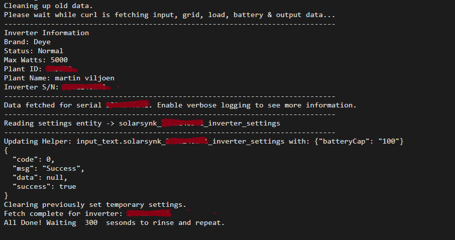

Hi , The reason for creating the helper is so that you have a place to store and tell the addon which settings you want to send to the inverter.
If you set the helper to JSON {"batteryCap": "100"} it will update the settings and set the battery capacity to 100
After it reads the value of the helper it will then clear it out so that on the next loop it will not send the setting again.
Typically you have some automation which gets triggered based on certain conditions which will then set the value that you want to send to the inverter.
Be warned though, HA helper values have a character limit and many settings cannot just be sent on their own it needs to be sent with other settings else it will simply not be applied. In some cases this exceeds the character limit of the helper which then makes it impossible to update some settings.
Example of some settings I just sent.
