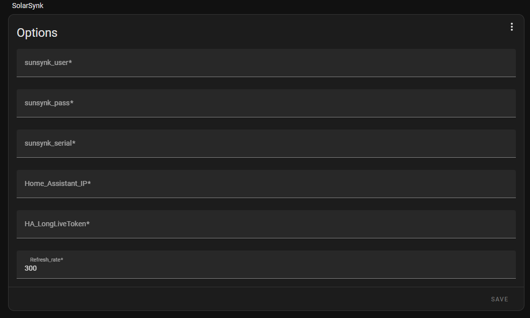

  • Giving it a go quickly. Worked well and recommend for someone not wanting to go through the whole node red process.
Am I correct that the add on only refreshes every 5 minutes @MartinViljoen?
If so is there any chance of having it refresh as per the setting we have set through Sunsynk like I have mine every 60 seconds?
Thinking of using your add on as my main add on instead of node red or have node red as a back up but would appreciate if the refresh could be a bit shorter.
Sure.
Its a quick change. I updated it for you. The update rate is in seconds.
Just be aware if you set the refresh rate faster than what your dongle is updating SunSynk is a pointless exercise and you will most probably just fetch the same values over and over unstill SunSynk was updated. May be a wase of disk space.
I'm not sure at what rate its being updated. Some say 3 minutes and some say 5.
[EDIT] I see you mentioned that you are able to set the update rate on Sunsynk ? , Didnt know you can do that. Is it set in the portal or when you setup the dongle ? I unfortunately cannot change settings my installer locked me out, still fighting to get full rights.
But the setting is there now 😉

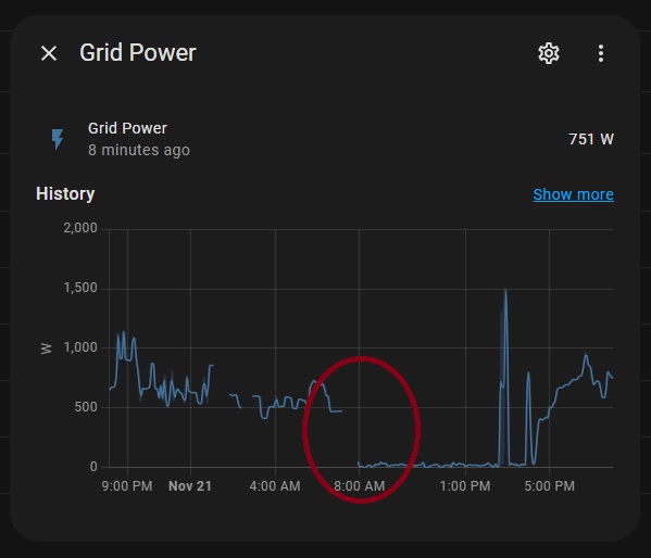

I made a major change to this add-on which resulted to a change in the entity names. Therefore I copied it over to a new repository and versioned it v2.
The new version supports multiple inverters. If you install this one you have to re-map the entities which are now prefixed with the inverter's serial number.
New Repository -> https://github.com/martinville/solarsynkv2
The previous one is still available here -> https://github.com/martinville/solarsynk but will not longer be updated.
Be aware the previous version has a bug that causes breaks in HA graphs due to null values. I.E When the grid disappears.

Version: "2.1.3" - Bug Fix: Breaks in graphs are caused by null values. All nulls are converted to zero.

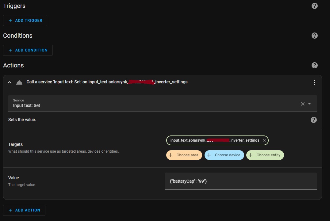

I made some further changes.
  • Added support for people who has a signed SSL certificate attached to their HA installation. Previously it was hard coded to post values to entities using straight HTTP.
  • Added the ability to change the port number in the setup.
  • Added an option to reduce the log output but with the option to still dump using verbose mode.
  • Changed the password and HA long-lived token field to be masked
The following is coming soon.

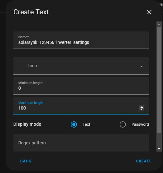

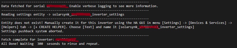

I also added the ability to change inverter settings. Right now on my test environment its working great.
It works by setting the value of an entity to the setting you want to update. I.E If you set the value of entity
sensor.solarsynk_INVERTERSERIAL_inverter_settings
with value
{"batteryCap": "100"}
or
{"batteryCap": "99","facHighProtect": "51.5"}
Example
The Solarsynk addon will grab it and post to the Sunsynk cloud which wil eventually be sent back to your inverter. After successfully posting it it will clear it out the entity so that it wont send it over and over.
Only problem is i'm not so familiar with HA and cannot find a way to change the state of an entity via automation. Therefore the version that allows you to change settings is not yet available. Once I find a solution I will offcoarse make it available on the repository.
Cheers

Update 2.1.8 now available. https://github.com/martinville/solarsynkv2
This update lets you send  inverter settings back to your inverter via HA -> SunsynkCloud -> Your inverter
If you start the new updated add-on for the first time you will get the below message in the log, notifying you that it cannot find an helper entity.
Manually create it as shown below. (You have to do this for all inverters if you are using multiple)
After you created the Helper entity which ever value you set it to will be used to send to the Sunsynk.net cloud. There's no error checking in the value so if you just add junk the synsynk API will simply reject it with an error. As mentioned in the previous post a valid entry would be something like this. And also see the long list of possible settings that you can change.
If you want to change settings using automation that are based an certain variables I.E loadshedding statuses ect ect you can add an action to your automation as shown below.
Note!: The string you enter into the helper entity will only be read once the script loop based on the refresh rate that you entered. (Default is 300 secs)
If you find issues with this let me know.

I've been using this for a few weeks now, seems very good.
Couple of things I've noticed:
After a reboot/update Entities seem to disappear from HA, but come back after a few minutes.
I have a flow set up to tell me when the battery is full
if battery SOC >=100 for 5 minutes then notify
Over the last few days I've found it got triggered a lot.
I assumed maybe something was using enough battery to pull it down to 99% then it goes back up to 100 and triggers another notification.
However, looking in HA I see there are gaps in the data. This seems to have started a few days ago.
Any ideas what is going on with that?
image.png.c39684877060bc1b0125aeacf8bae72e.pngimage.png.f5c34d82156f042409610698c050cec6.png
Hi, yes Sunsynk made allot of changes over the last month or so which resulted in some downtime. Also their new certificate which was renewed on the 13th of march has strange behavior. Curl would randomly not be able to verify the validity of their SSL certificate.
When the addon cannot retrieve a valid API token due to the above errors it continues to try an populate values which then causes error on error.
I made a few changes.
1. When there are connection errors or certificate errors It will exit to the end of the loop but not exit the loop. This will prevent the gaps you see in the above graph and keep on trying until it get's valid data. This also means any cards you have will keep showing the last value it retrieved until the problem resolves it self.
2. I unfortunately had to add the -k option to curl so that it will not validate the certificate. I don't know what's up with their certificate but something isn't right.
Perhaps they have some load balancing across multiple IPs  and their config is not quite setup correctly for SSL validation.
3. If there is an error, it will dump a very detailed reason for the error using the  curl verbose option.
The update is anow available. Most if not all the issues should now be resolved.
